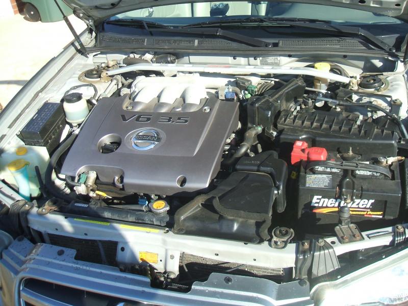

I woke up early this morning, (6 am) and carefully removed the stock airbox and all its associated parts. I wanted a Fujita but of course they don't make one for the 5.5's so on the advice of a fellow orger I bought a COSMO CAI. I took my time assembling it and ensuring that I didn't damage the air mass sensor or scratch the blue painted tubing that I chose to get.
After about 3hrs I was done. I took it for a quick test run down the block and the sound and feel is amazing. The car now has a more pronounced growl if I lay into it, and under the hood looks a lot less cluttered without that big black blob the stock airbox was. I know times are hard, but if you can scrape up $140 I definitely recommend getting a COSMO or some other aftermarket ram air or cold air intake.
I got mine for the slight hp gain and sound it produced, but the look under the hood, (at least to me) is just an added bonus.
Here are the pictures, the first is a before shot. the 2nd is a straight on and the 3rd is from the right side. Now that I have more room under the hood I have more things to clean and shine as well.

Looks like it moves the filter out of the way of the cooling fans-appears to be under the battery?
Old Mar 7, 2009 | 05:49 PM
SteveB123's Avatar
Joined: Nov 2008
Posts: 1,023
From: Ottawa Ontario
Yes.

Damn 3hrs is a long time. Congrats though, it looks like an Injen. The blue kinda sticks out though. Thats a quick fix. All you gotta do is paint a few more things in the engine bay blue and you'll be good.
Old Mar 7, 2009 | 07:54 PM
Maxgig's Avatar
Joined: Apr 2005
Posts: 1,727
From: Missouri
The actual install took about 2.5 hrs, I made sure that I labelled the stock airbox in case I want to put it back in. I also found myself cleaning up the hoses and wires that were under the stock box as well. As for the color I wanted something under the hood other than chrome. I'm gonna get the engine cover airbrushed to match my r/c cars that I race.
Old Mar 7, 2009 | 07:56 PM
Revs2Hard's Avatar
BARF
Joined: Sep 2006
Posts: 750
From: RightWheelDrive
This intake is just like the injen's and that one sucks. I use to have a injen intake and your going to find out what I did. Where that intake bolts to your block its going to transfer a ton of heat and warm your intake. Also being in between the block and battery its like a little intake toaster oven. Its going to only do you good on super cold days. I ran a Track day and it was 102 degree's. My car started to sputter and acted like it wanted to shut down. I pulled into the pits and the intake tube was so hot I couldnt touch it. So we hit it with a laser heat temp gun and it was 181 degrees. My choice of words when I seen that would get me banned off this site so I will keep um to myself. I ended up taking off the lower tube and cutting it to run out the side like a berk for the day. I went home and took it off immediately. I hate to say it but you need to take it back off and go get a frankincar or berk intake.
It dose look nice though :-)
Old Mar 7, 2009 | 08:18 PM
Maxgig's Avatar
Joined: Apr 2005
Posts: 1,727
From: Missouri
Revs2hard, I didn't attach mine to the bolt on the side of the engine. Another orger gave me a heads up on the heat transfer issue. I adjusted fire and twisted my tubing so it sits closer to the battery. If it still gets warmer than usual I have some high heat resistant insulation that I can cut and position between the engine and the down tubing.
