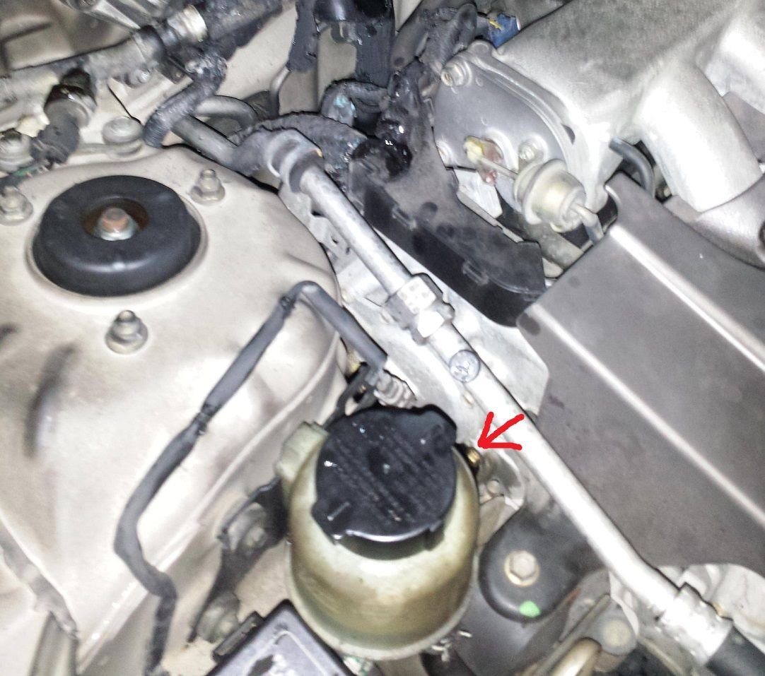

Yes, the VQ30DE has an access port to inspect the tensioner and you should be able to see the guide using a mirror.
Just to be able to check it, you'll likely need to remove the side motor mount and power steering reservoir. It's really close to the frame rail and those 2 are right in the way.
Also, there's no gasket, so make sure you've got some RTV to reseal the panel.
Sorry for the 5-second MS Paint edit, but the green shows where the PS Return Line runs pretty much right in front of the panel making it near impossible without removing/moving the hose/reservoir to access the panel.
Yet again, another bad picture but it's a great angle to show you how the mount and reservoir are in the way. Sorry. It's a VQ35, but the panel is in almost exactly the same position. You can see it peeking the top right corner bolt out behind the motor mount and the reservoir.
