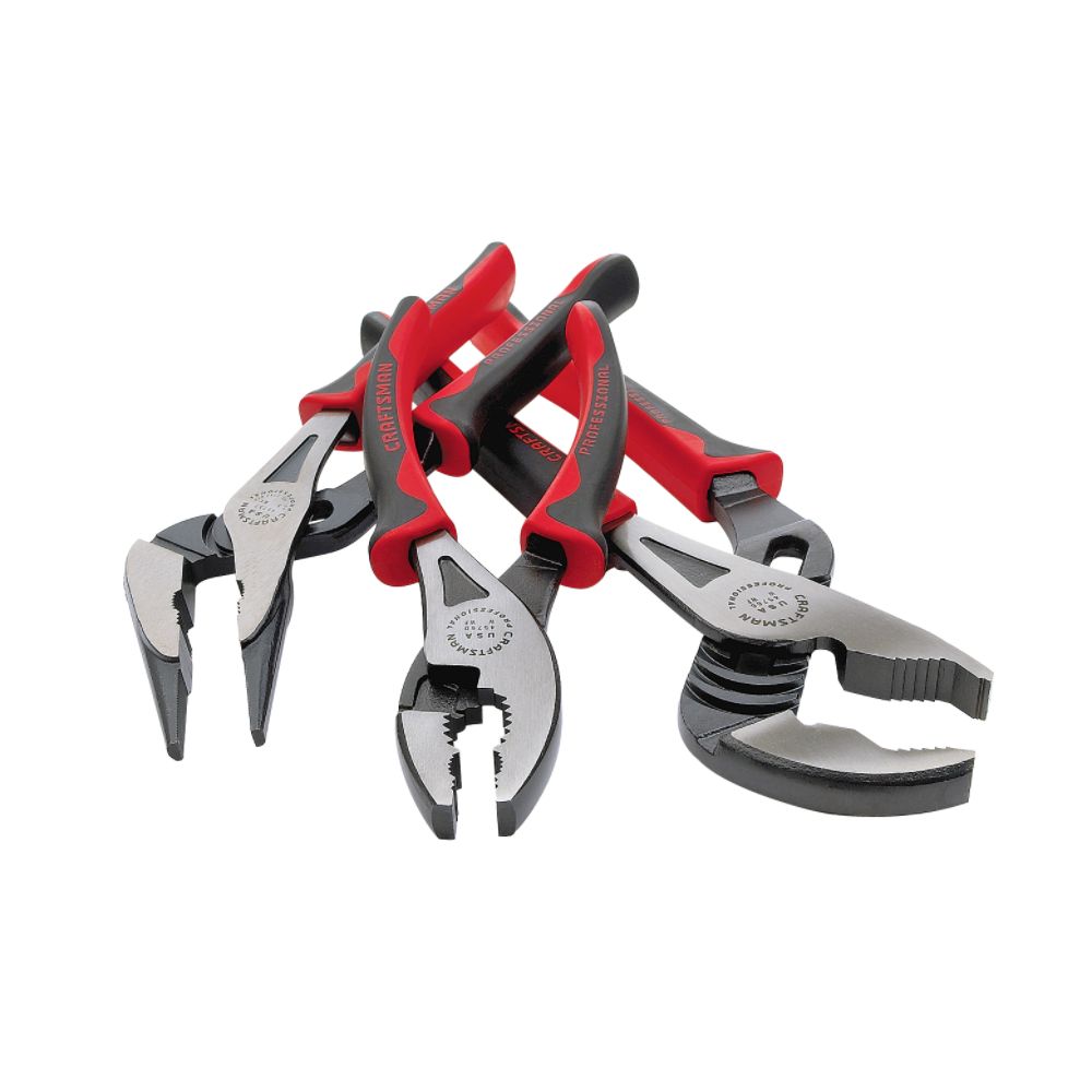

5 minutes after i made that post, i found the perfect tool. haha. i actually used a pair of needle nosed pliers and a pair of normal craftsman pliers that had kind of a round opening half way down. i pulled and bam, came right out. busted two, saved two. not bad.
also a note for future installers, there are four little tabs inside of the base. use like a small knife to bend those in to create a snug fit for the LED. also, there are two bent metal tabs coming out of the sides of the base. make sure they are making contact with the circuit board.
So happy with my Cool White LEDs
Thats the tool i used, in the middle. The rounded opening was perfect. used another pair of pliers to hold the base and pulled straight out!
