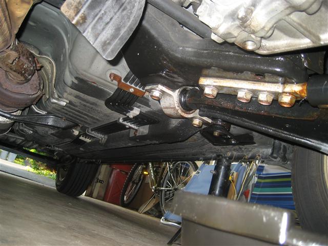

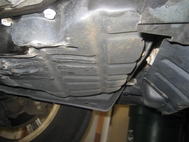

While on my commute today, I had the misfortune of running over a friggin' car battery that was in the middle of my lane. No where to go and no time to stop;
was able to slow down a bit but I still ran it over. Pulled over and saw a dent and skuff mark on the AT pan but it looked dry. When I went out for lunch later there was a puddle of ATF under my car. The fluid was still above the add mark on the dipstick, and that's after driving about 50 miles and sitting parked for 5 hours or so. Have a few extra qts of ATF in the trunk so I should be able to limp home. Hoping its just the pan and not a cracked torque converter/transmission case.
(Not looking for any pity here but it was just weird to see a whole car battery in the middle of the road.)
UPDATE 12-Jul, 20:00: Added a few pics. The trans pan took the whole brunt of the hit. The pics don's show it very well but the pan is bowed-in about 2". The white stuff on the L side (front view) is probably where one of the Lead terminal posts hit. Looks like the impact broke the seal between the pan and case. It's a pretty slow drip. Lost about 0.5 qt of ATF over 110 mi and about 11 hrs. Good news is that the tranny/torque converter case looks intact. Didn't see any damage to the rest of the undercarriage either.
Picked up a new pan and gasket for $45. Will reuse bolts and torque them per FSM. Will also use RTV on both sides of gasket and bolt threads to ensure zero leaks.
homeyclaus - good point about the undercarriage getting doused with battery acid. I did hose it off. Owning a Nissan product in the NE is bad enough for getting rust. Don't want to speed up the process!!

I was impressed on how beefy the pan is when I picked up the new one. Considering the forces involved, the orig pan held up pretty well. As you indicated, other parts of the front end would have fared much worse.

Thanks. Am hoping there's no hidden damage to the casing.

Bent pan and broken seal is probobly all thats wrong.
Yep, that's all it was. Back on the road since yesterday and no leaks.

Didn't really need the RTV sealant....the gaskets and bolts are enough. Should be fun next time you drop the pan removing all the old RTV sealant.
You're right. Had second thoughts after talking to mechanic friend. He said that RTV can actually cause pan to slip so I just cleaned things up and used gasket by itself - no leaks.
