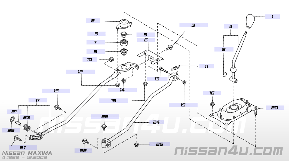

Moncef, I know you just had some engine work done. I'm assuming it was out of the vehicle. Check your bolts/nuts at the support control rod(17) and rod control(24). A little play in those fasteners can really screw up the linkage alignment. Just diagnosed a friend's 4th gen with the same problem after a tranny rebuild. Got underneath, found the loose fasteners, tightened them up, and presto! Shifting was restored. 15 and 26 were his problem areas.

Yall were right. One bolt was loose and one bolt fell out. Tightened/replaced and all is well. Thanks for the help.

Moncef what bolt(s) was it? #15 is what was loose on mine

Both on that bracket - 15 & 27.
