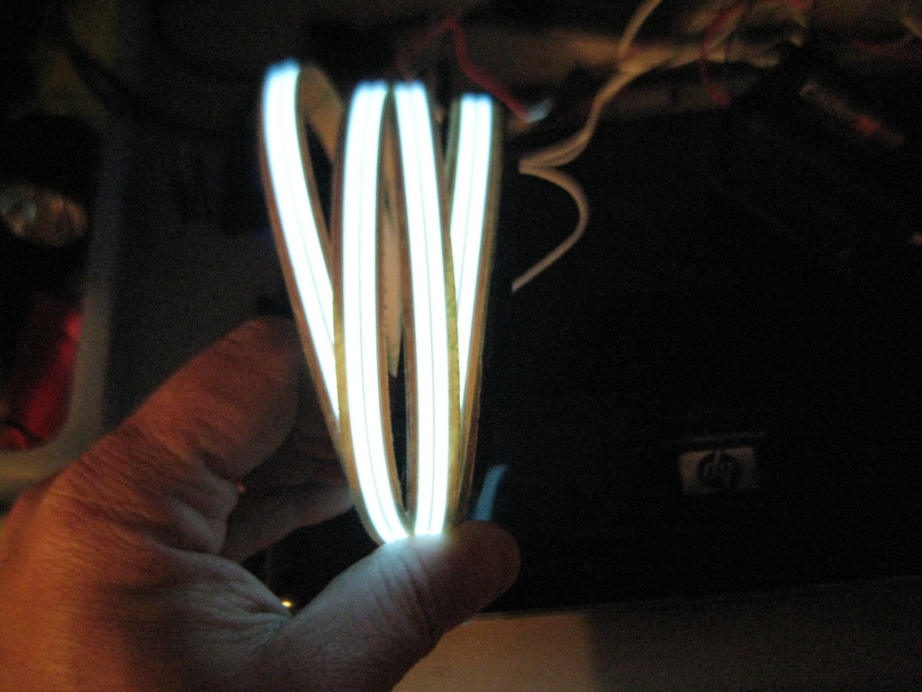

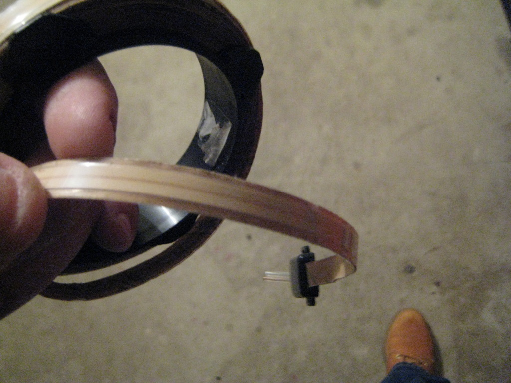

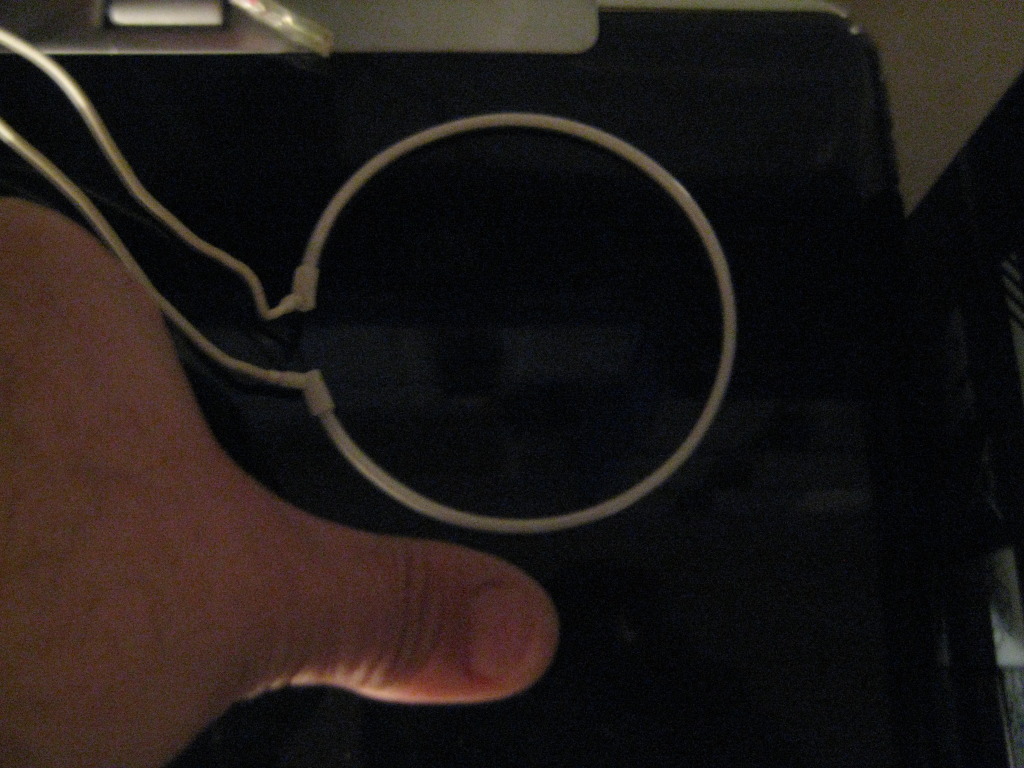

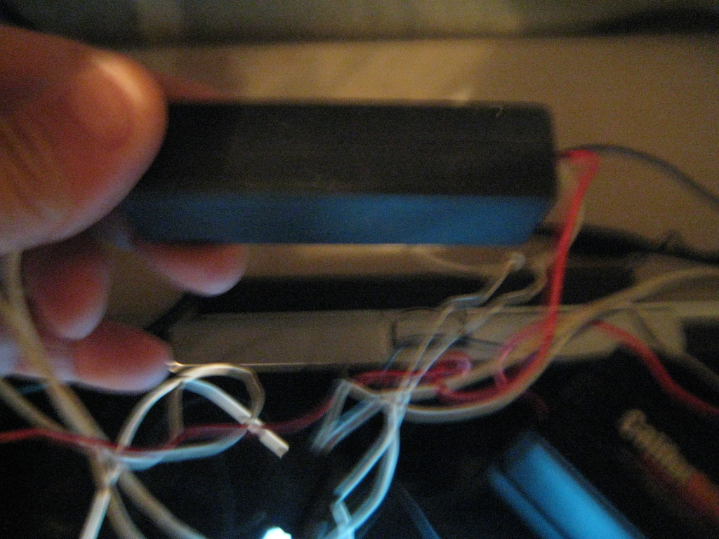

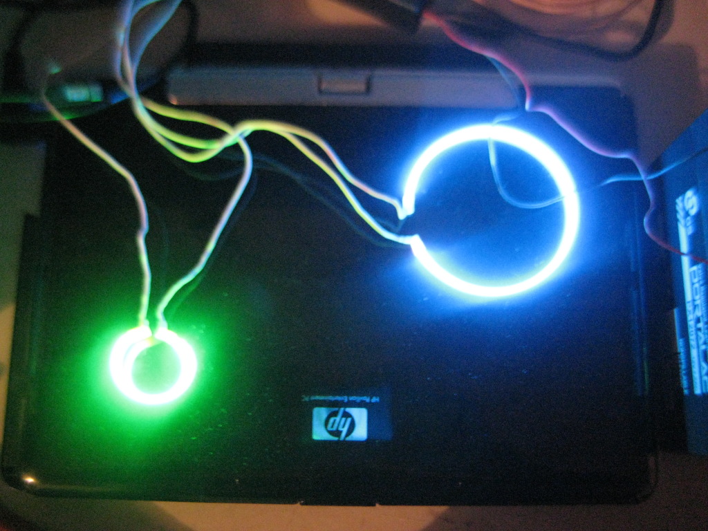

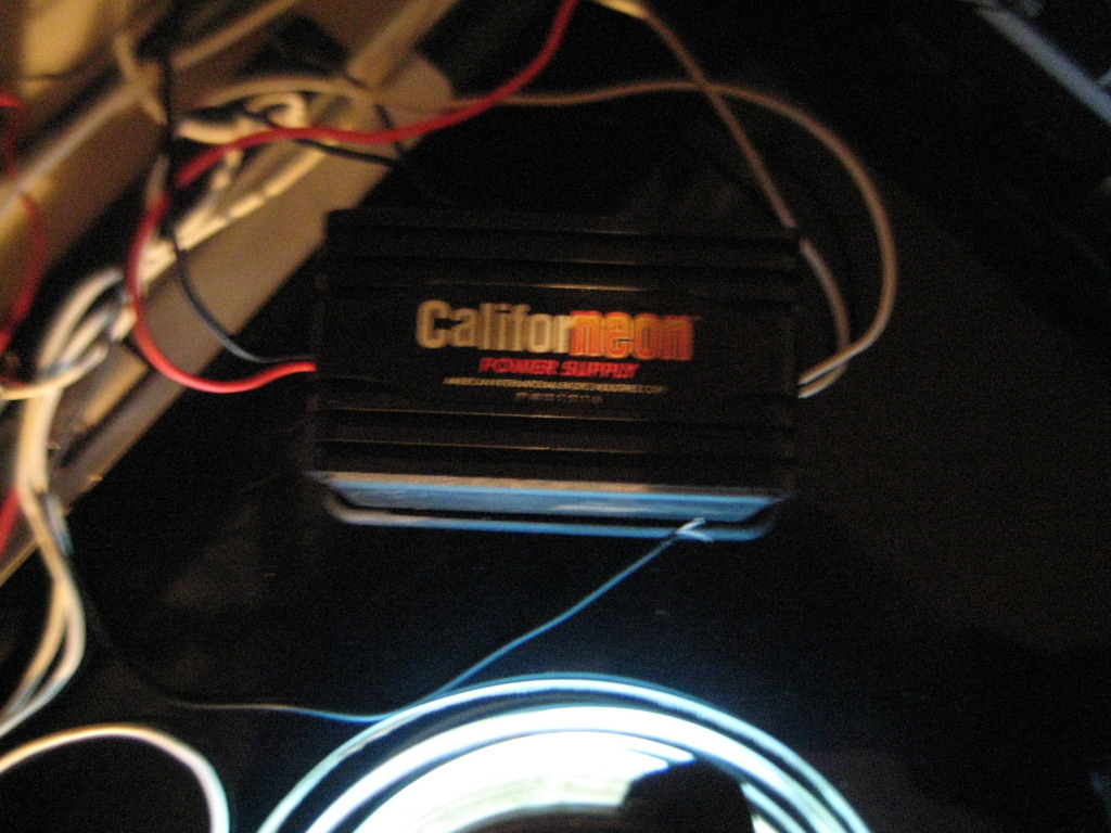

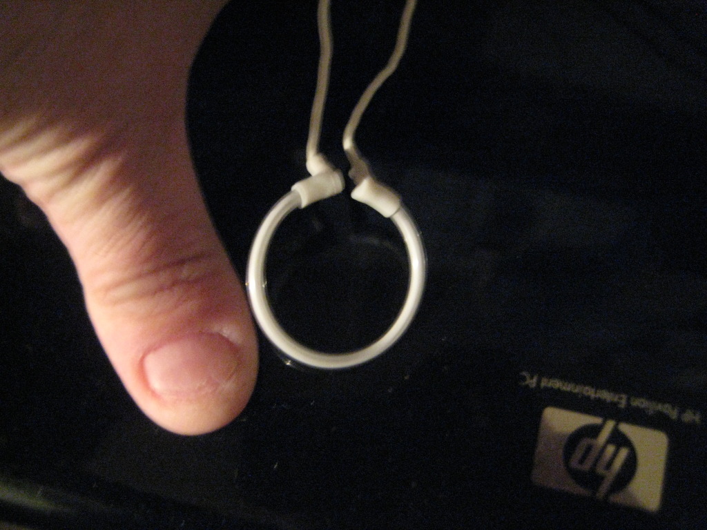

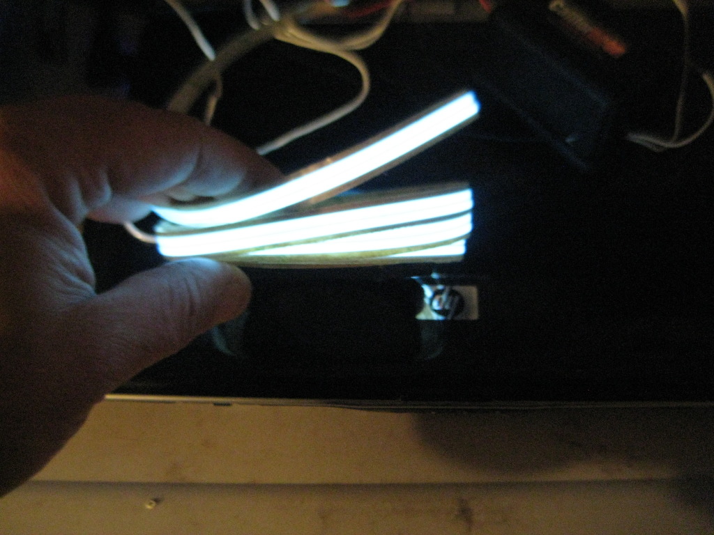

The CCFL units are just a ideal i had about halo the tail lights there only $5 on amazon and come in plenty of colors. and about 6-7 size combo's

sweeet dude. How's the on/off delay? I'd want to use this for my signal lights, think it'd work, or too slow?
Old Mar 25, 2012 | 07:22 PM
  #243
cjandura's Avatar
Joined: Nov 2006
Posts: 3,622
From: WestChester,PA.19380
Instant on/off for the ccfl and strip usaually anything fired by a transformer is instant
