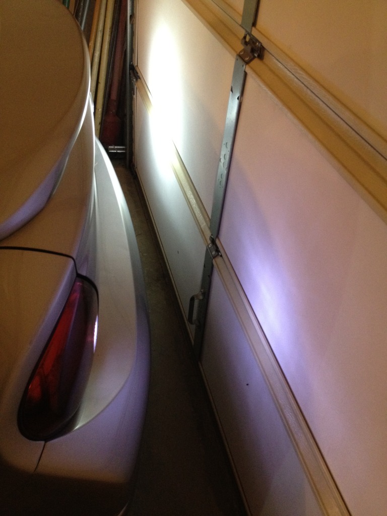

Sneak peak of my custom LED Reverse lights...
Looks good what did you use?i tried one of them 15w hid kits but it kept blowing the fuse and i was worried about the heat.
Old Mar 9, 2012 | 07:02 AM
  #212
guarj17's Avatar
Joined: May 2011
Posts: 72
From: Suffolk, Long Island
Holy obnoxious reverse light! I want it!
That would really help me backing up at night because my tints make it impossible to see.

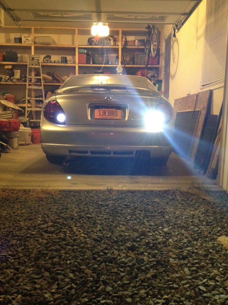

All outdoor lights off... Standing about 12 feet behind the car, just in reverse...

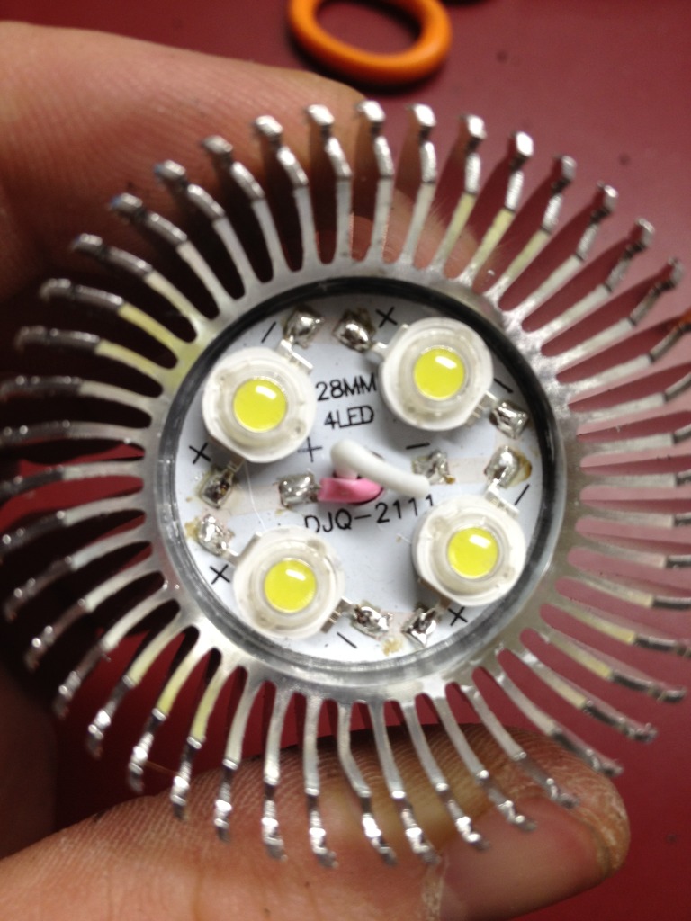

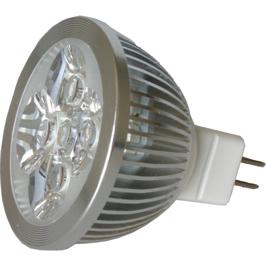

I used These bulbs: 4W 12V 440 Lumen 60 degree Replacement LED bulbs (halogen replacements)

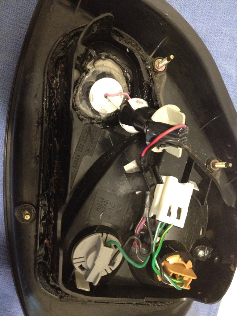

First I took the ring off of the top and removed the lens. De-soldered the 2 wires from the LEDs and then unscrewed the base. After the metal housing was removed, I re-soldered the wires to the LEDs.
I took the loose lens and figured out the size of hole I would need to make. Using the cutting disk and grinding pad on my dremel I made the hole slightly smaller than the LED lens.
After I epoxied the lens to the tail light housing, and let dry for 20 minutes. then took the LED bulbs and base, stuck them back into the holes in the epoxied lens, and then expoxied them to the lens. Let dry for a few hours.
After that was done, I took the prongs from the bulb, bend them outward sligtly and plugged directly into the reverse socket. Ran some electrical tape to hold in place (didnt know how well the lights were going to work, so I taped it as a temp), and installed them into the car...
Shortly I will remove the tape, and remove the connector from the tail light harness. I plan on crimping on some connectors, and connecting them directly to the bulb.

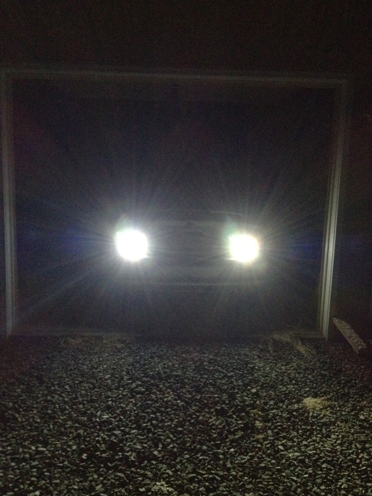

This is the end result.
and both sides done:
Old Mar 10, 2012 | 05:10 AM

simply put... It looks like I have headlights coming out of the back of my car... You can always go for a bulb thats not as bright... Mine are 440 lumens each and you can go for something in the 150-200 range.

OAN Customzlow, I'm in for some actual output shots!!!
Also, they are Epoxied in, so the heat shouldn't effect anything. I've already had them on for a few minutes at a time while taking pictures and whatnot, so I think they will be good.
I will try to get some good output shots in the near future...
