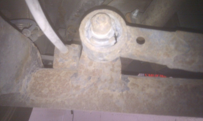

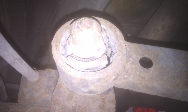

ok so instead of starting a new thread i decided to post here... took these pics back in the summer but never got around to posting it here... basically i want don't know what to do with this. i want a new bushing in there or replace that whole link (qt link?) cause it just looks like the bushing is disintegrated lol
i've searched for how to but i got links to that fancy adjustable qt link from the sentra for us :/ the cars gonna be lowered come spring and i'm already halfway done fixing things up front and i'd like the rear refreshed as well.
i want to know
-where to get one and cost?
-should i get the adjustable one?
-how do i go about replacing it and can i do this with a buddy or am i gonna need to take it to a shop?
Thanks
Rene

Except for the adjustable one, I don't think an aftermarket replacement is available. So it's a matter of OEM/dealer vs adjustable. Just get the one that's cheaper if you don't care about the adjustability (plenty of people are lowered without the adjustable one).

Creak when rolling straight. Could definitely be your LCA bushing. I'd start there since it's confirmed.
Go with ES...
I'm going to change them out. Have the old lcas and have the es bushings.
Strange thing though, bad bushing is on the drivers side. Clearly sound is on the right passenger. I'm also getting typical bad cv joint sound and that damn wobble occasionally.
I'm pretty good with maxima suspension and it is def not the bushing that is causing the majority of issues. I will just chalk up the sqeak while rolling to the bushing for argument sake. But that clearly isn't causing all of the symptoms.
My real question is "Are these bearing symptoms?"
I guess I'm just going to replace the passenger axle again and see what happens.
Let me know if you have any more thoughts. and thanks!

Are you sure the axle and bearing were installed properly?
Very hard to tell by description alone. Keep us posted!
Haven't done the bearing - that's what I'm thinking is the problem but not typical bearing symptoms.
I installed the axle - have probably done 10-12 of them on maximas. Kinda hard to mess up passenger side axle . . . It is bolted into the bracket and axle nut is tightened to spec. I'm not aware of any way to put it in wrong.
Just strange.
Thanks.

Agree, doesn't sound like bearing.
