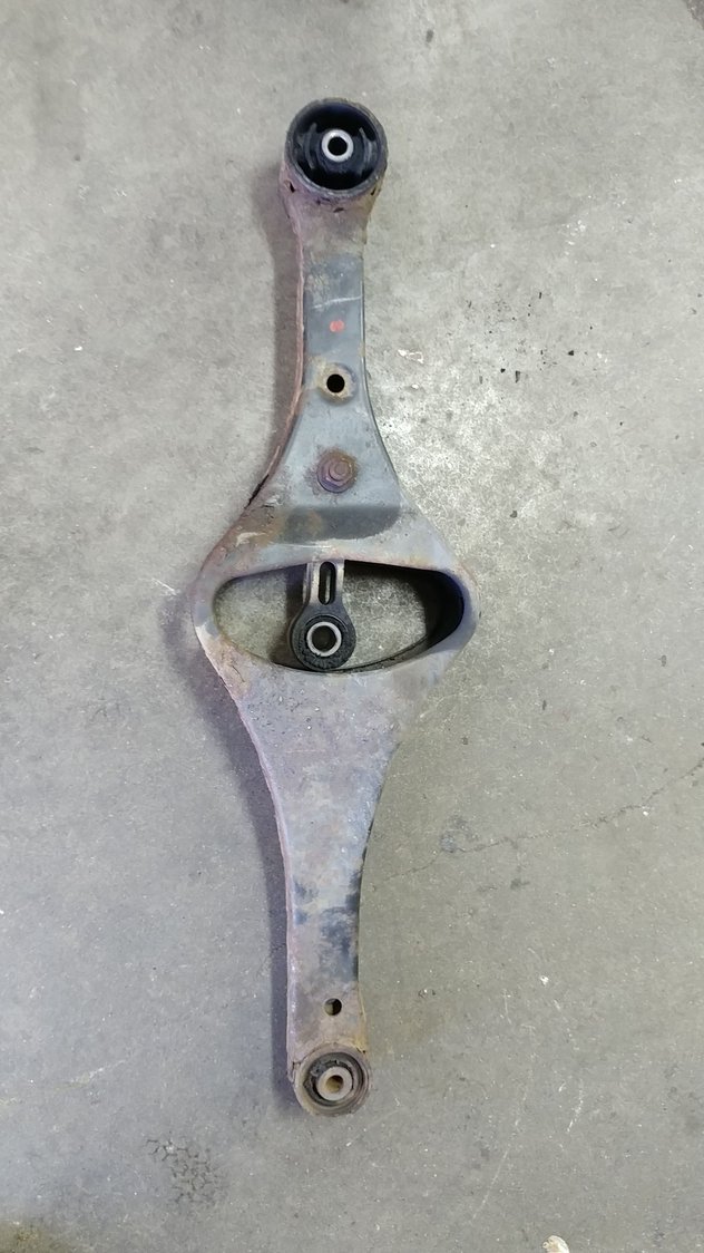

? Your ride height / stance looks normal? BTW the rear end with the "Scott - Russell" lateral link isn't really meant to have the ride height changed, as it puts a lot of constant strain on the lateral compliance bushing. Your rear suspension is "jarring" ? You need to check that the lateral link bushings haven't worn out.

I had a very nasty thud in the read when the rear wheels hit a bump, and quite a bit of looseness in the rear when turning left. It was the lateral arm bushing(s). Sorry, no advice about lowering springs. I find the stock ride height is okay, if actually a bit low, and wouldn't want to go lower due to real world road surfaces.

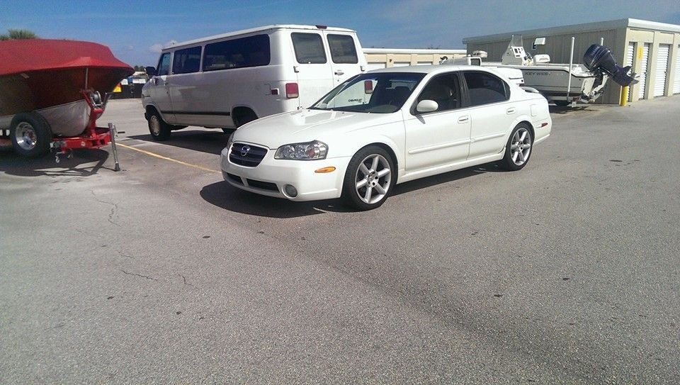

I'm on Tein S tech, advertised as 2.2" front drop and 1.6" rear drop with whatever KYB Rockauto had in stock for 2002 Maxima. the car sits more level than when I had the Megan racing springs.. I also have all polyurethane bushings and Addco rear sway bar
best side view I had that shows fender gap

it rides good for a daily driver and handles great on the highway. I always hated the huge fender gap these cars came with but didn't want it inconveniently low. it doesn't bottom out and has no problem fitting a jack under it.

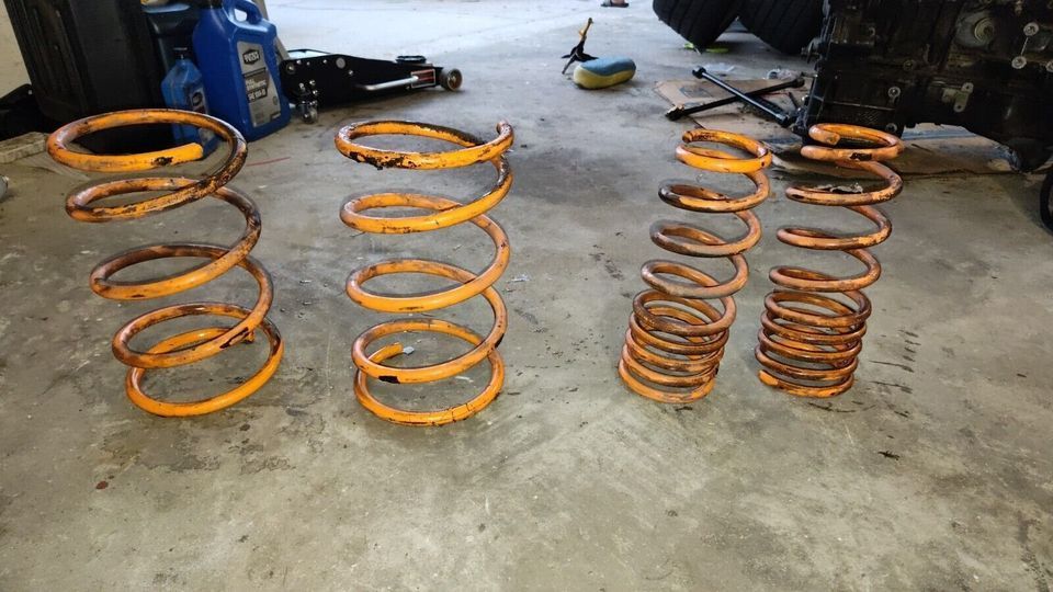

here's a pic from when I had the Megan racing springs. I still have them boxed up in the garage if your interested, just cover the shipping and they're yours. 1.75" drop all around..
