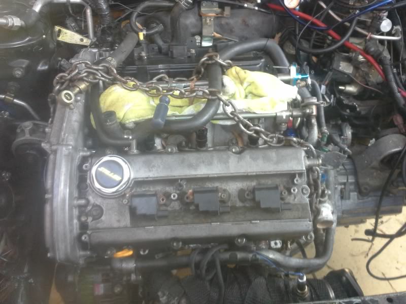

Ok need some opinions im on the fence because i dont feel like doing that kinda of work over again:
Some of you know i picked up a low mileage AE trans, and when i installed it last week i found out it doesnt fit properly. The transmission itself probably came off a 3.5 swapped sentra because it does not line up properly. Ive been talking to the P/O and he said he bought the car like that and it came out of a 3.5 swapped 4th gen so he had no idea, although it seems he is using stock mounts which cannot be possible with my findings. This to me is not adding up.
So here is the issue, the trans itself needs to come down about 3-4 inches to be in the proper position, for my shift linkage to line up and axles to go in etc. So here is my options:
1. Get longer bolts and space out the mount and try and use the transmission?
2. Pull it off and put my old trans on and try and get my money back? Still have to pay for shipping if i do this.

um...bellhousing swap maybe?

could it be the sentra trans with a max bell on it?

sry should have included a pic but here it is, because its a 5spd which is strange but it bolts to a VQ but wont fit the 4th gen mounts:

vq37?
sounds like it possibly...
If you still can get in contact with the previous owner of the transmission, ask him if his transmission mount is OEM or from an auto parts store.
Are you trying to line it up with the block before you bolt it to the mount? I dont understand how it needs to come down a few inches.
If it wont physically mount to the block, check your clutch alignment.
And the reason I asked about the mount in my previous post is because I had to make spacers one time for the tranny mount for a friend. The mount was from advance auto and the part with the 4 bolts that hold the tranny was alot slimmer than stock. So the bolts would bottom out while there was like a 1 1/2" gap between the tranny and mount.
