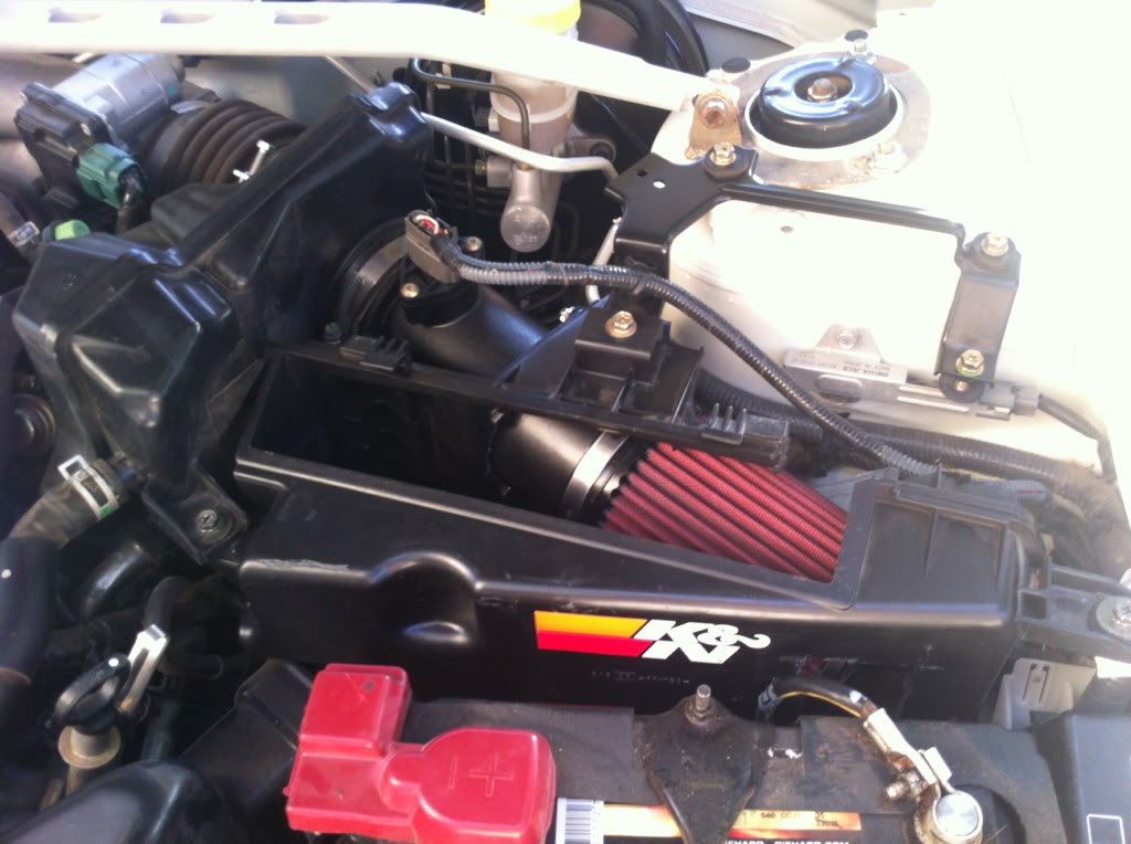

That intake you are looking at from eBay might not work. You'll have to find one that is a 00-01. 02-03 won't even work because the engine bay are different.
I think you should make it a short ram. It's cheaper, easier to install, and you won't risk hydro-locking your car in case you drive through a puddle.
Here is my set up right now.
Check out this thread, it really goes into detail about CAI and SRI.
http://forums.maxima.org/5th-generat...on-2012-a.html
That's an interesting setup. Never seen anyone install a cone filter inside the factory airbox.
I was thinking the same thing. Never seen that before. Very clever. Although I imagine it's neither better nor worse than the GAB.
In fact, now that I say that... OP, just GAB your car and be done with it. Won't cost you a dime, and you'll get that intake howl you're looking for.

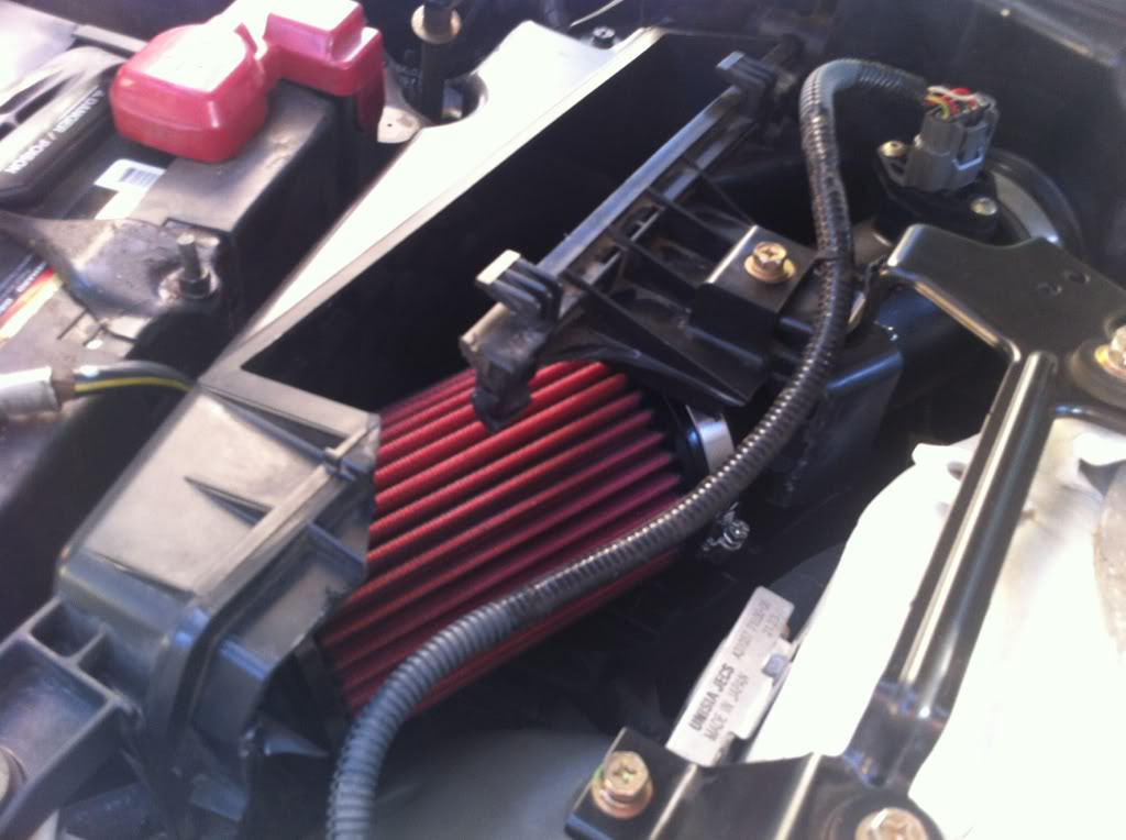

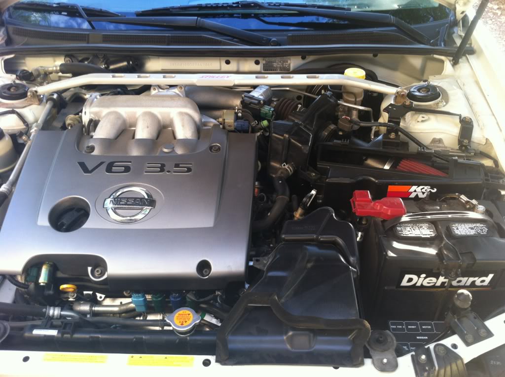

Thanks, I got the pipe from LI_Max_WOT and cut my airbox to fit it as a heat shield. I spent around $160 for everything.
Size:  106.6 KBName:  61f2885a.jpg

IDK why I like that, but I kinda do. It's really creative.
That filter is a cylinder instead of the traditional cone, isn't it?
Same. I think I'm going to do this.

Shielding it doesnt cool down the air though.....it still pulls air from a hot engine bay. Creative yes, functional no.
Yeah, that's true. It also looks cool too. I had put the filter cover on top of it to make it look completely stock but it was flapping around when I was driving it do I just got rid of it. At least the air scoop still works on it. Part number is RX-4140 on the K&N filter, incase anyone wants to know.
That's true as you're sitting there at the light with the car at idle. Move forward a bit and problem solved.
Besides, the OP doesn't care about marginal performance gains. He already said so. He wants that howl.
So... GAB. /done
Not without negative pressure it doesn't. It's not a "scoop", it's just an inlet.
