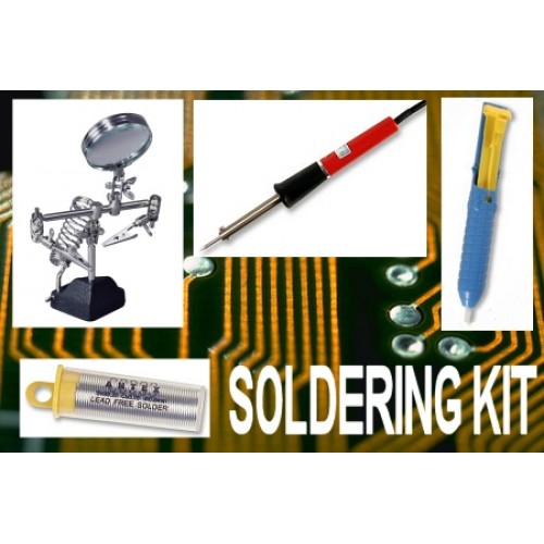

25 Watt kit similar to this
And I'd advise against doing the rear switches like he posted in that DIY, that is a mess. Try to always do stuff so you can re-vert to OEM if necessary, or at least, to the quality of oem.

Very nice TunerMax, so the rear switches are a pain in the a$$ compared to the front?
Where would be a good place to get a cheap soldering kit from? Radio shack, home depot?
