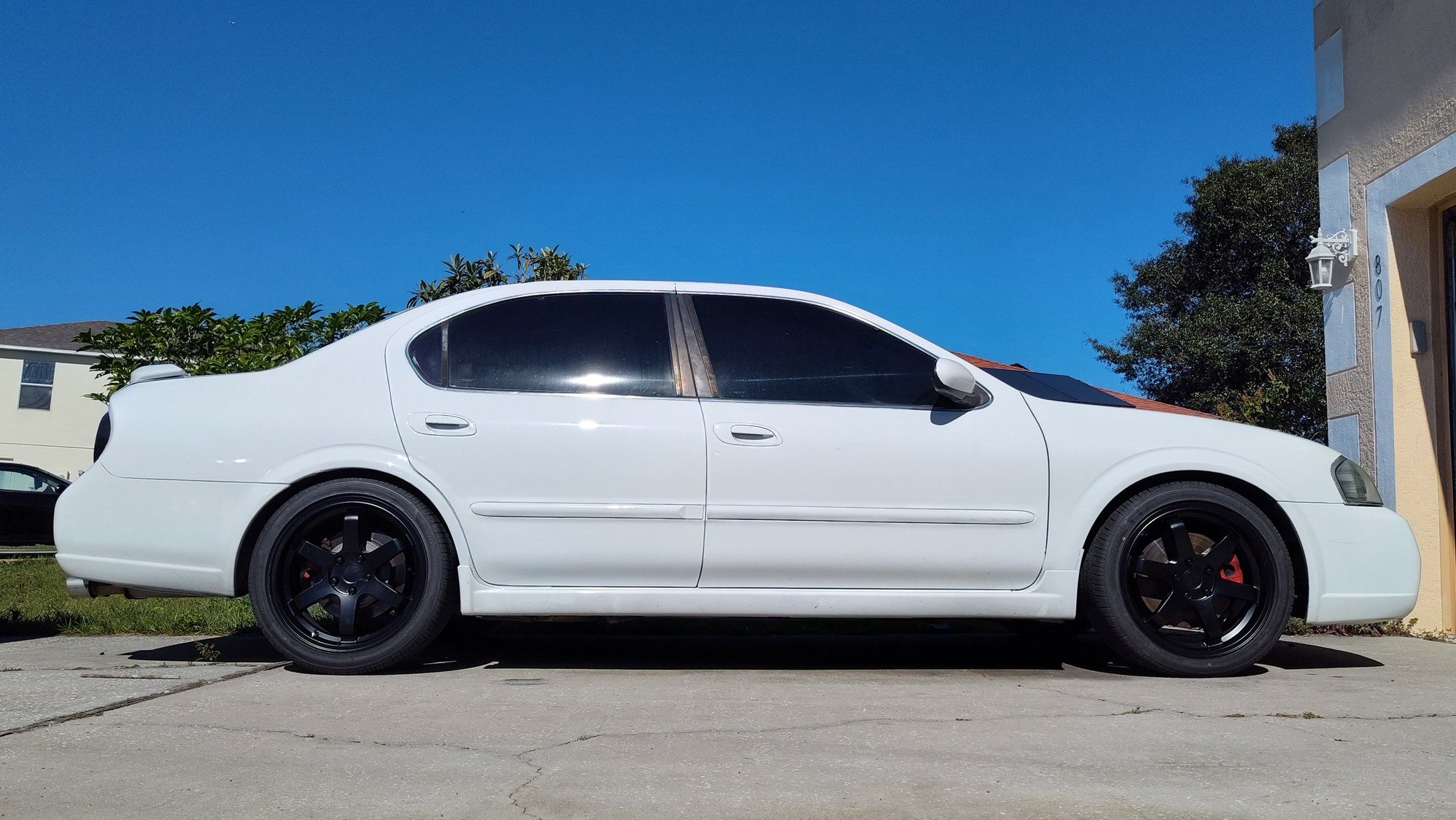

I went with Tein springs since they have the lowest drop ( 1.6" rear and 2.2" front). I had Megan racing springs for years but the front had more noticeable fender gap. I'm also on KYB struts. between that, all energy suspension bushings front to back, and Addco rear sway bar the handling is pretty good and still pretty comfortable. to my surprise the camber wasn't really affected.
