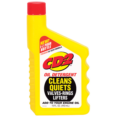

Get a bottle of this. It's available as just about any auto parts store. Report back on if it helps. I've used it on several cars over the years and it's always worked for me.
Will do...

Hope it works.....

Hey guys, me again...So I tried the CD-2 with no resolve to my engine tick. I ran that for 300(+-) a few miles. I decided to take off the rear valve cover to check valve clearance this weekend on the rear bank. All was picture perfect with the exception of the #5 exhaust clearance. This guy was about .030 or so that I'm going to guess. My feelers only went up to .024 so I'm just guessing. I started to take feelers apart to get a more accurate picture but this was good enough for me.
