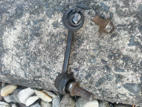

The sway bar side bolts seem to be the more troublesome ones. Make sure you have a perfect grip (vise grips worked well for me) on that inner bolt or else it will round off pretty much instantly. I rounded the inner nut off on my passenger side using an open-end wrench and this is how it looked after 2 hours of chiseling.
Good luck and don't screw up like me.
