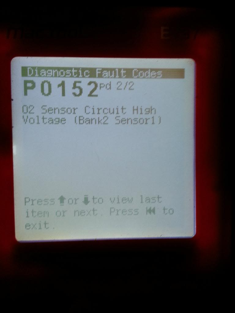

yes i have the dreadful p0300 code. Came on today along with p0152. what im wondering is..how these two codes effect one another. would o2 sensor throw a code for a multiple missfire? I kinda have an idea whats going on there but i would really like your input in on this..also i had a p0147 before but went away. i need a new maf soon.

The P0300 misfires are causing raw fuel to be pushed through the exhaust system and the O2 sensors will report problems from a too rich fuel mixture. Fix the P0300 and the O2 codes should go away.

i have no idea what could have caused it to have a missfire..i changed the plugs about 2-3 months ago. OEM nissan plugs from the dealer. i only have 60k on the car
also scanner read that the o2 sensor had a high voltage. guessin thats shot..

no code yet for which cylinder is misfiring, so I would wait till it shows up....hows the car driving, is the ses light flashing constantly? Coil IMO too

Until you fix the P0300 code, don't worry about the O2 sensor code, it may go away because there is too much un-burned fuel in the exhaust system. If you want something to worry about, worry about your catalytic converter. The catalytic converter is burning all that un-used fuel and will "wear out" the converter prematurely and it will plug up, requiring replacement.
If the ECU doesn't give codes for specific cylinders, you may have to replace all the coils.

The CEL light blinks when the misfires are occurring. But spark plugs will not cause a CEL. There are at least 3 coils failing, otherwise the ECU would give specific codes.
