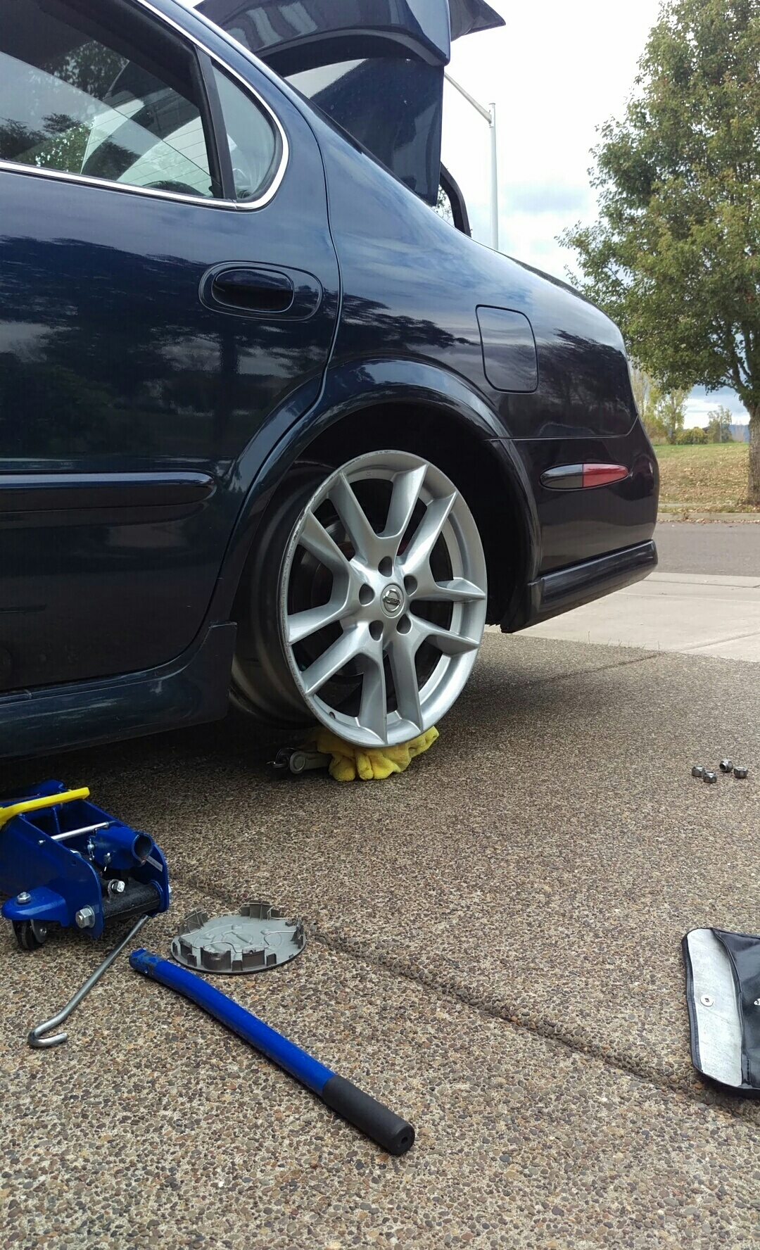

Got some new wheels today time to go find some rubber to go with

Wow, those infiniti rims are terrible. It's like they took pointers from the ghetto. Never go full ghetto :P
I agree. They looked worth a try up close. Once I mounted them and stepped back you could really see the awful pattern form. I removed them right away

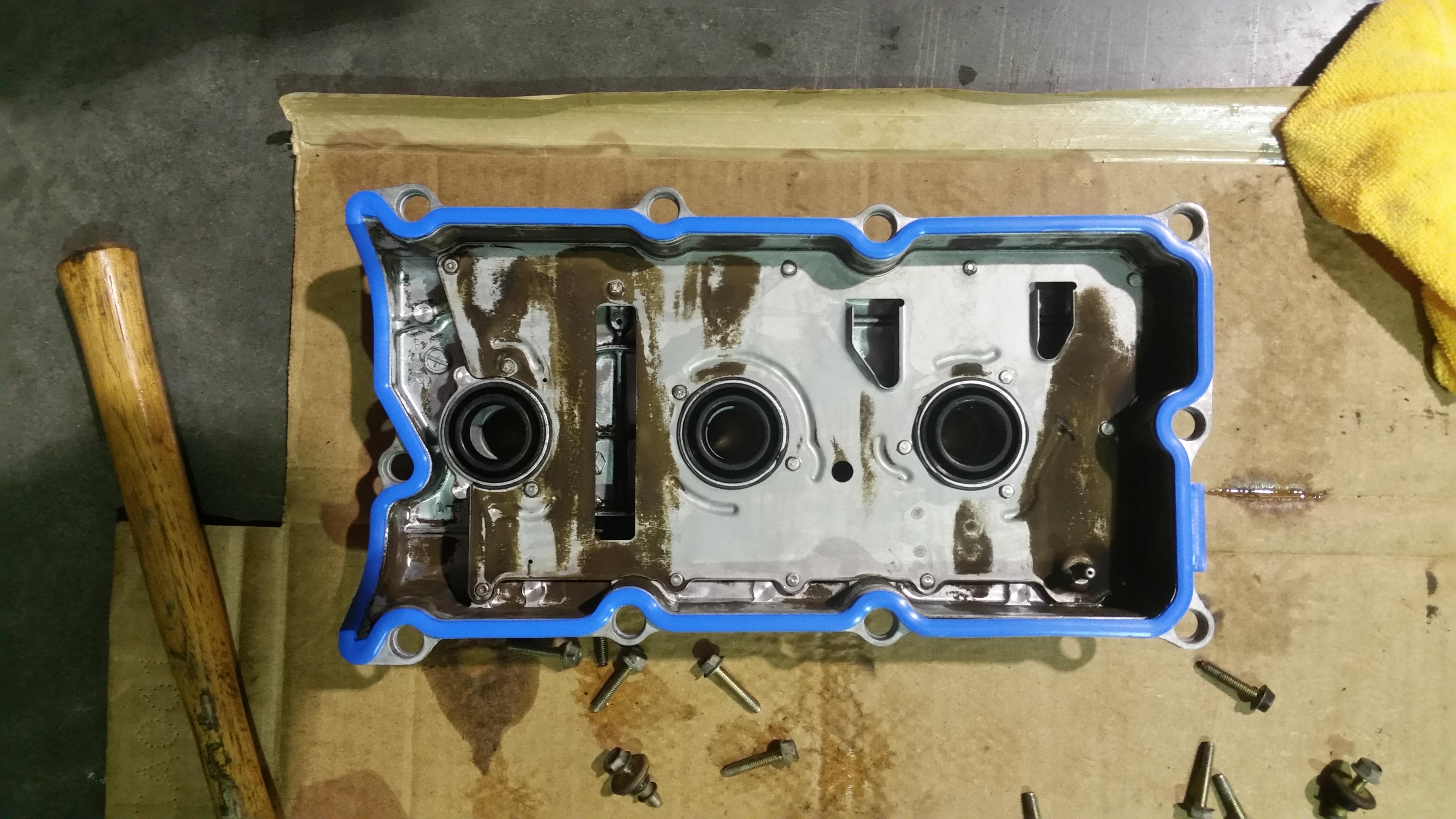

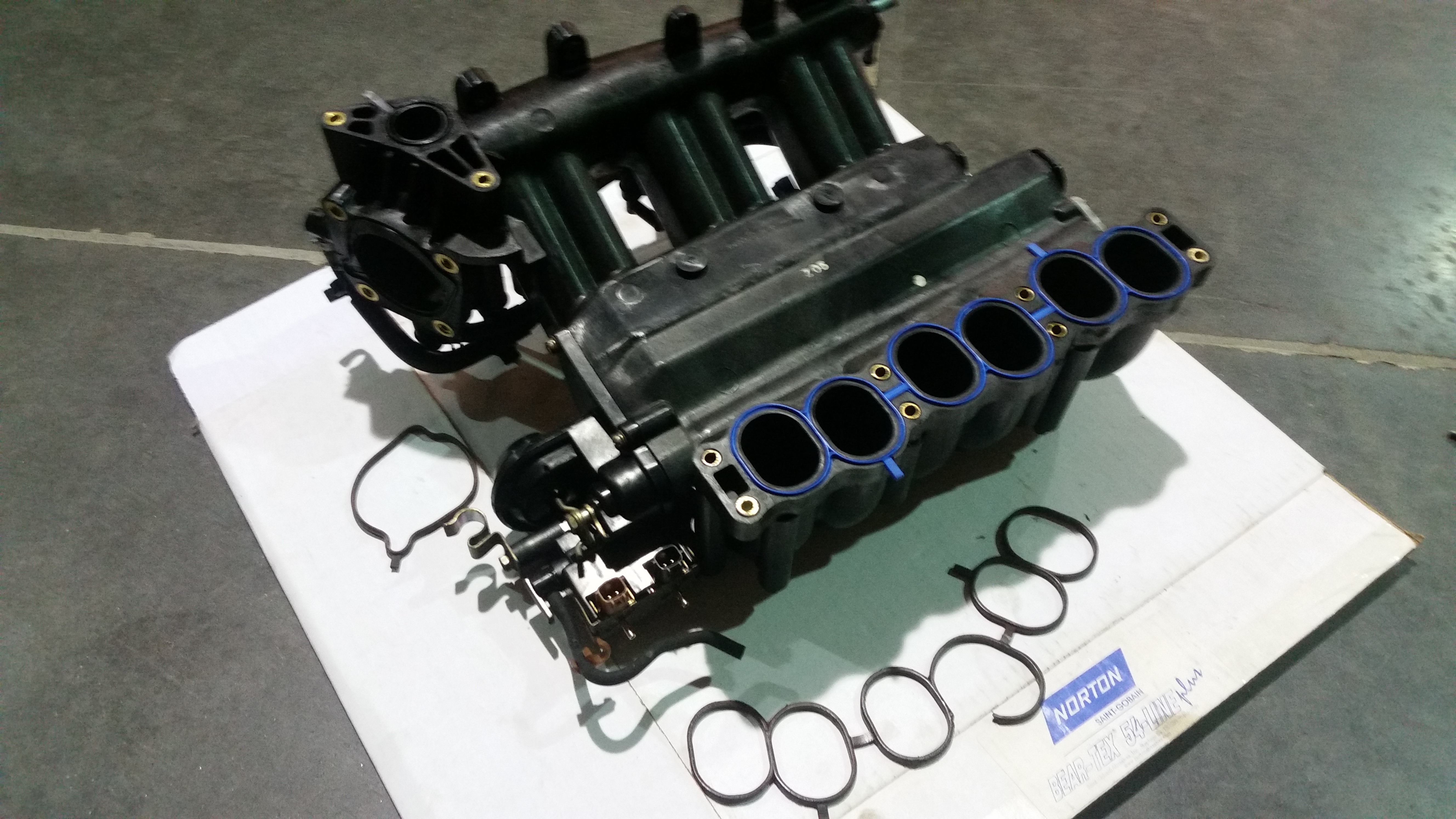

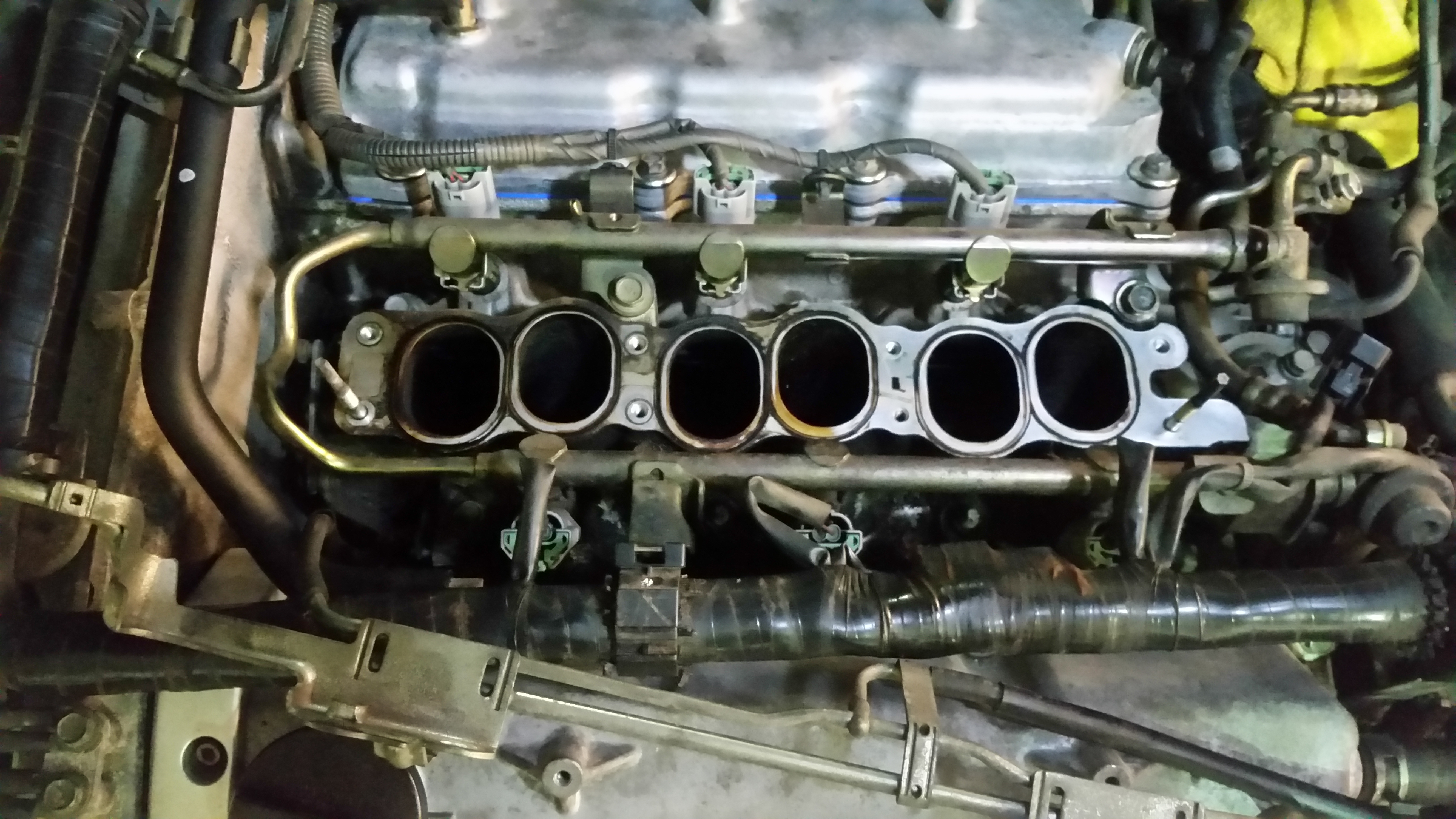

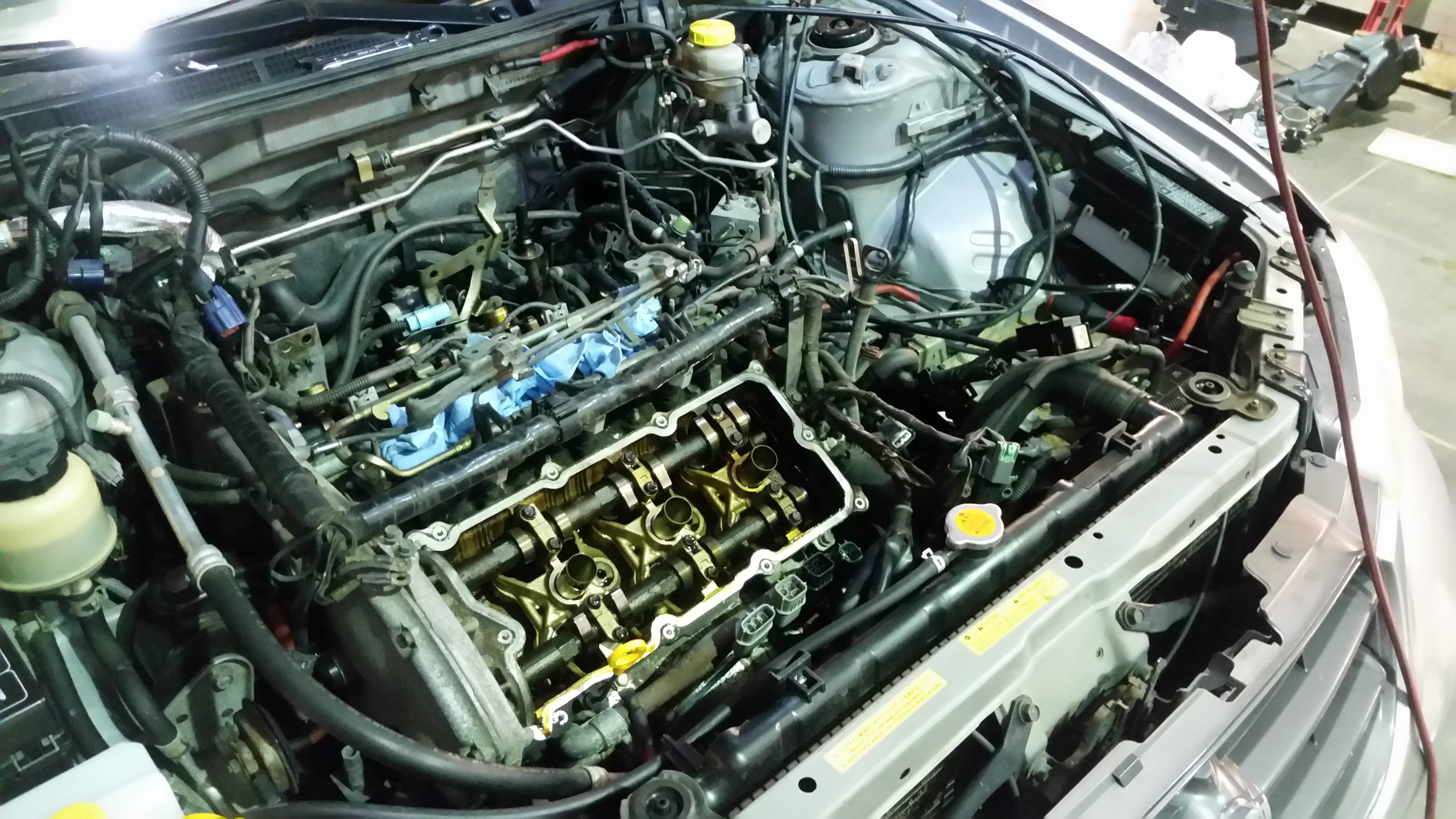

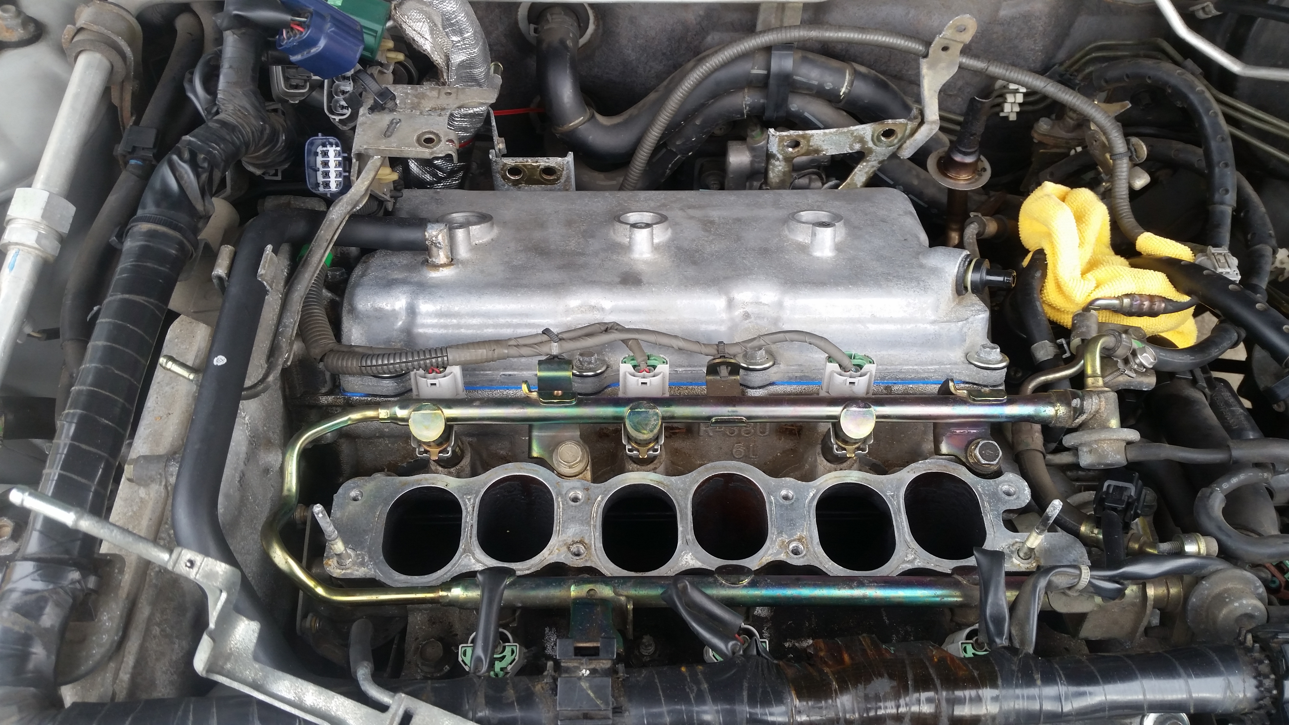

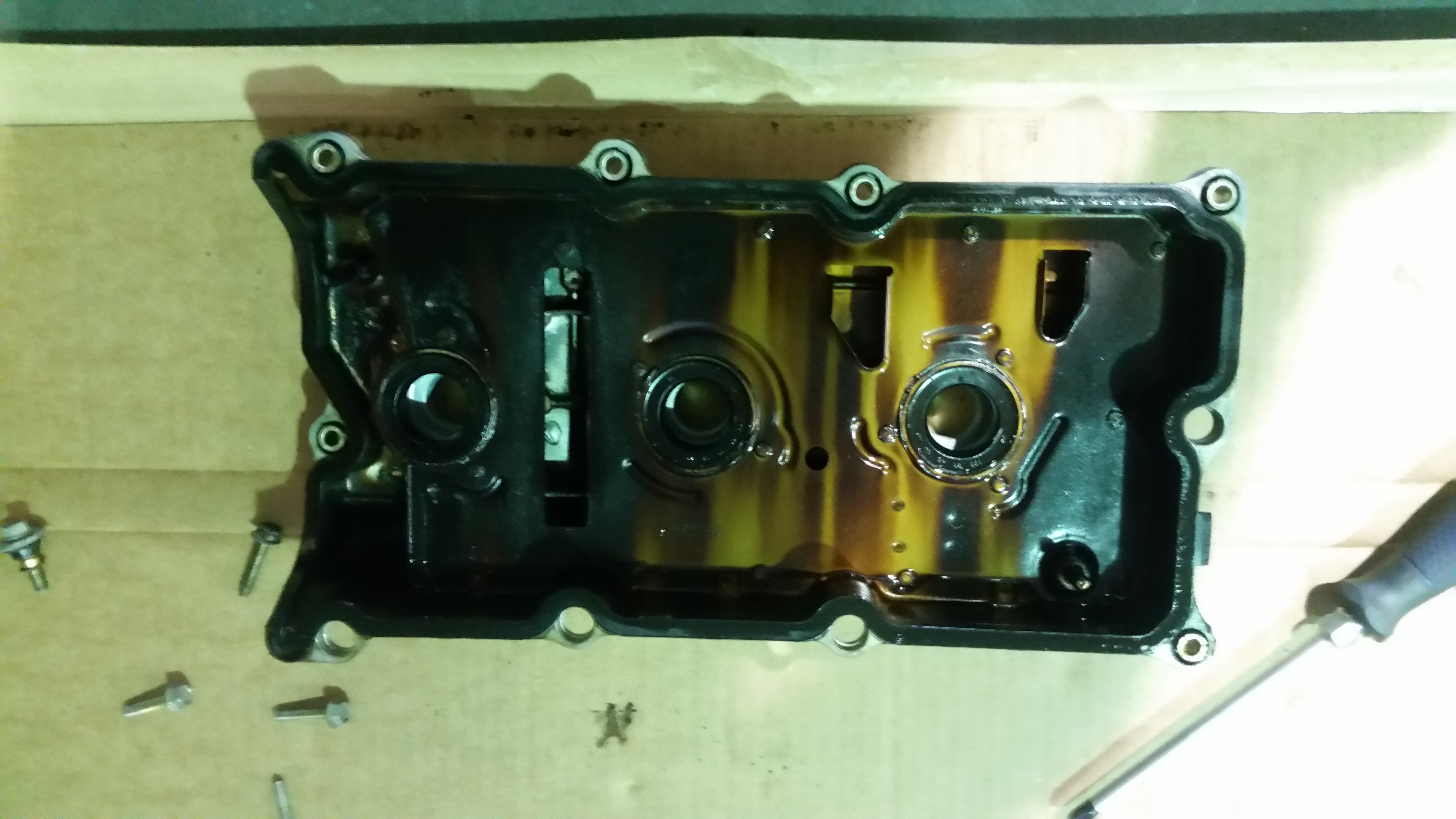

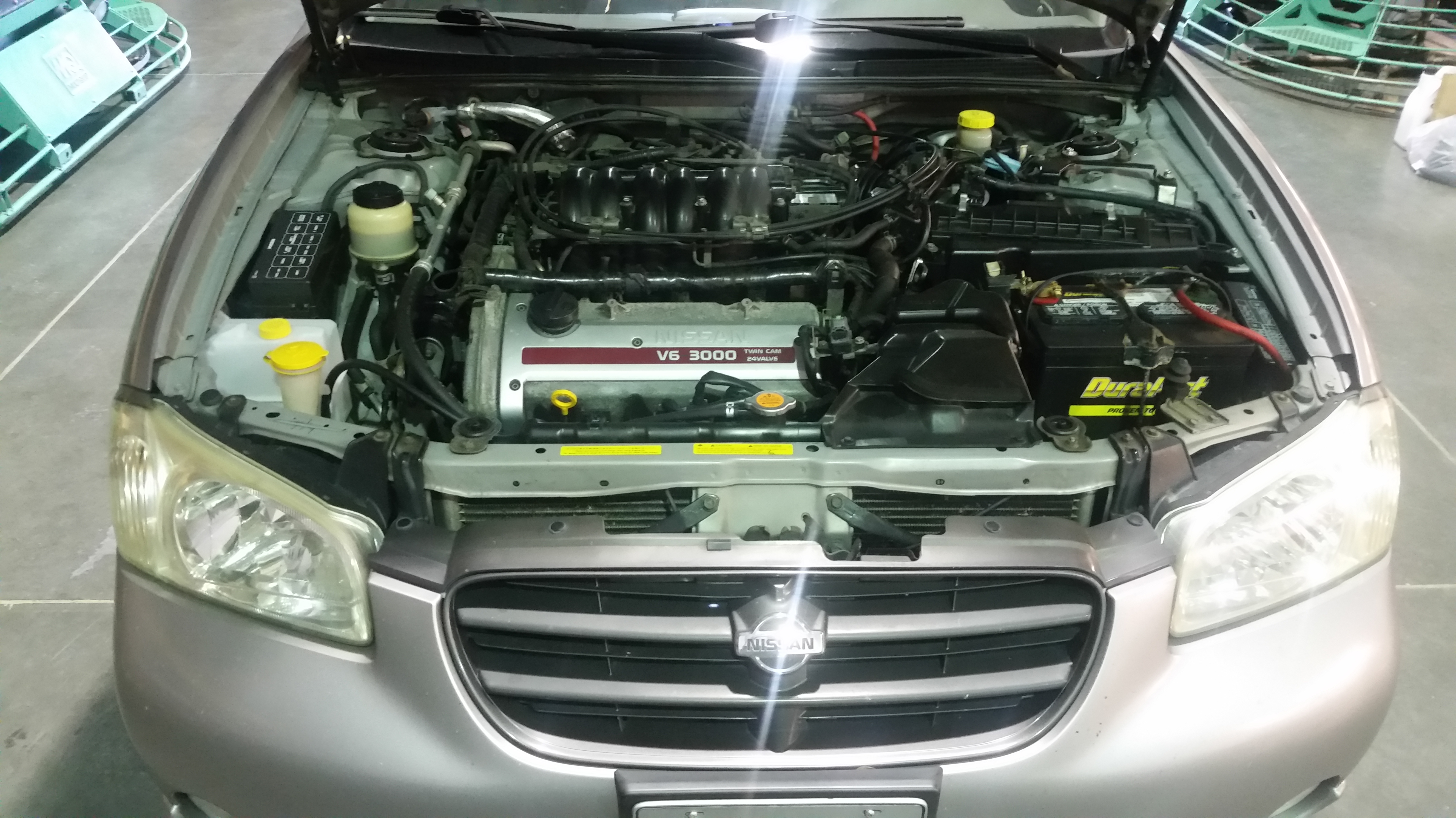

Originally Posted by cornholio
changed vc gaskets (hopefully)
if i'm not back before dark send help
so turns out i'm a slow hack mechanic. yesterday i made it as far as removing the uim. today replaced both vc gaskets, new spark plugs, finished oil change. i spend more time trying to clean the valve covers than i thought i would and still didn't get them perfect. ripped the hose between the two covers so putting the uim back on is on hold.
things i plan on doing before putting everything back together:
iacv coolant bypass
clean egr tube - looked pretty clogged, i'm still scratching my head how to get the 2nd bolt off this thing

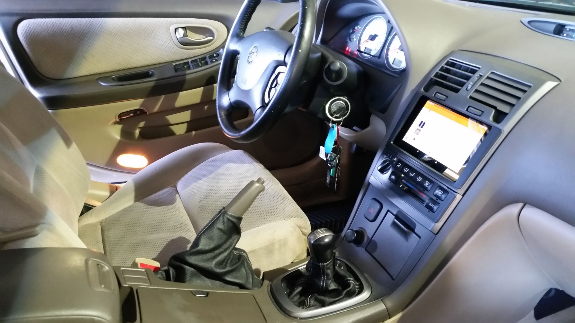

Originally Posted by 20thAE
Any pics? Sounds like a good change over the normal look
Here's my interior. Little dirty, but you get the idea.
I really like the look if the leather shift boots and black steering wheel on top of the brown and grey colors. I swapped to the MT trim bezel, and MT shift **** with Redline boots with white stitching. Just looks way better than the AT trim.
nice...looks sweet! so...is the swap plug and play or what. oh...and how are you able to select the gear positions?

The 6 speed shift **** is plug and play. It has the same screw pattern as the auto. Might look weird without a boot though.
You can manual select gear positions just by rolling the shifter into 1, 2, 3, and 4 (D). When you go for a drive in these positions, you can rev as high as you like. There isn't a whole lot of a point in doing so in normal driving though, as the automatic transmission knows when it's best to shift and can do so faster. I also can't speak much for manually shifting on a stock auto transmission. It can be really useful for preventing your transmission from upshifting when you're turning a corner or not wanting to needlessly shift when driving slowly, such as in traffic. It can be great for preventing the weird upshift into second the car likes to do at certain cruising RPMs when you decide to hit the gas. When you're done shifting manually, or hit 4th, you can just shift from any gear back to D and it will take back over seamlessly. Just avoid upshifting. Just put it back to D.

so...does the shifter not have the capability to lock into park like the auto shifter locks in park and you have to push the button to move it.
thanks

I forgot to mention I did this on a 02/03 model auto. It has a gated shifter, so there's no button. On the 5.5, it locks you into P/R and to move out you have to tap the brake.

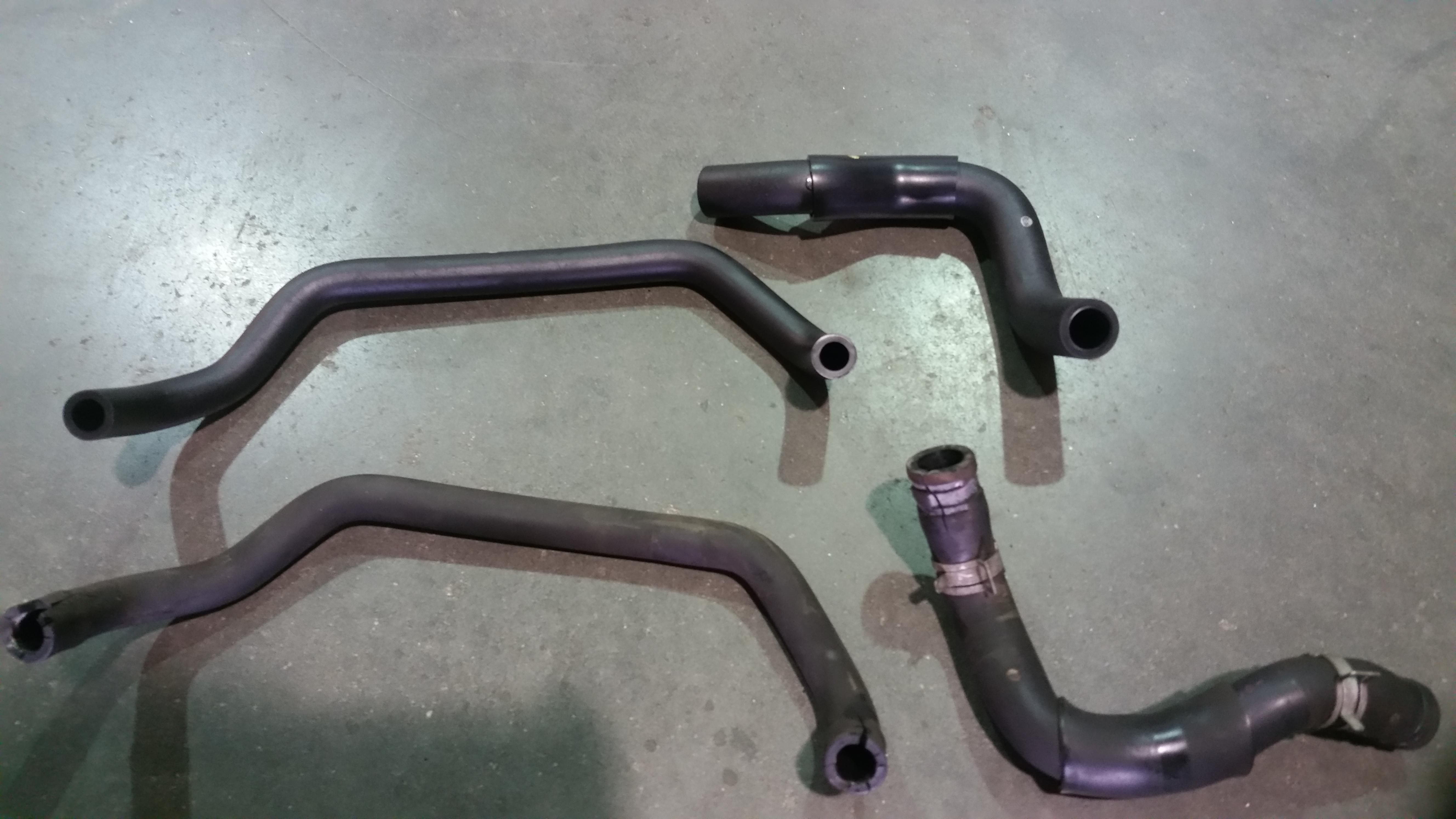

also replaced these

I like the original hoses more. OEM factory hoses and tires for life.
Old Oct 25, 2015 | 12:55 AM
  #2296
cornholio's Avatar
Joined: Mar 2013
Posts: 817
i saved the original hoses, i can sell them to you for a discount if you like

well got a little more time to make a full post so the last few weekends this is what i've been up to, it SHOULD have been a 1 day job but i stretched it out to 2+ weekends because i'm slow and have no idea what i'm doing and i had to wait for some parts. i'll make it pic heavy because that's what we're all here for anyways.
before:
after:
i started this job to fix an oil leak, front and rear valve cover gaskets. this is the furthest i've been into tearing things down.
once valve covers removed, i went ahead and cleaned them up as best as i wanted to:
before:
after:
cleaned up the uim/lim interface:
before:
after:
new gaskets cause i broke the old ones oops:

pcv hoses were brittle as fck and broke when i took them off so i ordered replacements, which is why this project really dragged out so long. napa tried to give me some gm crap that didn't fit.

all in all this is the most advanced work i've done on the car. minor stumble putting the uim back on b/c i'm an idiot, but my confidence is building and i'm glad it all fired up and ran flawlessly the third time i tried. 1st time missed a vac tube. 2nd time it ran, but forgot to plug maf and swirl control valve thingy. 3rd time fired up and running like a boss!
tldr- 15 years old, 223k miles and runs like a top
