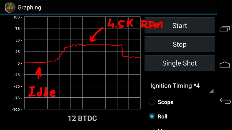

This is odd
I just came back from my car.
I wanted to do whole dance but something's weird...
My ignition timing on idle reads about 7-8. When I step on the gas it rises upto ~40.
These are the idle parameters:
This is a graph of what happens when I step the on gas pedal:
Am I missing something?
Keep in mind that this is a vq20de 2.0L enging!
Thanks,
Zohar

What is your base timing? you have a different car so they will have different parameters than the max.

As for the guy with the Sentra or whatever, no idea what your base timing is or why your trying to advance it. Timing does increase as you go through the rpm range. So that part is normal.
