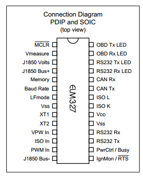

Interesting, testing out the BAFX adapter on the Ram 1500 with car gauge pro and it works damn near perfect. So fast compared to what i've been getting with the Vgate on the maxima.
Torque connects just fine with the adapter, but it keeps cycling through all the protocols and can't figure which one goes for the maxima. Eventually it goes through all of them and I get an error of no response from ECU or something like that. I did set it to the right protocol, but it just gives the error message faster that way.
I wonder if the solder joint on the chip is bad for the ISO input. The Ram is VPW input so that's a totally different channel from what our Nissan's give. Here is a diagram of the ELM chip from the data sheet on the below website:
Here's some information on the ELM327 for those who are interested.
http://elmelectronics.com/obdic.html#ELM327
I'm curious to find out if we can install the genuine chip in one of these clone devices. I'll take one apart and see what it looks like-- this could be a really cheap alternative to the OBDlink MX since the missing link for all these adapters is the clone chips. We can also get version 2.0 of the firmware.
The chip from their website is just under $24, and shipping is $8. So if this works with the 10 Vgate knock off we could have a comparable OBDlink MX for $42.
Anybody know if this has been tried before? Google didn't come up with anything from what I tried.

Interesting! I might of taken this route.. A genuine elm327 2.0 would be choice at under $50. Wide range of compatibility with sleep mode like the elm327 1.4b.
After reading the elm site I notice what I think was mentioned before; EVERY elm327 1.5 version is a clone. I can't seem to actually google a legit version 1.4b or 2.0.
This is posted on the elm site: A few clone makers have carefully worded ads that make it seem like they are using genuine version v1.4a, v1.5, v1.5a, or v2.1 Elm chips. These can not use Elm Electronics ICs as we have never made those versions..
I would say the knock off elm327s 1.5 and the like are a gamble. Some work, others work but not well and others just don't work at all. It would be good to find a legit elm327 2.0 dealer.
