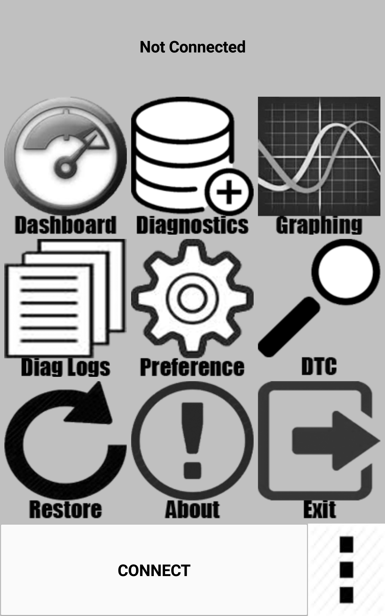

OK I just downloaded car gauge pro and the app looks nothing like the video in the app store and I see nothing about timing advance. An I missing something
Here is a pic of what mine looks like. Where to go from here
Attached Thumbnails Advance timing with android phone?-screenshot_2016-02-08-18-52-14.png
Old Feb 8, 2016 | 04:28 PM
  #476
Child_uv_KoRn's Avatar
Bad *** Newb
Posts: 4,975
self test under diagnostics
I've bought multiple adapters on amazon and they work. They're just those blue ones.

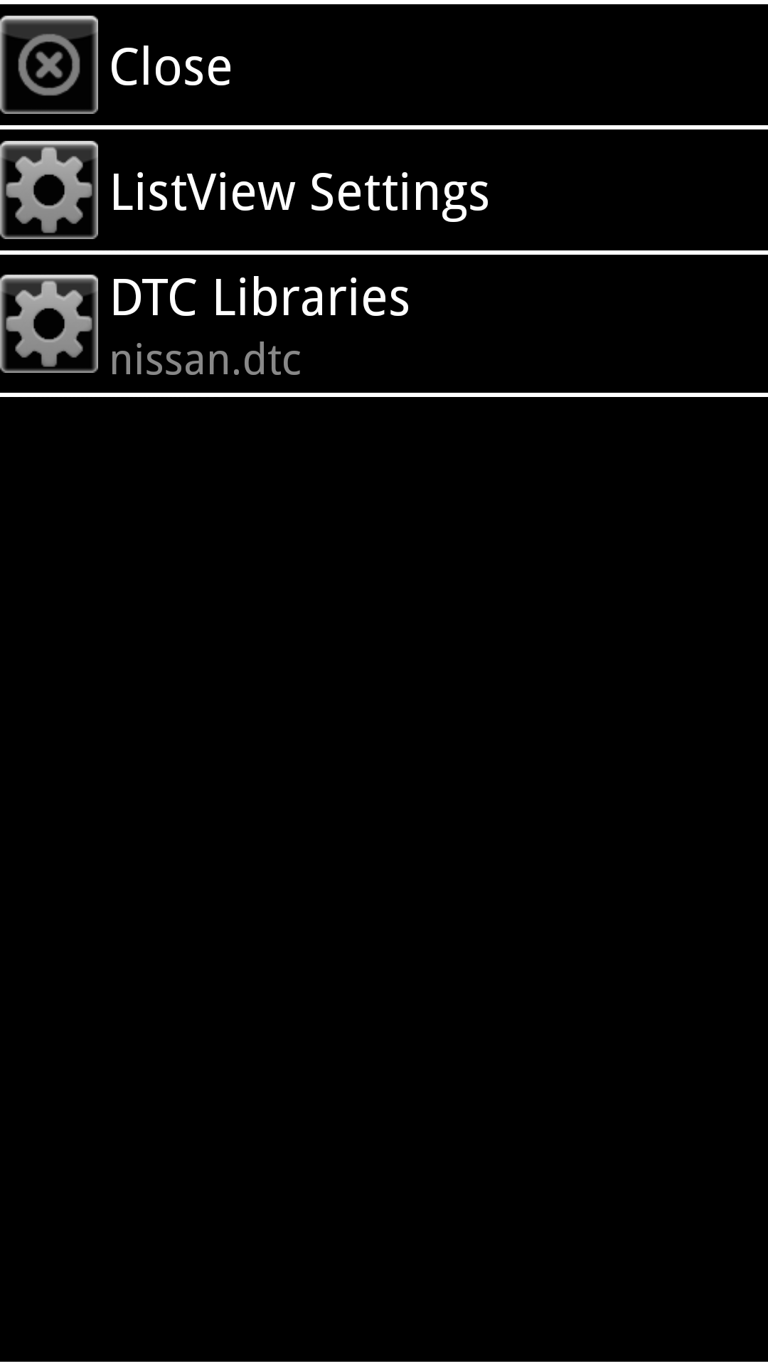

This is all I have under diagnostics
Attached Thumbnails Advance timing with android phone?-screenshot_2016-02-08-19-55-09.png
You're not connected to the ECU.
