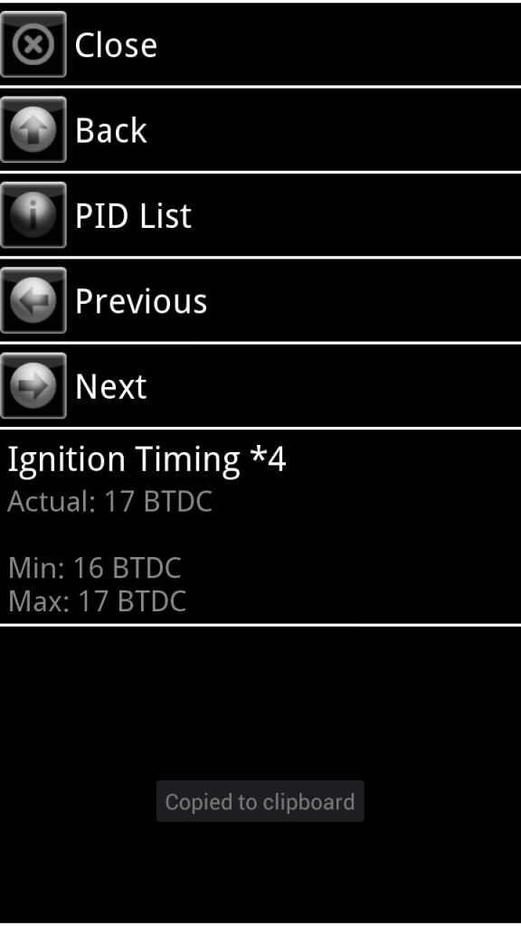

I'm another happy user of this new software. I had an old elm 327 adapter laying around that I had originally linked up to my old phone, but had no idea what the password. Turns out it was 6789 as suggested in this thread. If I want to actually drive around with the monitoring software active I'll likely need to get a lower profile bluetooth adapter as my leg was brushing along the one I have when shifting.
After warming my car up first, I then proceeded to advance the timing with no issues. It was at -1 to start, and I have it bumped up to +2. Idle looked good in the 675ish range so I left that alone. This software is awesome, I tried previously to get a local nissan dealer to advance my timing, and the tech wouldn't even try, saying that he knew for a FACT that the timing advance wouldn't stick, since someone had once asked him to advance timing in a Pathfinder and that didn't stick. Ugh. Turns out waiting a few years was required to get this done for $6.

I advanced my timing today i used the adapter cauzindrama recommended with my galaxy s3 there was no errors no issues with the program and the adapter worked perfect on the first try. My timing was on -1 i increased to +2 saved it and the timing advance saved no problem i restarted the car a few times and kept checking its at 17 and sometimes 18. Car feels different i had the AC on and family in the back and i noticed it more peppier. all in all great program ive been playing with the gauges very customizable.
