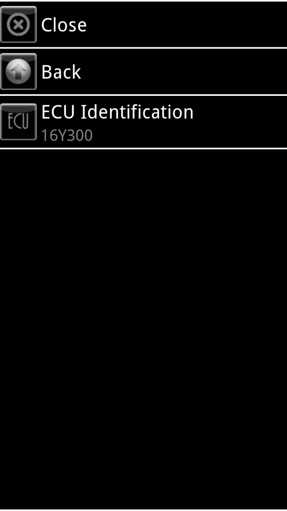

Originally Posted by TallTom
I wonder if there is a way to find out the version of the ECU software. I looked around the app and didn't see it. It would be nice to know if I have the latest ECU reflash in the car.
I did see this. Its in there. It said ecu version and it had a few digits. Dont know if its reading the model number or software version but its there.
i saw that too, but figured it was the serial. I think mine was something like 15y701 or something similar.

Mine shows 16Y320. Anyone know how to decipher these?

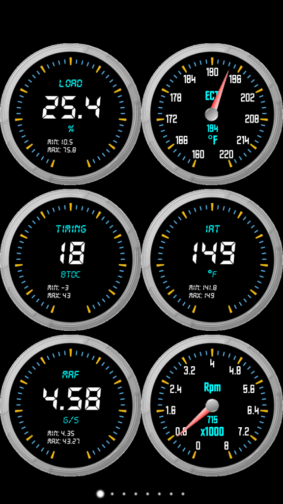

Originally Posted by Finchum
Woot! ordered mine today.
http://www.ebay.com/itm/400469896519
Got the app too. Anything I need to make sure I do before I get into this once the obd thing arrives? Any certain settings? How do I get more gauges?
Press menu>>add gauge
Heres some of my gauges
U can add several pages. I added a page of o2 sensor related gauges for diagnosing o2's. Very customizable, i'd love to see other ppls profile of gauges in this app. I dont think ive seen a emissions readiness monitor.
Check out nissanpartzone.com and enter your year, make, model. Go to the engine control module section and you will notice there is a list of modules by production date. Yours shows that there is a replacement part number for your module -- 5Y703RE. I don't know what the differences are but there must be some to create a new part#. I have a new part# as well. I'm going to keep searching to see what is different about the newest modules.

Heres mine its ecu identification
