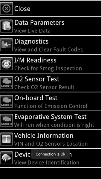

I'm not getting an option for self-test.
Attached Thumbnails Advance timing with android phone?-screenshot_2013-06-20-12-06-42.jpg

From: NYC
When configuring the ELM, what settings did you choose?
Are you referring to the adapter protocol? I left that on automatic.
Dumb question, but did you buy it or torrent it? If you bought it make sure you are updated. If you dl'd it from "another" source... not sure how you can push through updates.

I got it. I had to delete and re-install it. Thanks
