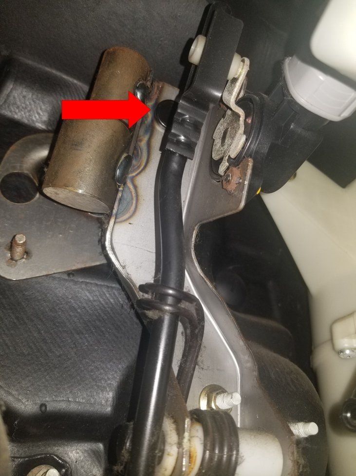

the one I'm talking about is for when you're not pressing the gas pedal. here's a picture I have from years back when I put a new stopper on it. the original stopper was a clear see through green that you can't buy at Nissan. Nissan was trying to sell me a whole new pedal assembly but I decided to try the regular black brake stopper and it worked.
when you turn the key to on to start the car it's as if the ECU wants the pedal at a real specific spot and if not the throttlebody isn't working once the engine starts running. it will idle great but no pedal response.
