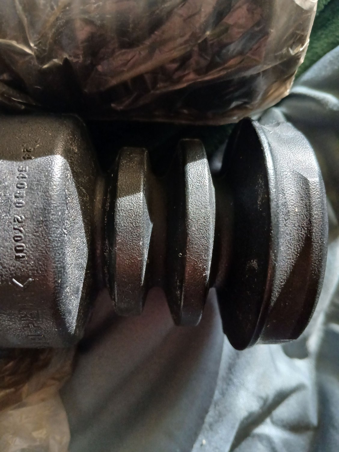

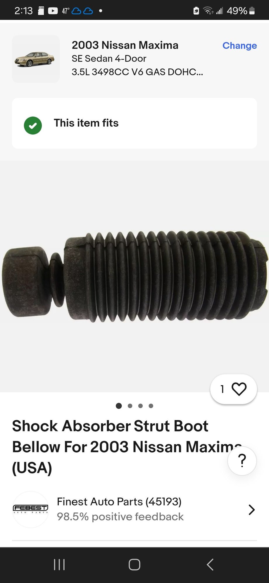

Quote: Do the febest rear shock boots, part # 55240-2Y000 have 2 rubber ribs like the oem 54050-2Y001 front boots have, or just 1, where the bump stop goes. Just trying to find out if the front/rear oem boots are different in sizes/specs.
Pic of 03 Max SE oem strut boot with (2) rubber ribs/bushings
Pic of '03 Max SE oem strut boot with (2) rubber ribs/bushings, 54050-2Y001
Pic of Febest brand oem copies of rear shock boot w/o bump stop. This vendor does not sell them together. Does this boot look like the oem Nissan ones for the rear shocks of an 03 Max SE 3.5L with (1) rubber bushing, instead of (2) rubber ribs/bushings like the first pic in this post? Is this rear boot correct? Part # 55240-2Y000? Anyone that can lead me in the right direction, thank you. These will be going on rear oem-replacement Kyb #341341 Excel-g shocks with the original,
Pic of 'Febest' brand oem copies of rear shock boot w/o bump stop. This vendor does not sell them together. Does this boot look like the oem Nissan ones for the rear shocks of an '03 Max SE 3.5L with (1) rubber ribs/bushing? These will be going on rear oem-replacement Kyb #341341 Excel-g shocks with the original, rear oem upper shock mounts if I buy them. Thanks for any help!
​​​​​I wouldn't put too much thought into what strut boots to get. just pick a set and you'll be ok. KYB struts are decent. I'm running KYB struts, boots and upper mounts that I got from Rockauto with Tein springs and it all worked out great.
