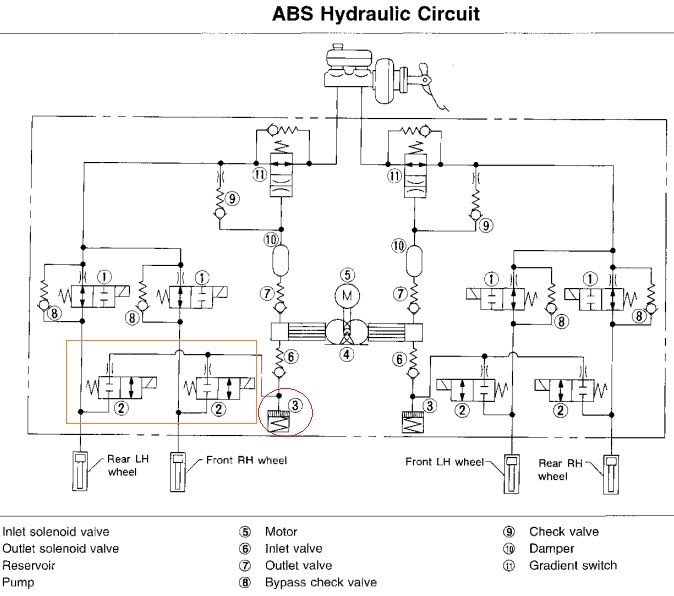

You're describing exactly the phenomenon that I've been experiencing on my 4th gen ('96 i30) that started occasionally, but now all the time. For what it's worth, I've gone a long way down the troubleshooting path trying to fix this. The problem is EXACTLY as you describe. If you have a longer period of sustained driving with no braking, then if you start applying braking for, say, an upcoming red light, then you'll feel the brakes catch initially as they should, but as you apply more force to the pedal, not only does it sink further than it should, but you gradually have to apply more and more pressure to achieve normal stopping power. The feeling (at least for me) is that it's never going to stop, and I'm going to run out of pedal "throw" before I can achieve the stopping force that I need. Very distinctly different feeling from air in the system. If I quickly release the pedal (sometimes twice) and apply force again, then it will firm up nicely, and I can sit at the red light with what feels like perfectly normal braking pressure. I've tried coming to a stop on a slope with a single gradual push of the pedal, and I've literally HAD to pump it to get enough pressure to hold it from rolling backwards down the hill.
In any case, conventional wisdom is obviously the master cylinder. OK, fine. I replaced it; bench bled master; all four wheels bled in correct sequence; ABS actuated on wet road; re-bled; all fresh-clean fluid coming out at all four wheels. The problem felt a little better at first, but then came back. I did a post-mortem exam on the original master cylinder, and not only were the rubber seals 100% perfect, but the inside walls of the cylinder looked great as well. At this point, I'm starting to rule out the master cylinder. All of the other obvious checks have been made. All calipers and slide pins are perfect. Rotors are nice and straight (<0.002" runout) with good surface and healthy pads. Booster checks out perfect (no leaks, good check valve). Next thing to do was replace the soft lines. Replaced all 4 and re-bled, and although the new ones were indeed stiffer (less stretchy) than the originals, this made exactly zero difference.
What's left? The ABS module, unfortunately. I've studied the hydraulic schematic in the FSM and it certainly does look like there are opportunities for valves inside the ABS to leak and cause issues, particularly with regard to what's called the "reservoirs." From the diagram below, valves labeled "1" and "11" are normally open as you would hope. Valves labeled "2" (yellow rectangle) are NORMALLY CLOSED. If these normally closed valves are leaking when hydraulic pressure is applied during normal braking, or if check valves (9, 7, and 6) are leaking, then you can see that the reservoirs (3) can start to fill up. NOTICE the spring in each reservoir. So, in the same way that a leak to the outside world would cause the pedal to sink, a leak into these reservoirs under normal breaking could very likely "feel" like a leak and cause the slowly sinking pedal. Once the reservoirs are filled up and the pedal is quickly pumped, there's no more room for more fluid, so the pedal returns to normal height, and the system feels firm. Continue driving with no braking and the spring in the reservoir gradually empties it out again. I suspect that frequent braking doesn't allow the reservoir to empty as completely and so the pedal feels a little better. Of course, this wouldn't be an issue of the valves were staying closed.
I hadn't found ANYONE on the internet talking specifically about this until I recently came across an older YouTube video:
and in particular, one of the comments:
"The black rubber caps you see below the brake line connections are the LPA's (low pressure accumulators). This is where fluid goes during ABS event. Pull those caps off and put a straightened out paper clip in the hole and pump pedal. If they push out of the valve as the pedal sinks the ABS unit is the issue. Sometimes if you pump the pedal multiple times very quick you can get a good pedal because the LPA's will fill up and give good pedal. Spring pushes the piston/fluid back out in the system. Hope this helps!"
This video was in reference to a Ford Explorer, but the principle is the same for any ABS system. Looks like I get to figure out how to replace an ABS module!
(schematic below from 96 maxima FSM)
