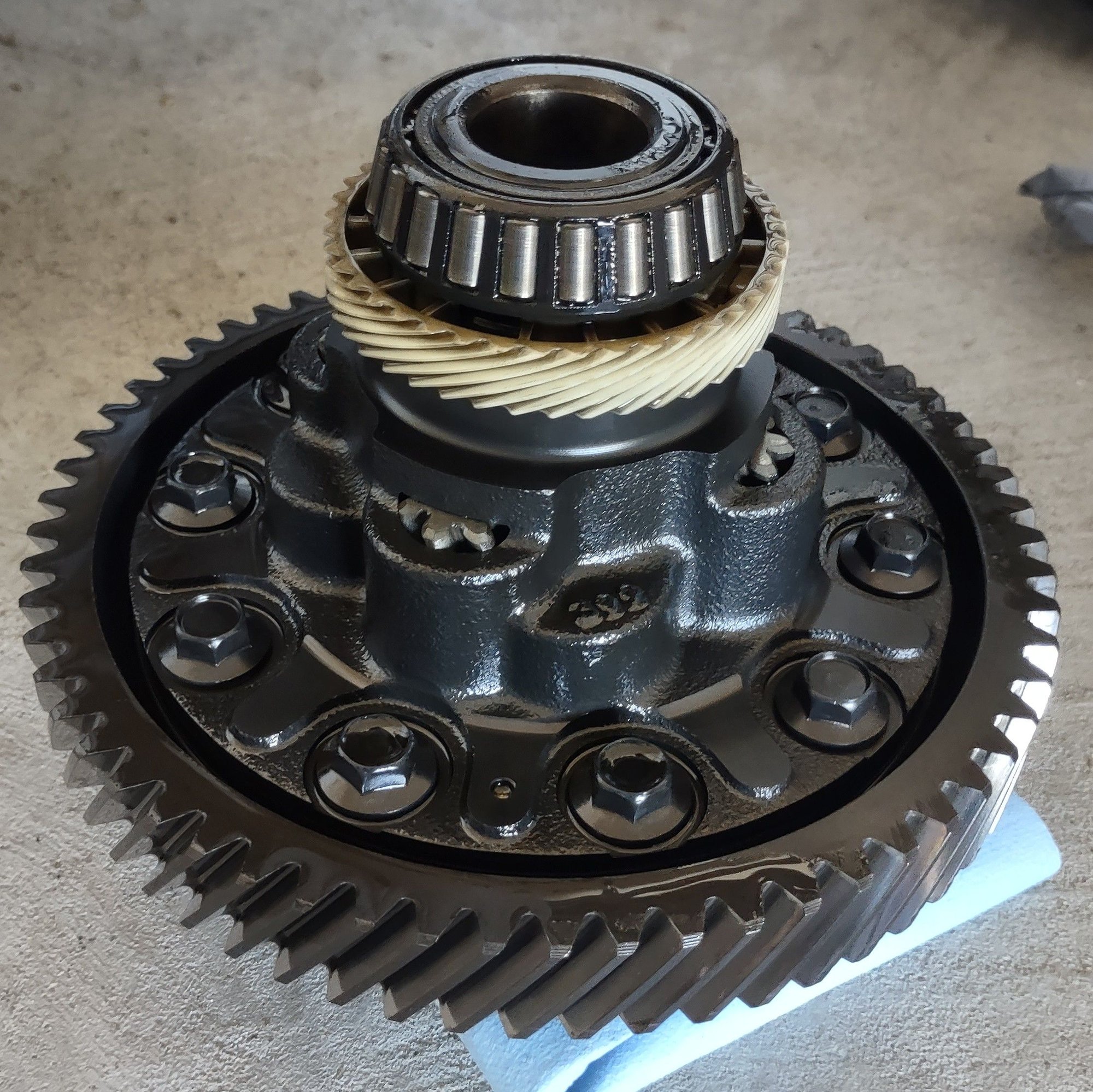

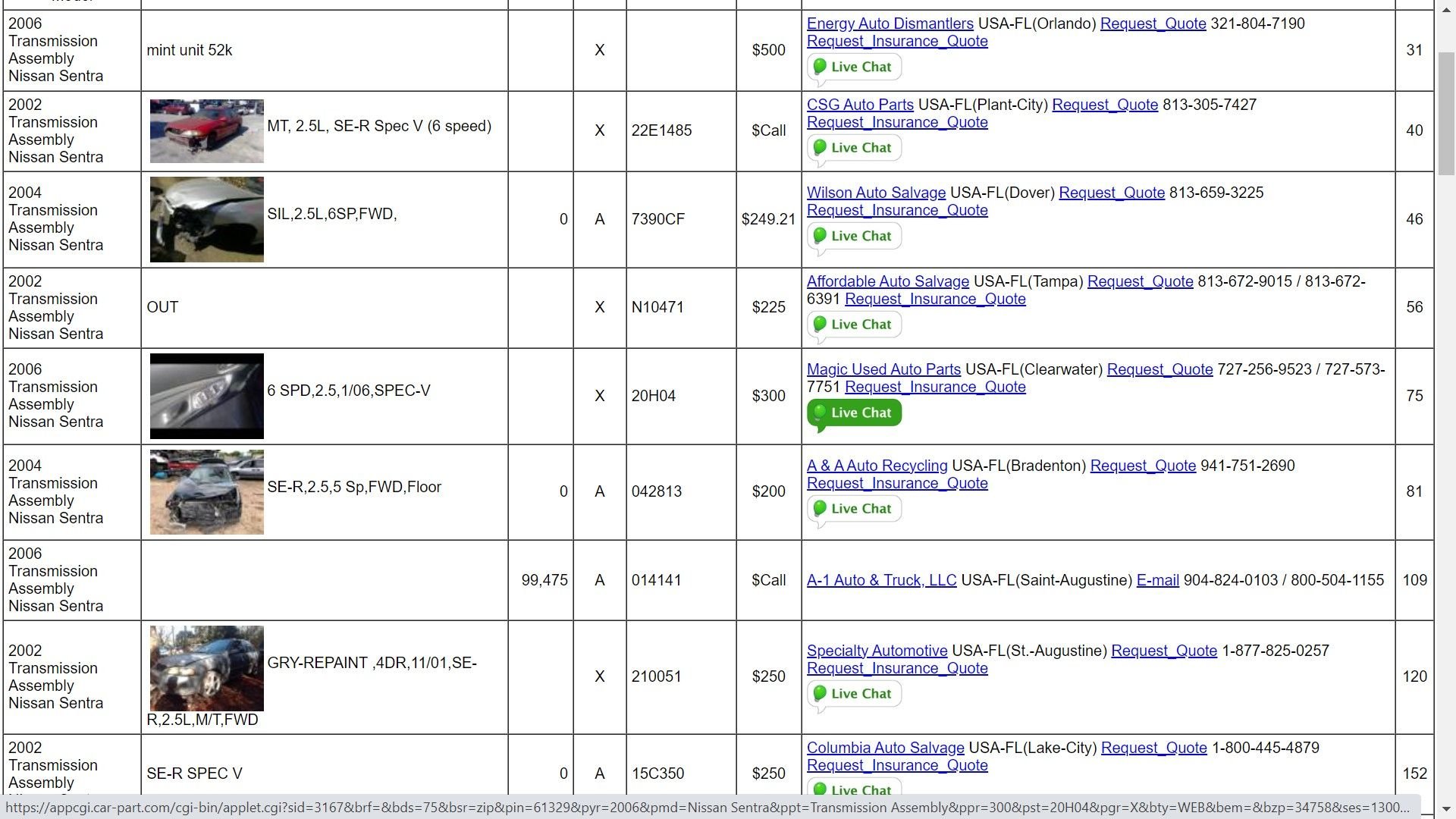

when I was looking, the best option was the helical LSD from the 2002 - 2006 Sentra SE-R Spec V. I went on www.car-parts.com and found a donor tranny for $350. most people change to the Spec V's closer gear ratios but I kept the stock Maxima 6 speed gearing. I've had it in my 02 6 speed Maxima for over a year and it works great. as you can see in the picture below, the Spec V trannys are selling pretty cheap in the salvage yards near me..

yes, the LSD in the 2002 - 2006 Sentra SE-R Spec V shares the same part number with the factory LSD that came optional in the 3.5 6 speed Maxima's

Just found this however ! Love carpart.com !
2003
Transmission Assembly
Nissan Maxima 3.5L,6MT,FWD,5Y774
Supposedly it is a lsd model according to carpart search engine

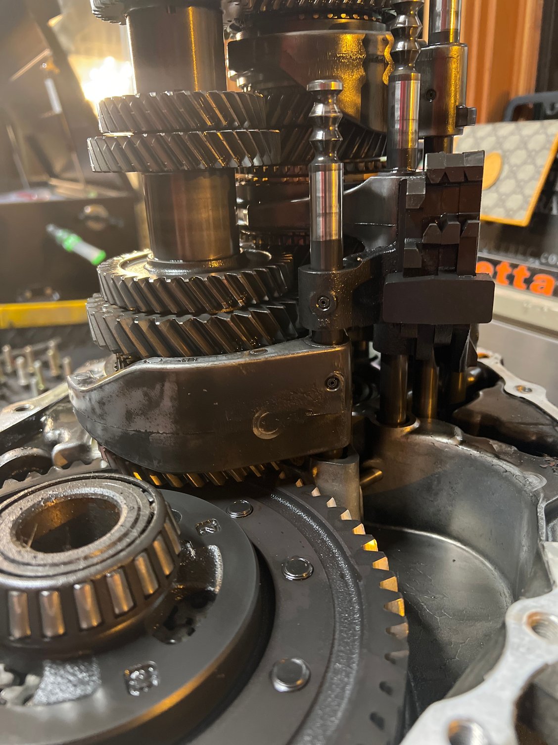

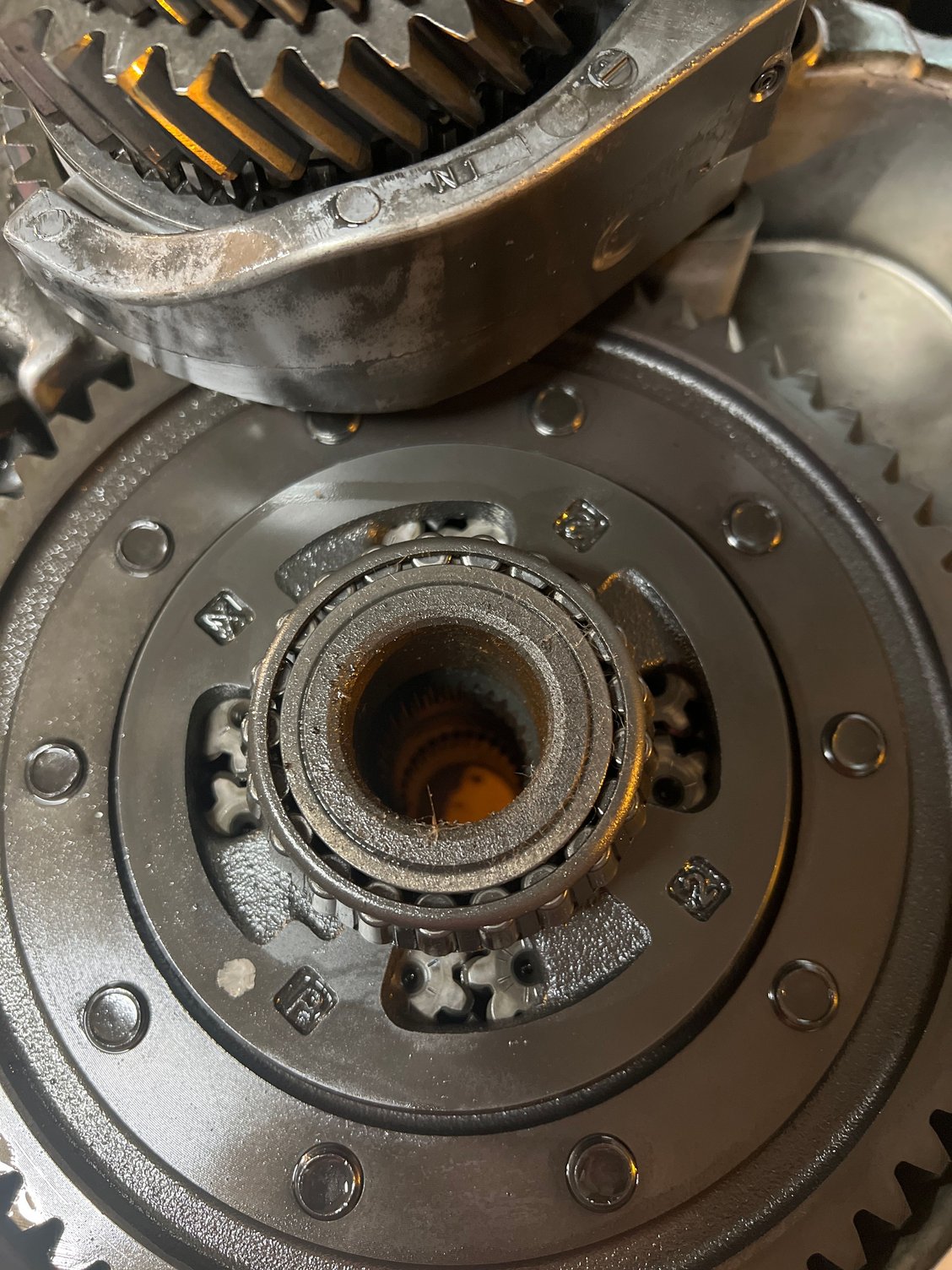

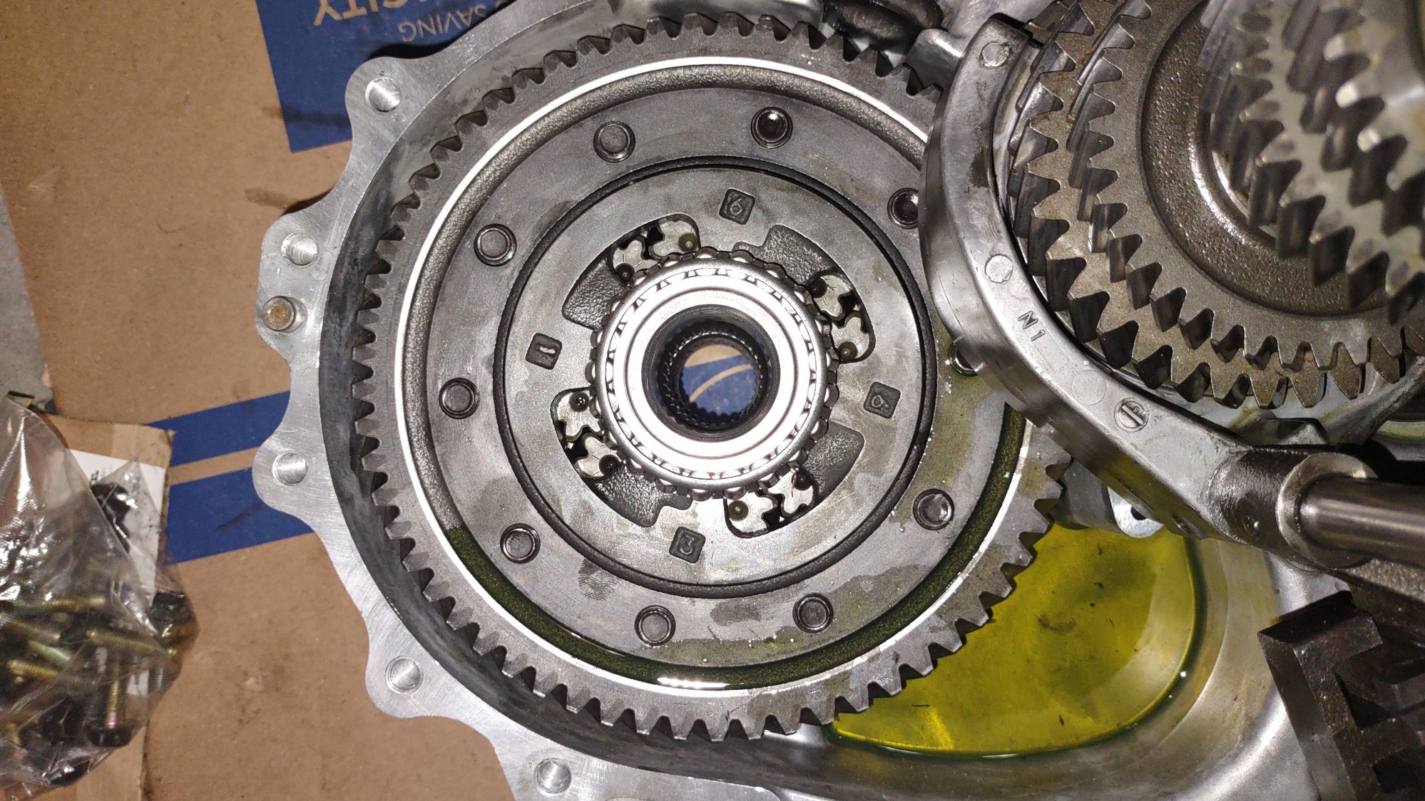

Finally got the box pulled apart !
This should be a 6 speed, close ratio box from a Sentra SER Spec V with LSD
Look correct ?
