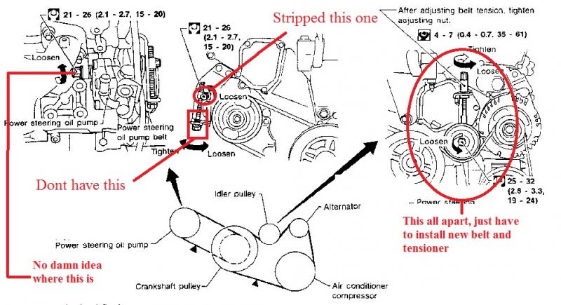

I tried starting with the belts since I thought that would be easiest thing to do. I was so wrong, I was battling with the top bolt for the tensioner for about two hours, i ended up stripping it
. I feel like an idiot cause I have no clue what I am doing wrong. Also the car does not have the tensioner bolt for the PS pump, will the pump just fall down once I losten that bolt and be a pain in the a** to put back up? I watched a ton of videos and read many posts on this but I am still confused. What can I do now with the bolt being stripped?

Let's start with the tensioner for the alternator/ac belt. A common mistake is that people do not loosen the lock nut. The lock nut is the bolt in the center of the idler pulley. You loosen the the pulley bolt and then you turn the adjusting bolt, the one that you evidently have stripped.
The power steering belt does not rely on the tensioner mechanism for the alternator belt. It has its own tensioning adjustment. It is convenientally hidden behind the power steering pump in an almost impossible to get to spot. You will get dirty on this one.

OK, I misunderstood what you stripped.
What I think may have happened is that someone did some work in the power steering pump area and Mickey Mouse'd it. You should have the adjusting bolt. Why it was thrown away is anyone's guess.
The bolt you can't find is the main mounting bolt for the power steering pump. You have to loosen that so the pump will swing/move. In the drawing you posted, that is a view from the rear looking towards the front. In the video at the 45 second mark, Pmohr is trying to point out where this bolt is. At the 58 second mark, the camera id focusing in on the end of the bolt. You see a bolt head but that is not what he is pointing out. Look to the 11 o'clock direction from the bolt head and you will see the end of the bolt you need to loosen. Go to the 2:20 point and that is where this bolt is being loosened. You cannot see that bolt, you have to feel for it.
As for the bolt you stripped, I can't recall if you really needed to loosen that one. But maybe you can get it loose if you use a 6 point socket or wrench.

Alright So I gave up on the power steering belt. I did find the bolt behind the pump loosened but nothing

I feel your pain main, I'm having a similar problem. Thankfully I didn't strip anything, at least I don't think I did yet. I ordered an offset wrench to help with the lock nut, hopefully I will be able to loosen the lock nut and get the tensioner nut lose because my PS belt is shot, it's coated in oil from *you guessed it* a leaking valve cover gasket. You would think getting the IM off and replacing that gasket successfully would be harder than changing a basic maintenance item, right? NOPE! Dammit Nissan. Never again. At least not until I have a Toyota/Lexus to drive to parts stores while my Nissan is on jack stands.
Edit: OMG completely missed that bolt in the back WTF they didn't mention that in the other video. Suppose I should have seen it in the FSM.

It's easier for most people to walk the belt on without touching the adjustment hardware. You place one end of the belt around the crankshaft pulley and then place as much as you can on the other pulley and rotate the pulley. To remove the old belt, you cut it.
