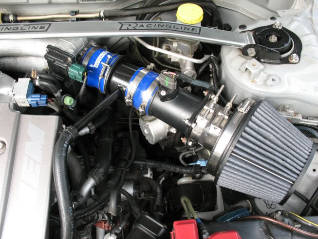

Build your own or Buy a JWT.... here's the part list
1. Velocity stack (BPI, Spectre or Vibrant):
http://www.bpi-us.com/stacks.php
http://www.jegs.com/i/Spectre/865/96...58#moreDetails
http://www.summitracing.com/parts/vp...FaVZ7AodliIAVw
2. 3" MAF adapter:
http://www.summitracing.com/parts/vpe-1997/overview/
3. 6" Universal Cone Filter:
http://www.aemintakes.com/search/pro...?Prod=21-209DK

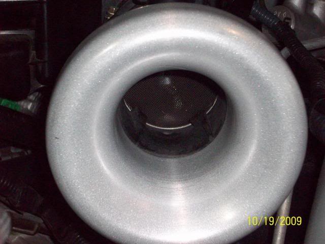

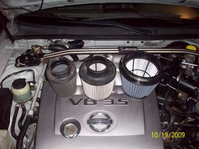

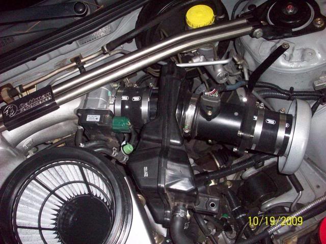

Here's my SRI using above parts list:
