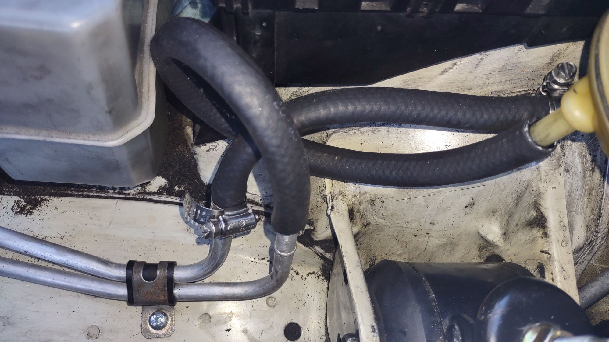

After further inspection it seems to be that the return hose (the one I am pointing at on the first picture) has radial cracks by the reservoir tank, so I would have to cut the tip of the hose, reinstall it and be done with it, everything seemed to be dry, granted I didn't turn on the car and check for leaks because I wanted to fix that first, but this was the only part that was leaking, after cleaning it with a rag fluid starts oozing out

PB blaster did not do the job and the adjuster bolt snapped, so I had to go to car heaven and get a "new" one, now the new belt is on and tight.
As for the power steering hose, yes, the hose I pointed in the picture is the only hose that was leaking, so I cut the tip of the hose, no more cracks on it. Re-installed it and filled up the fluid, turned on the car for a while to let it warm up and check the hose. After the car was warm I touched the hose end and there was a tiny bit of fluid coming out; but since I turned it off last weekend I've been checking it everyday and no sign of fluid coming out.
So, this leads to: when the fluid is warm it get thinner, thin enough to escape I guess, so what is next? My two options right now (since I ran out of time) are to get a clamp of the type that DennisMik said, or put a poop-load of silicone around it to seal the joint. At this point I don't feel like changing the hose anymore, next year. Any other suggestions?

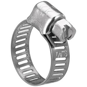

the low pressure power steering hoses tend to leak when the hoses get stiff. on my car I ended up putting new universal 3/8 fuel hose and new clamps. the clamps that come from the factory also lose tension so it's good to replace them with good clamps, even the ones for the cooling system.
the large hose that goes from the reservoir to the pump is reinforced so don't use a universal hose on it. I tried it once and the hose will collapse and restrict flow.

Uptown’s right. Replace the 3/8 hose & clamp. And drain / replace the power steering fluid with fresh if you’ve never done it before.
