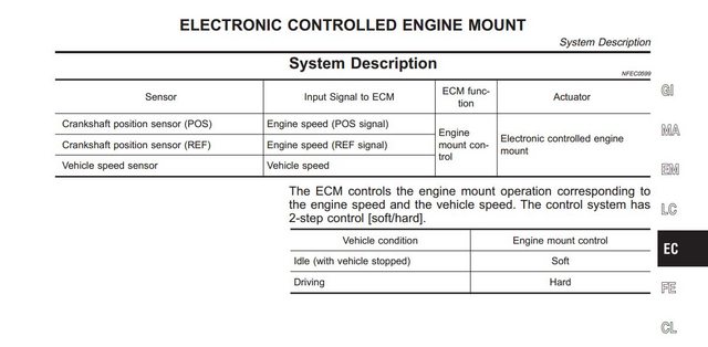

have you checked the circuit diagrams in the fsm to see if this can happen?
Old Nov 22, 2014 | 05:12 PM
eclivic's Avatar
Joined: Jul 2014
Posts: 33
Im VERY new to Nissan's, I'm a Mitsubishi, Chevy Owner so I am still trying to learn everything i need for this car. I don't know what to look at or where.

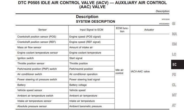

This should help
http://www.nicoclub.com/FSM/Maxima/2001/
