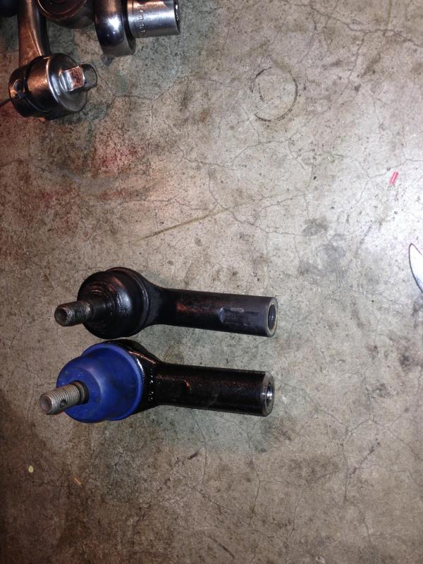

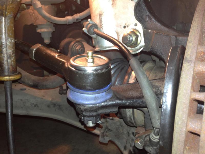

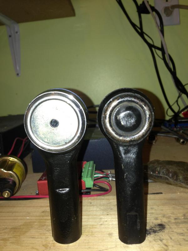

When I took the passenger side wheel bearing out, it was tight, no play, smooth, but nonetheless I replaced it. During the process, I inspected the ball joint and it was, to my surprise, very good tight and no play. I did replaced the tie rod end with NAPA brand which looks beefy and very similar or yet better than Moog brand.
bottom with blue boot is NAPA brand, top is stock

Pretty beefy IMO.
