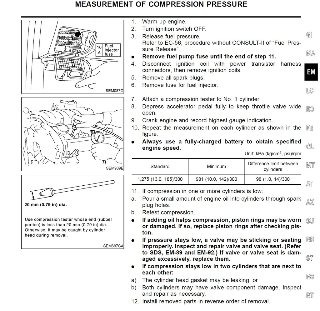

So just to check, on this motor, to have massively low compression (120, 100, 145) on three adjacent cylinders means either bad HG or bad rings, no? And nothing like having the valve cover off can mess up the test correct?

Old Jun 10, 2015 | 09:32 AM
NmexMAX's Avatar
dot dot dot ...
Posts: 34,576
From: Santa Fe, NM

HEY! Thanks a lot. On the vq35, one has to remove the intake manifold to get to the rear cylinders. In doing so, one would logically remove the throttle body. It seems as though I reached good (accurate?) numbers on the rear cylinders. Are you suggesting, I reinstall everything, and get the car running again before compression testing? Why would depressing the throttle matter if I have disconnected the TB? Can I just attempt the oil test as is?

Hmmm... I guess my last post didn't work. I did he test with the oil. After adding small amounts of oil into the spark plug chambers my compression went up close to 180 on all 3 front cylinders. So it looks like it is the Rings. Worst case scenario. I really appreciate all of the quick forum support.
