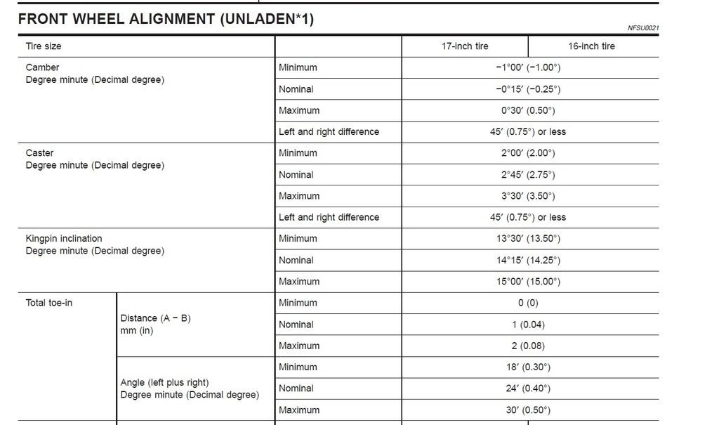

Can anyone take a look at my alignment sheet and tell me what they think? I tried finding factory specs online but no luck, still looking. This is for my 03 maxima se with 17 inch tires. I attached the results of the alignment.

http://www.nicoclub.com/FSM/Maxima/2003/su.pdf

Check out pages 14 and 26 of the FSM under SU.pdf for alignment specs.
Looks like Pep Boys did a poor job since things are still in the red post-alignment. The rear ends on our cars lack adjustable points due to the solid axle. The toe on the RR is out of spec so that means something's bent/damaged.
EDIT: NmexMax beat me to it
Not so much though, I just posted pics, but you elaborated nicely. Couldn't have said it better myself
