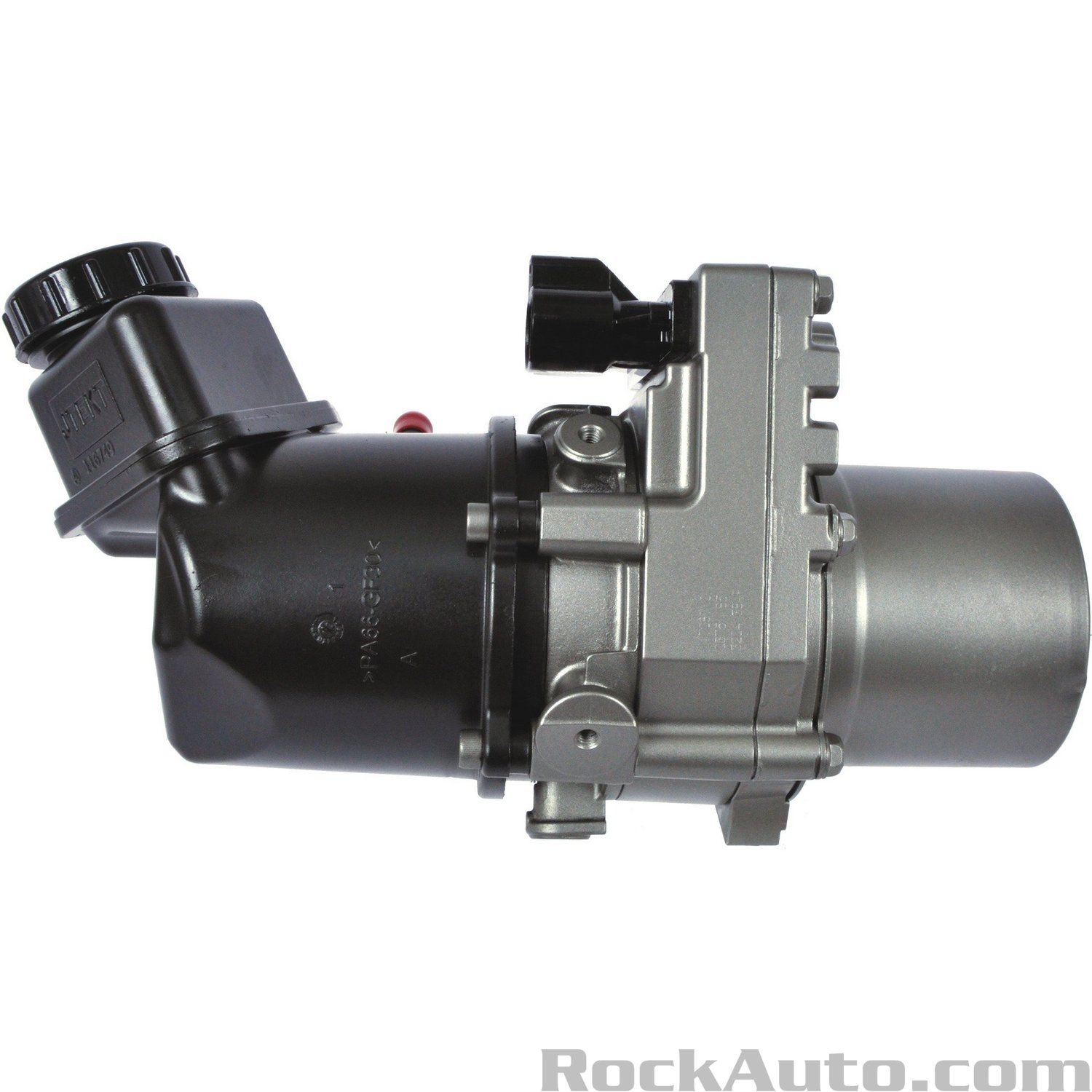

2016 Nissan Maxima losing power when steering from a stop
Hi guys. How about 2016 Nissan Maxima Sr when I turn to the right or left at low speeds the car wants to die and the power steering stiffens up does anybody have any input.
2016 uses an electric power steering pump, whole different ball game...
