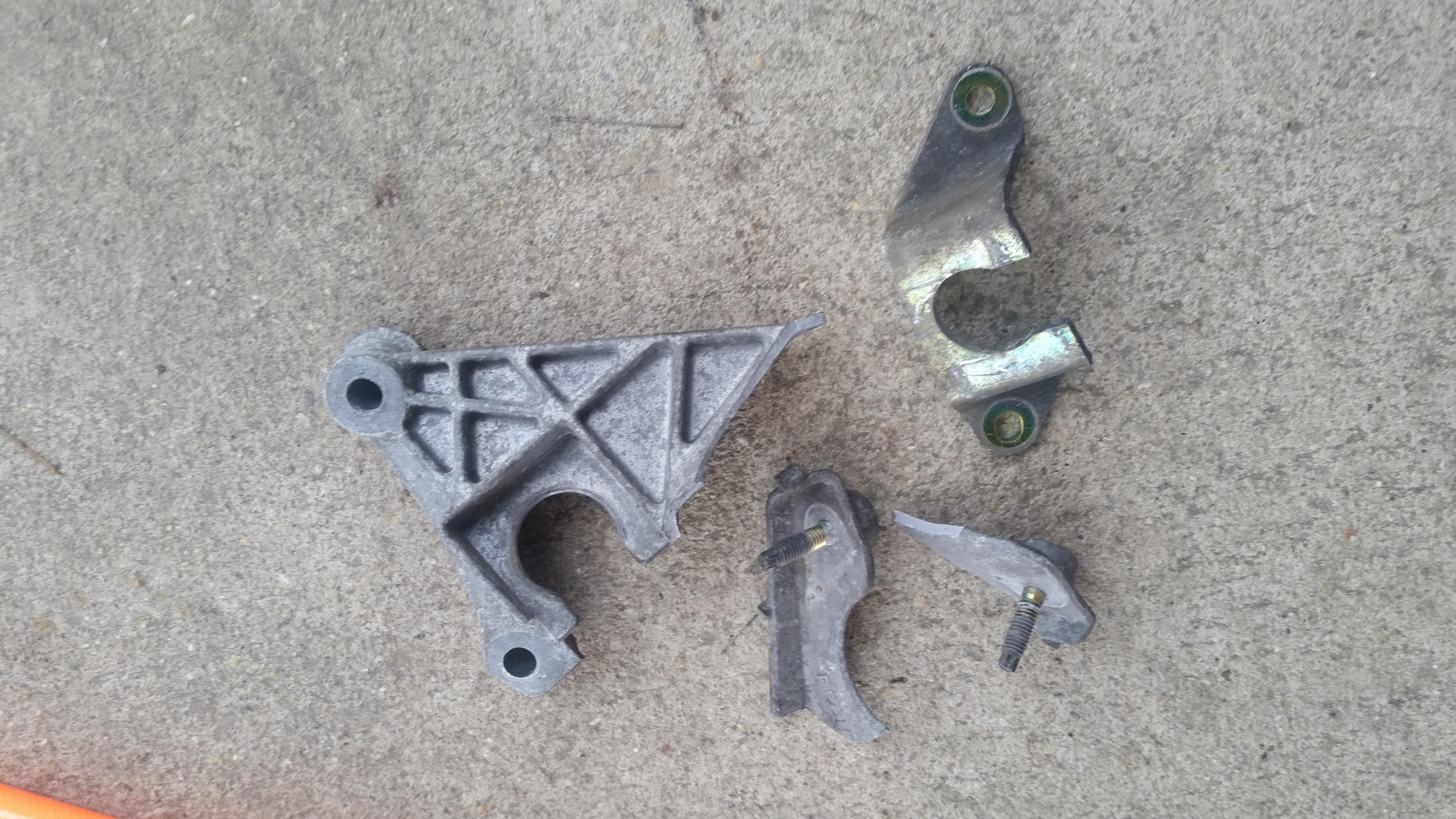

Ok on my way home tonight(went to get a quote for having the stillen front lip painted) Went to shift into 5th gear and my shifter went limp. No resistance at all. So I pulled over and opened the hood. The bracket for the cable before the cable goes to the transmission is broke in half. Is that bracket something I can get buy itself? It dark out and I really can't see it.
If so anyone have a link?

That bracket is a bastard. The 02/03 had a weak design that's prone to breaking. I don't know what availability is like but if you can find the part get one for an 04 through 06 Maxima. They made it stronger in the 6th gen cars.
This used to be a difficult part to get but I don't know how it is now. It will most likely be a dealer only part unless you can find one in a junk yard.
If you can't get the part you'll probably have to take it to someone who can TIG weld it back together and beef it up a bit while they're at it.
It's a bit of a ba$tard to get out too. If you have a set of flex head ratchet wrenches it makes it a lot easier.

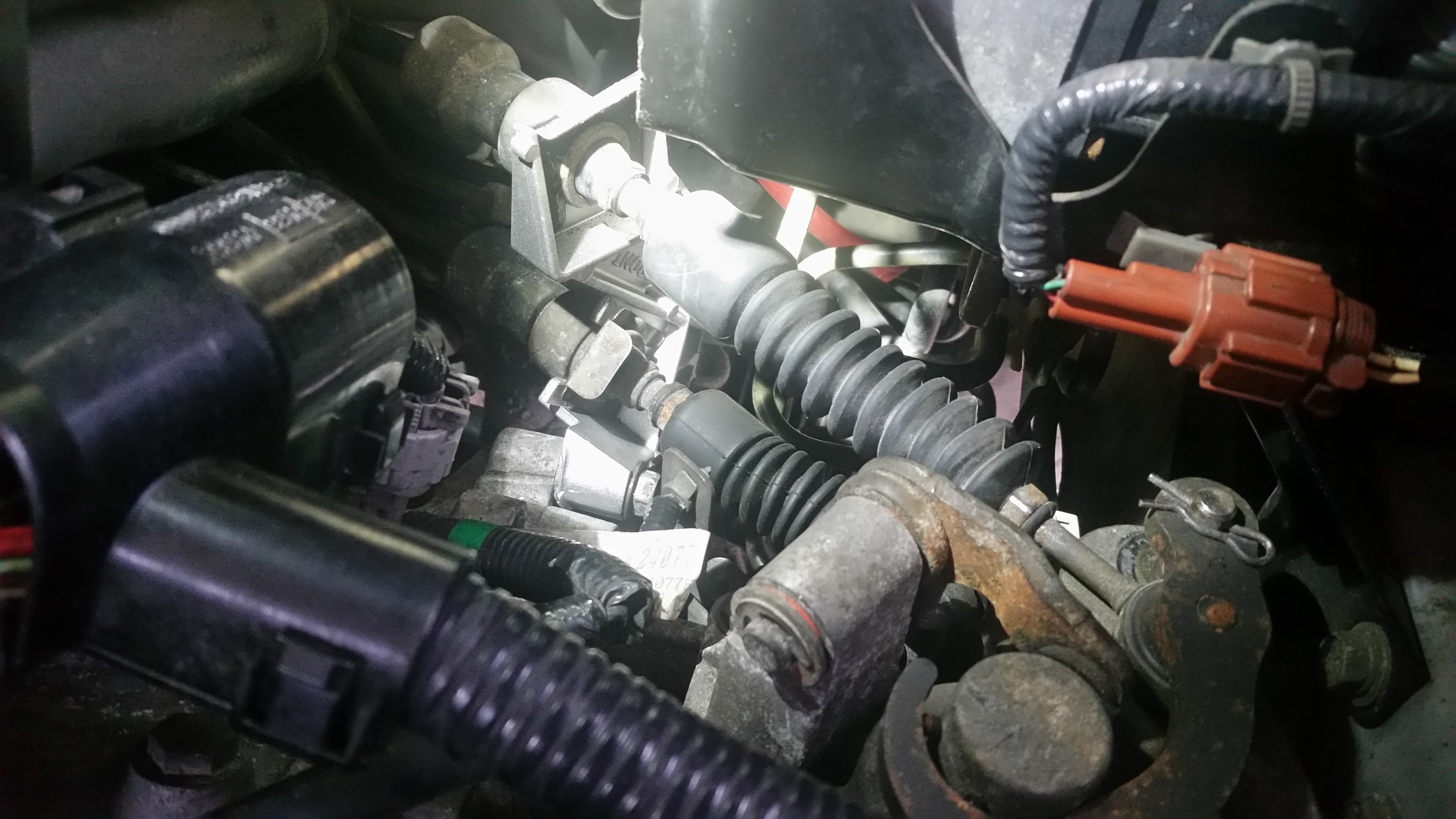

Got it installed today.
Wasn't to bad of a job
