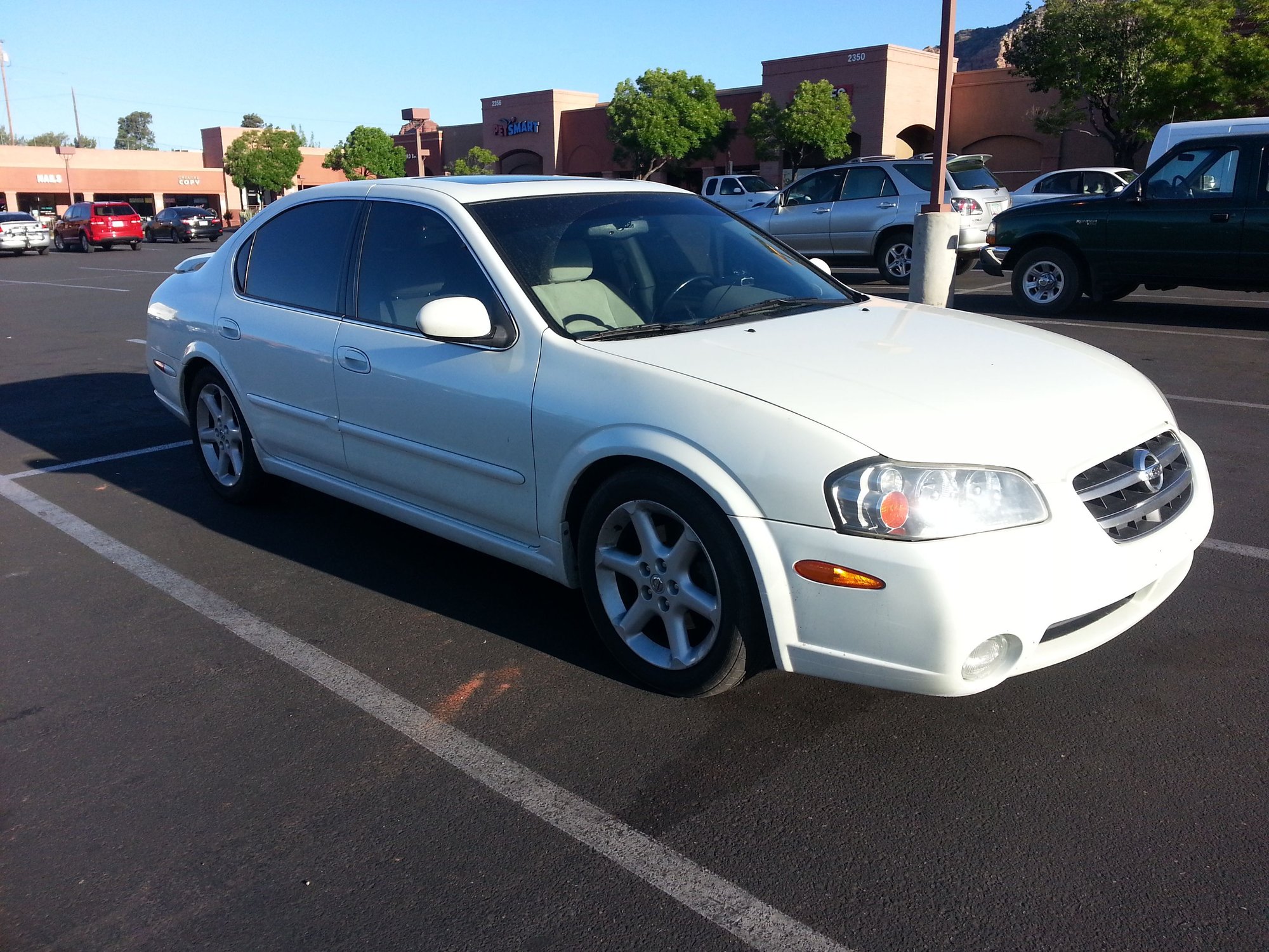

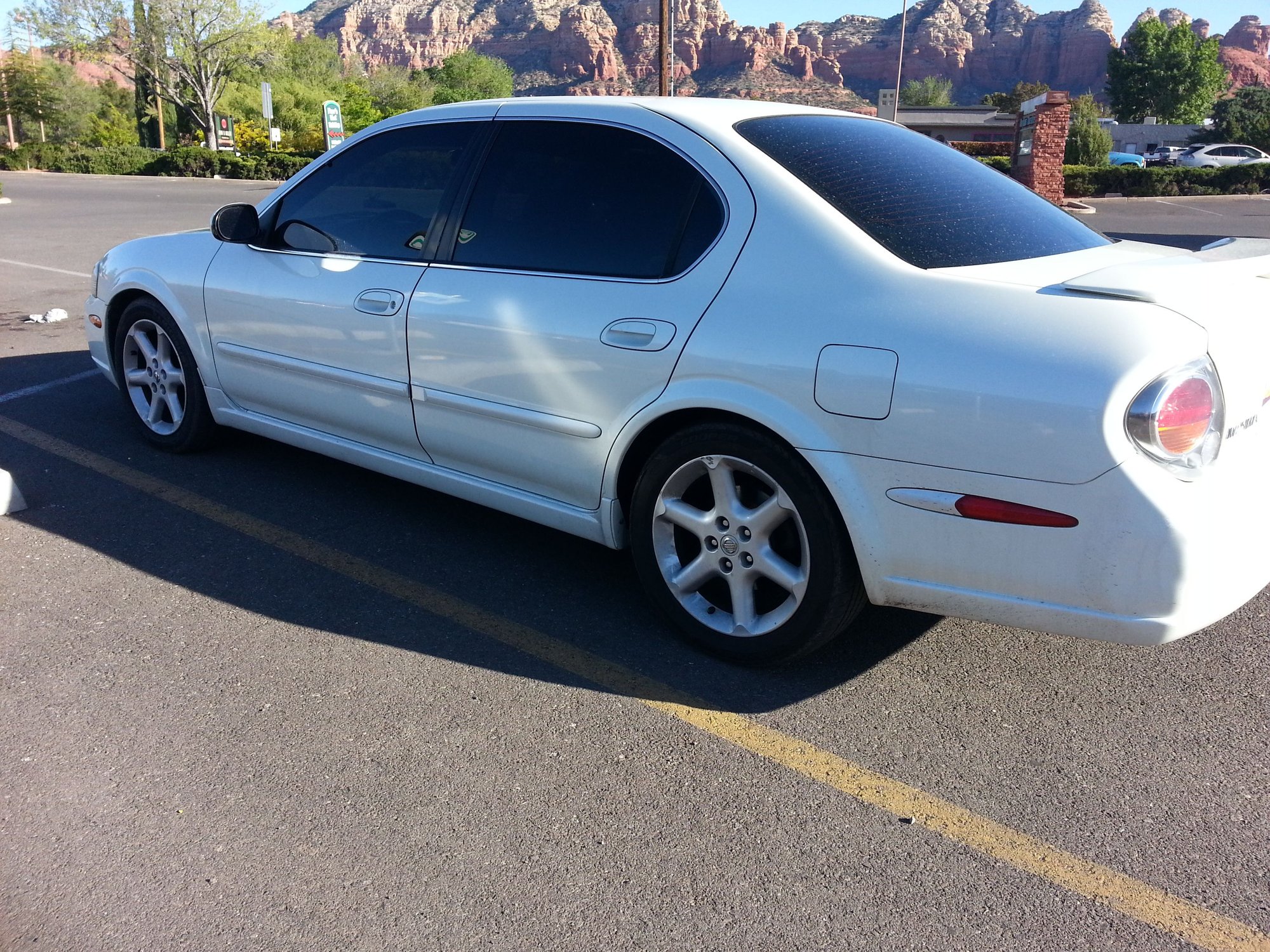

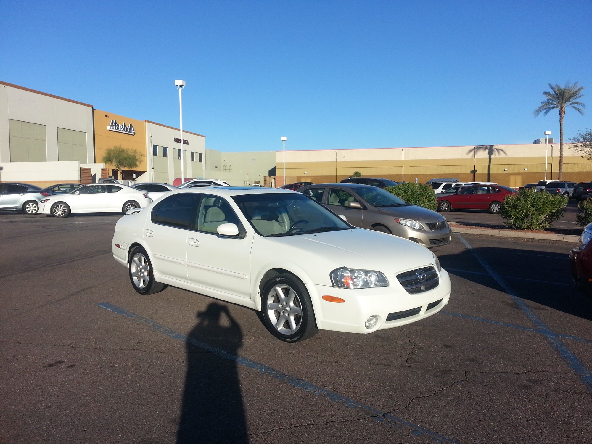

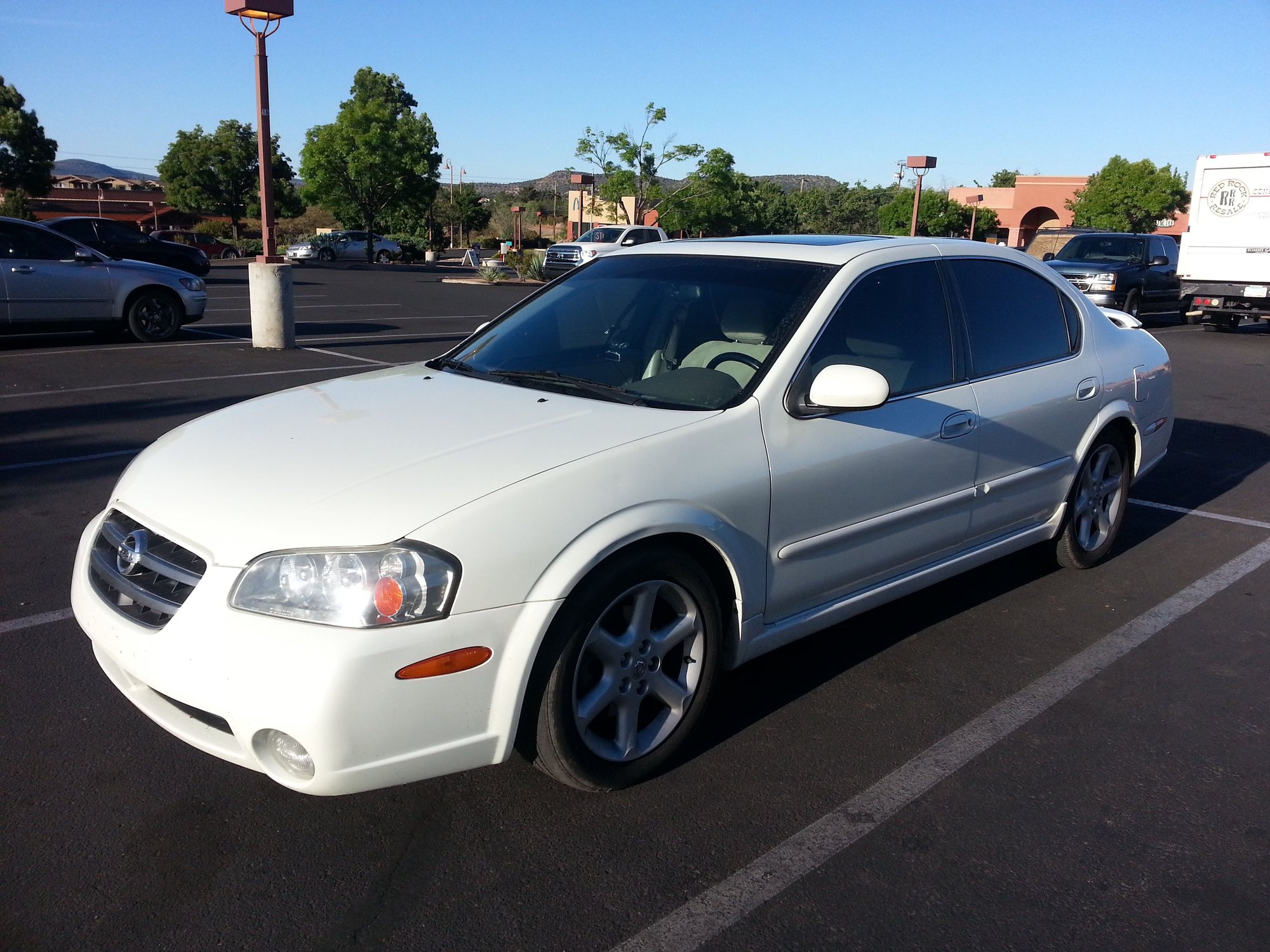

Before
Old Apr 19, 2016 | 08:15 PM
enterconnect's Avatar
Joined: Apr 2010
Posts: 33
After, not that noticeable.

How much of a drop was it?
Old Apr 20, 2016 | 05:04 AM
Joined: Apr 2010
Posts: 33
Maxspeed 1.4F 1.3R
