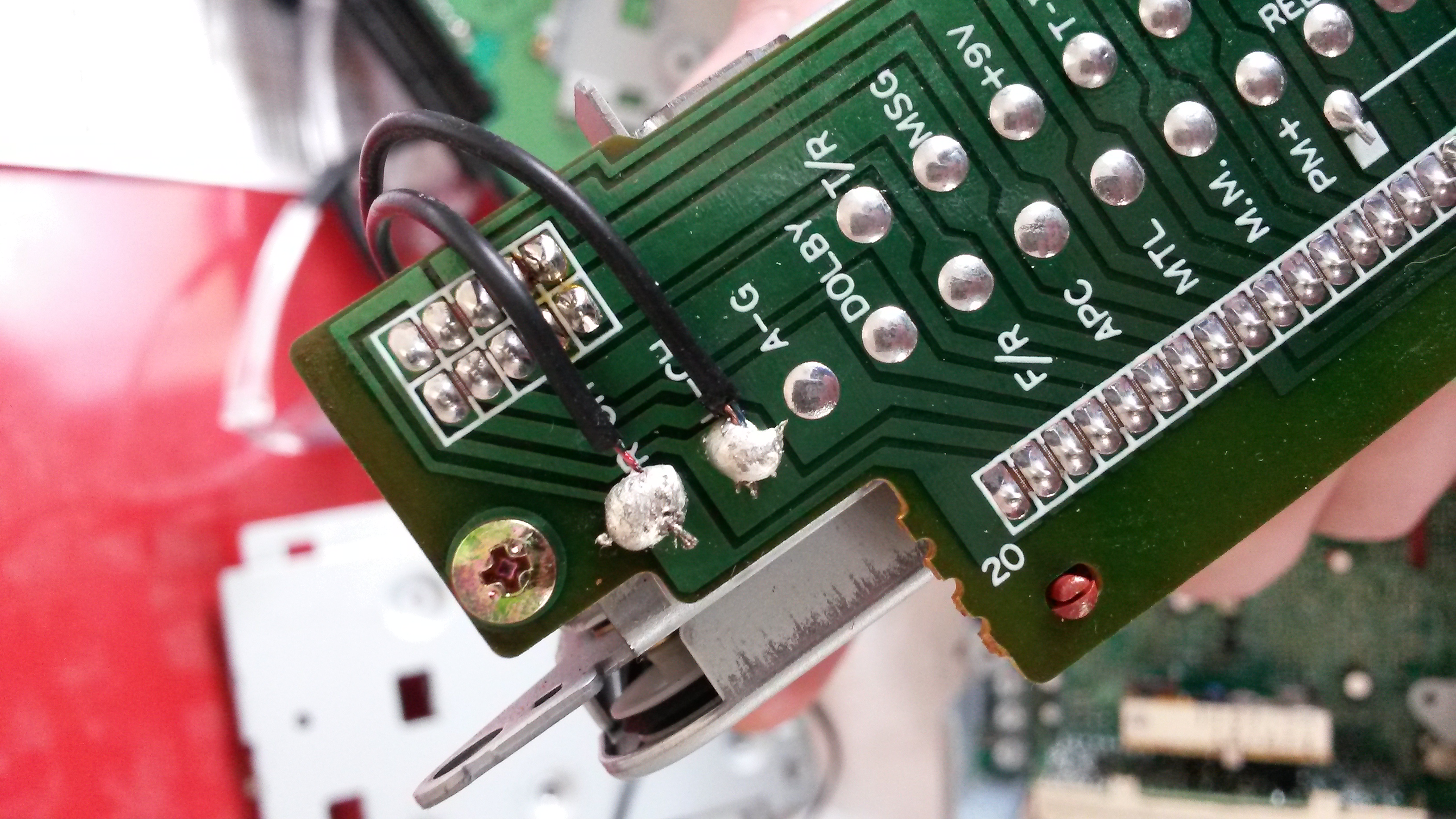

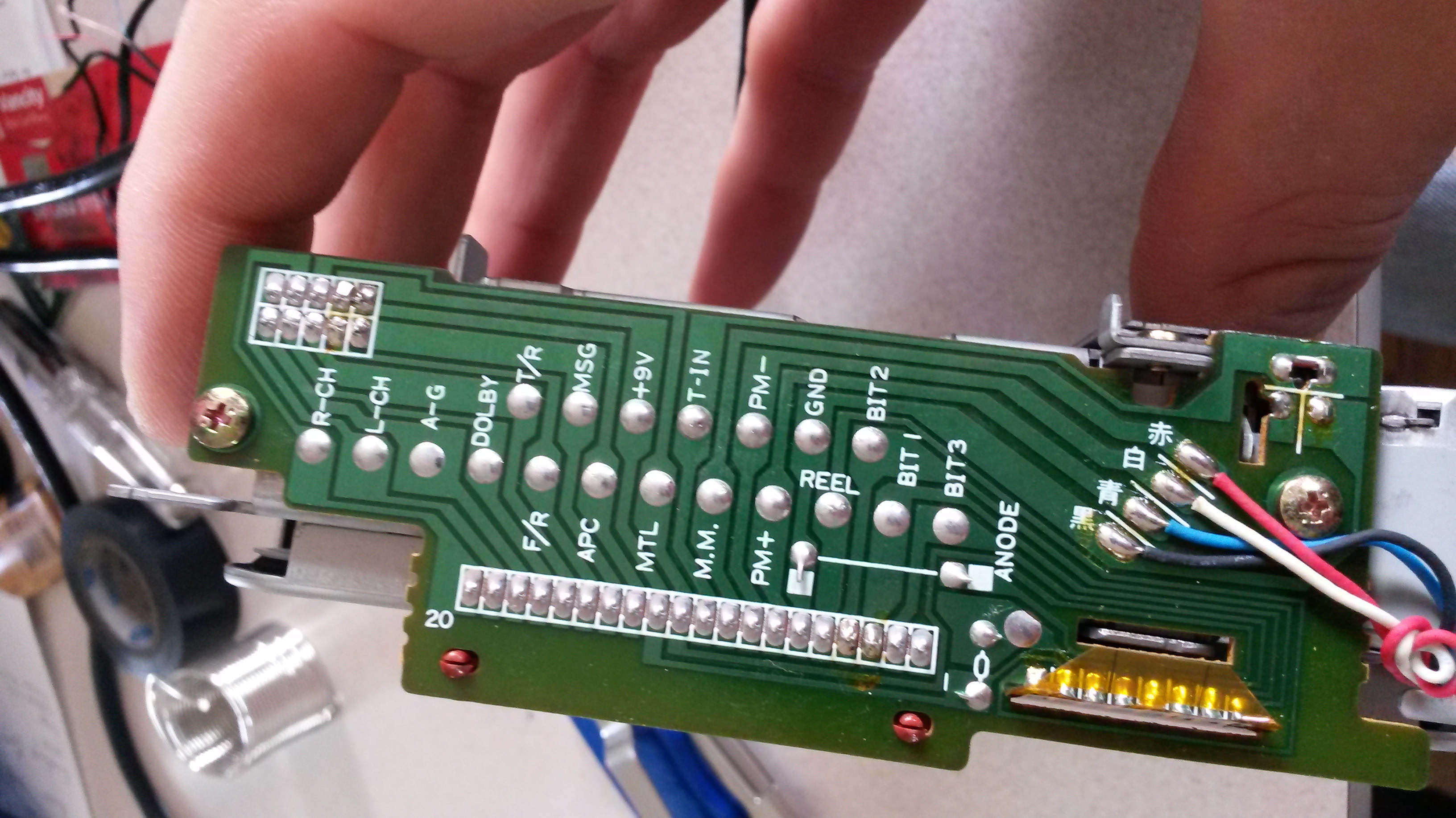

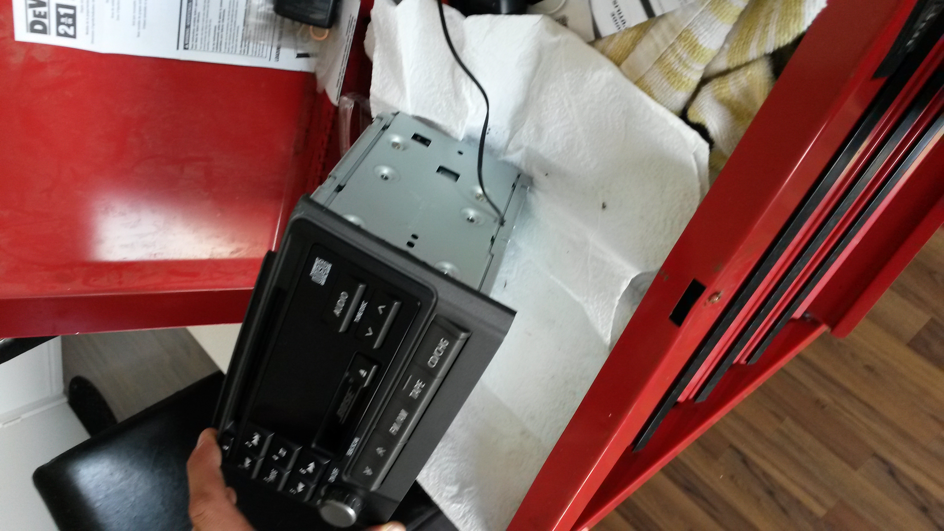

Turns out this was actually pretty easy. The 2001 Bose stereo is different than the 2002 that is shown in that video. I just took out the tape deck completely and found the L & R on it's board. Then had a tape adapter and took the cord from it and soldered it in. Reattached and fed the wire through while reassembling and the cord was just long enough for me to sneak out the back of the shift boot panel so I can have my phone in the cup holder. Used the actual Tape from the tape adapter to insert into the stereo to trick it into playing from the tape deck and TA DA
Thanks for the help guys and hope this helps/inspires. Total cost was $10 for the tape adapter btw.

I'm pretty sure that you're right about not pulling the gears. I'm pretty sure that there has to be some resistance for it to work.
Thanks man, give it a try. actually really easy. About 40 screws to get there BUT once you do, it's right there. You've just gotta go digging.
The actual hardest part about all this was taking the FU^#ING vents out. Man that was in there good. The audio quality isn't perfect but it's a DECENT(not perfect) hack.
