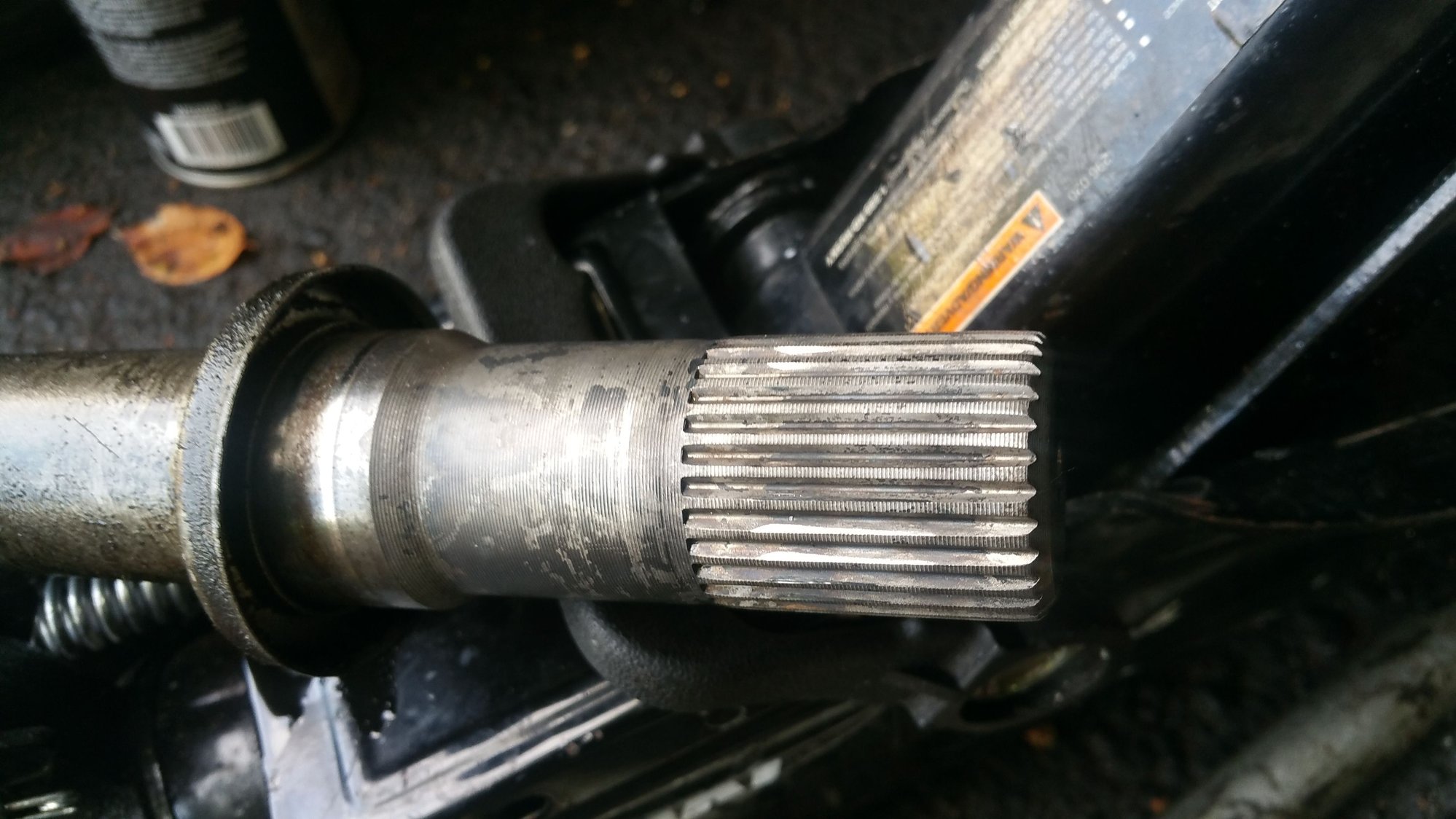

00 max gle, almost 200k. Car does nothing in any gear. Did some research and found out about worn splines and open differential. Did the jacking up the car to spin the wheels thing, but only 1 would spin at a time. Changed the pass side axle a while back so that's the first I took out to check the splines bc after I had changed it, I would get a jerking motion when I drive and would have to easy off the gas for it to stop. Happens every now n then. So I got it out the splines weren't worn, but a few of then looked slightly "shaved". Reinstalled and car is still the same, not even a nodge when u shift thru the gears. 1 thing that has me concerned is the noise I get from the tranny when I put it in P to turn off the car. Kinda sounds like when u pull up the hand break, this would only happen in P. I have to put in N to turn off then P bc Idk what the hell that noise is and don't want to do any more damages. Tomorrow I have to do the driver side axle to check those splines.

See the shiny edges on the splines?

Dan, those shiny edges likely are from when you slid the shaft out of the transaxle. There isn't something that engages with those splines that could be out of adjustment and causing problems -- the shaft slides into a splined spot (say that a few times...) and stays there.
I'm going to guess that what you are describing would result in an absolute smooth splineness shaft where they all broke off or was ground smooth.

Yea, that's what I meant Murph. Like they broke off so there is nothing to grab and spin the axle.
