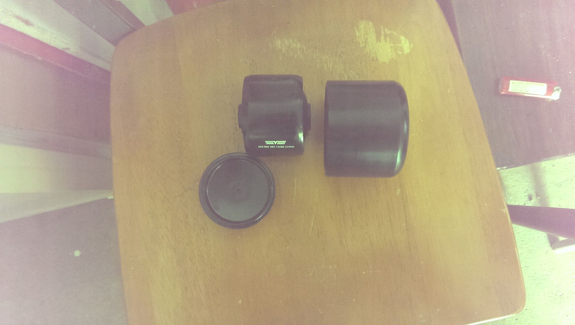

Thanks, everyone, for the replies thus far. And thanks for the photo journal. I've seen the Dorman & ES bushings on Amazon and couldn't really understand what the metal pieces were for on the Dormans. The photos cleared that up for me. And, yes, the replacement of the entire rear end for ~$2500 was really offensive and finally killed the relationship I had with my local Nissan dealer service department.

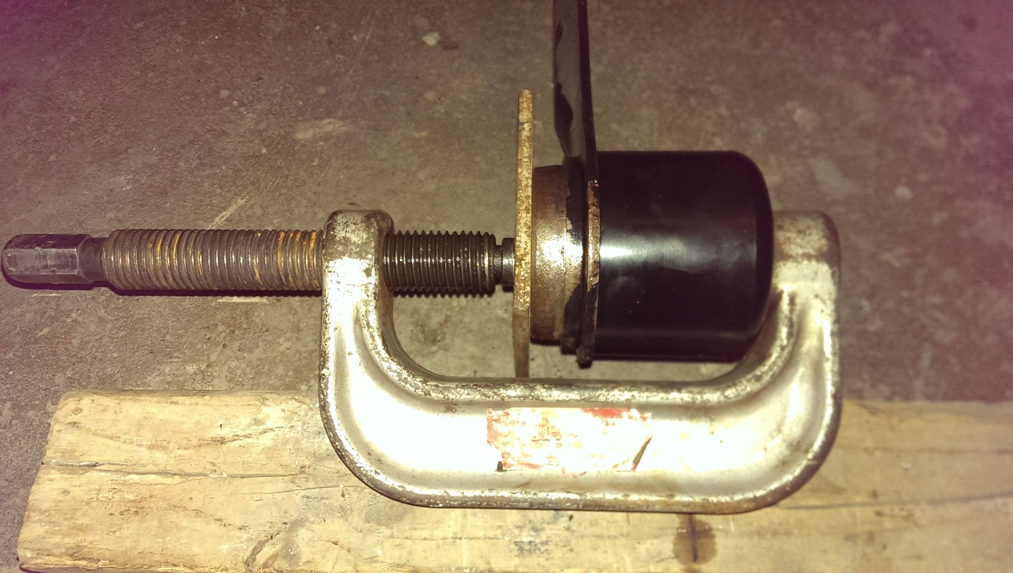

The ES is a little firmer in the rear end, but the tradeoff in precision of handling is well worth it. The actual pressing in the bushings portion is a pretty minor portion of the overall job, it's much more time consuming removing the rear end, removing the old bushings, and reinstalling the rear end than it is pressing the bushings. I did this myself and it took me several days to get it all finished. Mind you, I tend to take my time when working on my car, and I live up North where rust is a major issue to deal with when tackling something like this job.
To press in the bushings I used a large c clamp and a short portion of ABS pipe which I was able to fit over the outside of the bushing housing.

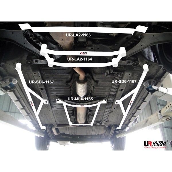

blehmco ltb stage 2, ultra racing lower side bars (think sub frame connectors but bolt on),
heres a pic for reference (ur-sd6-1167), and tho its slightly topic you could bring it on topic, showing how close these bars connect to the body at the trailing arm points !
