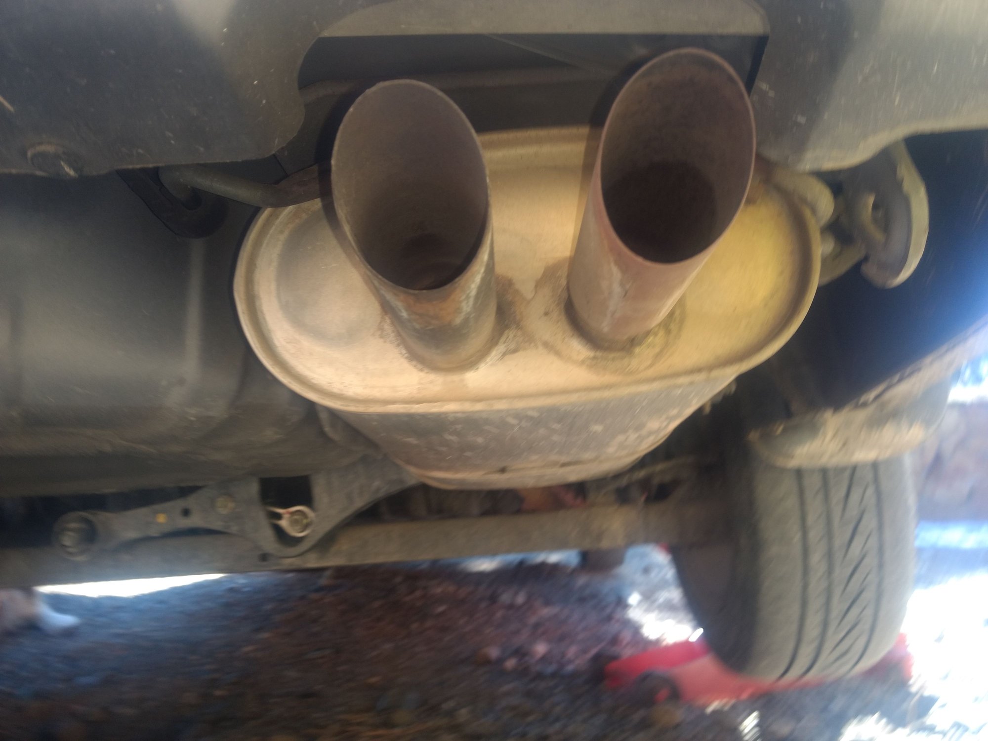

Awesome thanks for the quick response. I definitely have a 2000 it was made on 9/99. And I definitely have two tale pipes coming out of the muffler lol? So I don't really know what that means? That is a good idea though I will check that today. Is that a common problem on these cars? I've just never heard of a muffler clogging. I was thinking that even if the cylinders weren't firing there still should be air being forced out correct? My driver side tale pipe is on the verge of sucking in...nothing coming out. Anyone got any pics or even just a discription of that passenger side relay box under the hood.

The muffler has one pipe going in and two coming out. The pipes don't relate to anything specific at all. I think if you rev it up you'll find it flows out of both pipes.

I believe that this is normal when you are at a low rpm. https://streamable.com/f07ad .
I have found a thread on this https://maxima.org/forums/5th-generation-maxima-2000-2003/347654-noticed-today-i-only-have-exhaust-coming-out-one-muffler-pipes-wtf.html .
"a new variable capacity muffler derived from the one on the high performance Nissan Skyline GT-R. A special muffler flap valve, using high temperature aerospace spring technology and materials, opens at 2,000 rpm and above – reducing exhaust system backpressure"

Awesome thanks. I'll change the signature for sure. Found one white don't on one of the rear coils. Taking the front cover off now. Looks like at least one has been upgraded. I don't think I have that muffler. No exhaust comes out at any rpms. Plus the real problem is no power feels like it's running on three cylinders. Can't climb hills in anything but first gear.

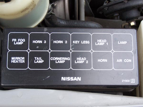

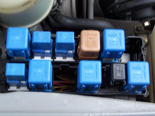

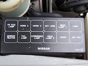

Here are photos of the passenger side relay bank for my 2000 Maxima.
Also, you can download the FSM (service manual) from here: http://boredmder.com/FSMs/Nissan/Maxima/
In section EL, scroll down the index towards the end to the "Electrical Units Location".
For a 2000, it is page 340.
For a 2001, it is page 353.
For a 2002, it is page 349.
For a 2003, it is page 453.
In the future, please tell us what year your car is. There are differences in each year.
Attached Thumbnails Lots of questions-00max-right-relay-cover.jpg   Lots of questions-00max-right-relay-bank.jpg

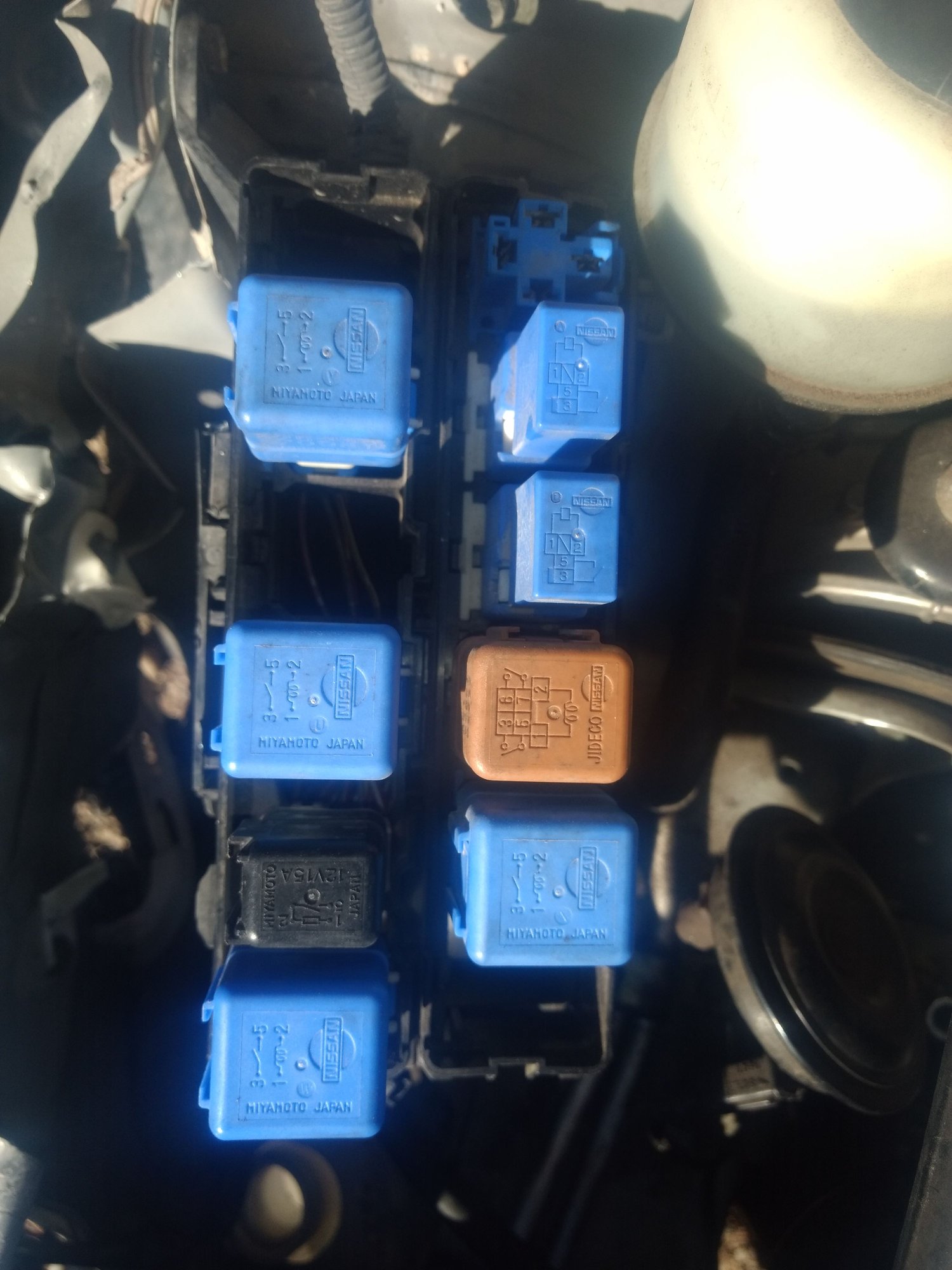

I should have a signature now that shows my year. So it doenst look like the relays on the passenger side are my brake light problems. Any ideas? I've got power to the switch and have jumped the switch with nothing for brake lights. Is there a brake light relay?

Well do i have the NASA inspired muffler? I don't think this is the problem but ya never know?

In the fuse block between the battery and the fender, there is a 15 amp fuse for the ignition coils. The cover calls it ENG CONT 1.
The power then has to go through a relay energized by the ECM. This relay is in the bank of relays in front of the battery. The cover labels it ENGINE CONTROL.

I did unhook the plug and was getting nothing so I went for the stabing of the wires. Gotcha how can I check those relays. Is there an easy way?
Old Jan 3, 2018 | 07:59 PM
DennisMik's Avatar
Posts: 10,644
From: Plano, TX
Easiest way is to swap the relay with one of the others that is the same color. The relays right next to the Engine Control relay are for the radiator fans and are a safe swap.
