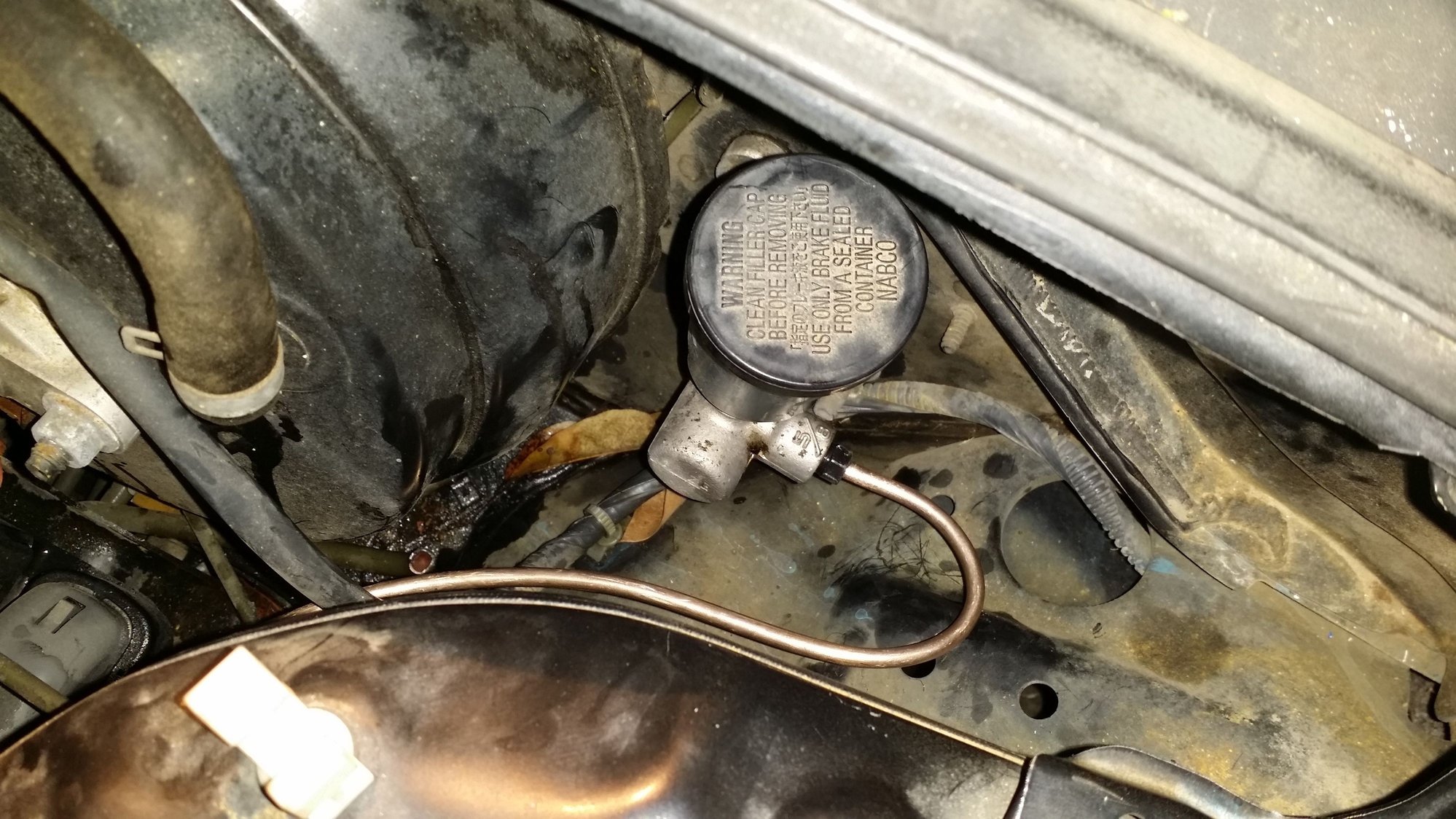

I got a brake like tubing from Autozone instead of the braided line you guys suggested. I really need to get this wrap up in a couple of days, it’s been way too long.
It has M10 X 1 which is what the OEM fitting we’re on the master and slave junction box.
Got a new master and slave cyl as well. I’m going to mock up the line with coat hanger before to proceed with bending the real brake line tomorrow.

Went with Nicopp Brake line per Korn suggestion and it was a breeze. It was easier to bend as you fish it around. I basically moved and bent the line as you go along the path till it gets to the Master cylinder. It got pretty tight thru the master cylinder. I bought the 40" long line and it's about 8" too long. The 30" would probably be enough.
Bled the line in 20 minutes from dry condition. Not much difference in term of clutch feels, still suck as before but its working great now.
