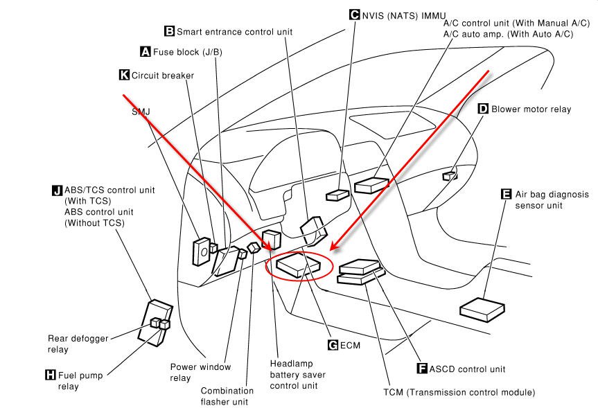

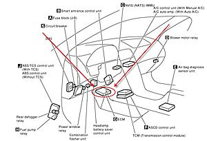

Does anyone know where the ABS control unit (listed as J in the picture) is or what it looks like?
