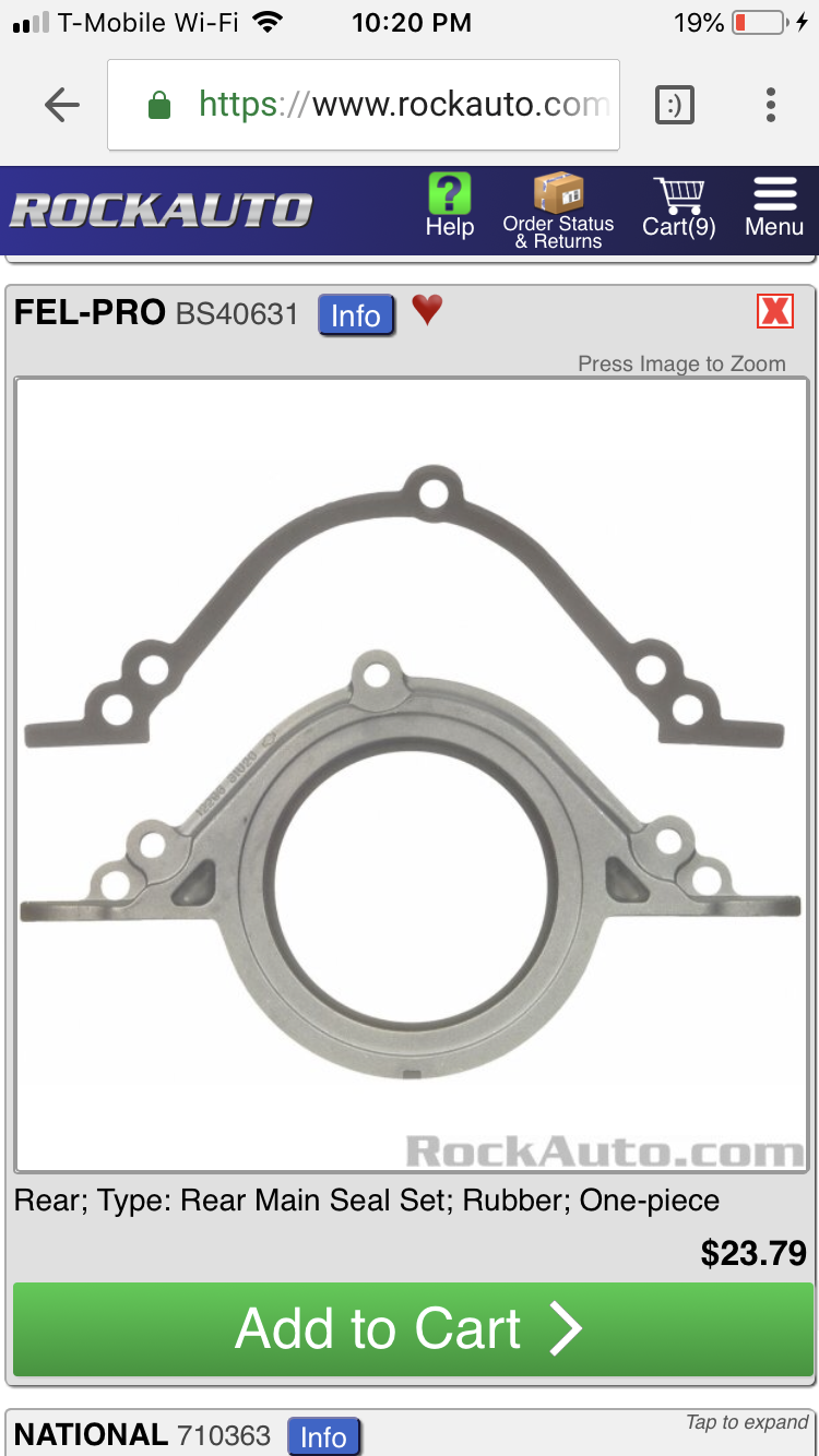

The seal comes with a plate and gaskets for the plate. The seal already installed in a plate that lives between the block and upper oil pan. The whole plate gets replaced. If you go to rockauto.com there'll be a picture of it.
Just make sure he uses a good RTV for the upper and lower oil pans and not the crap that comes with the seal kit. Neither pan uses a gasket and relies on good RTV.
This?

Old Aug 16, 2018 | 09:39 PM
Derrick2k2SE's Avatar
Posts: 2,501
From: Pensacola, FL
Yeah. that looks like it.
There might be another "half moon" gasket that goes on the bottom half circle but I can't remember.
