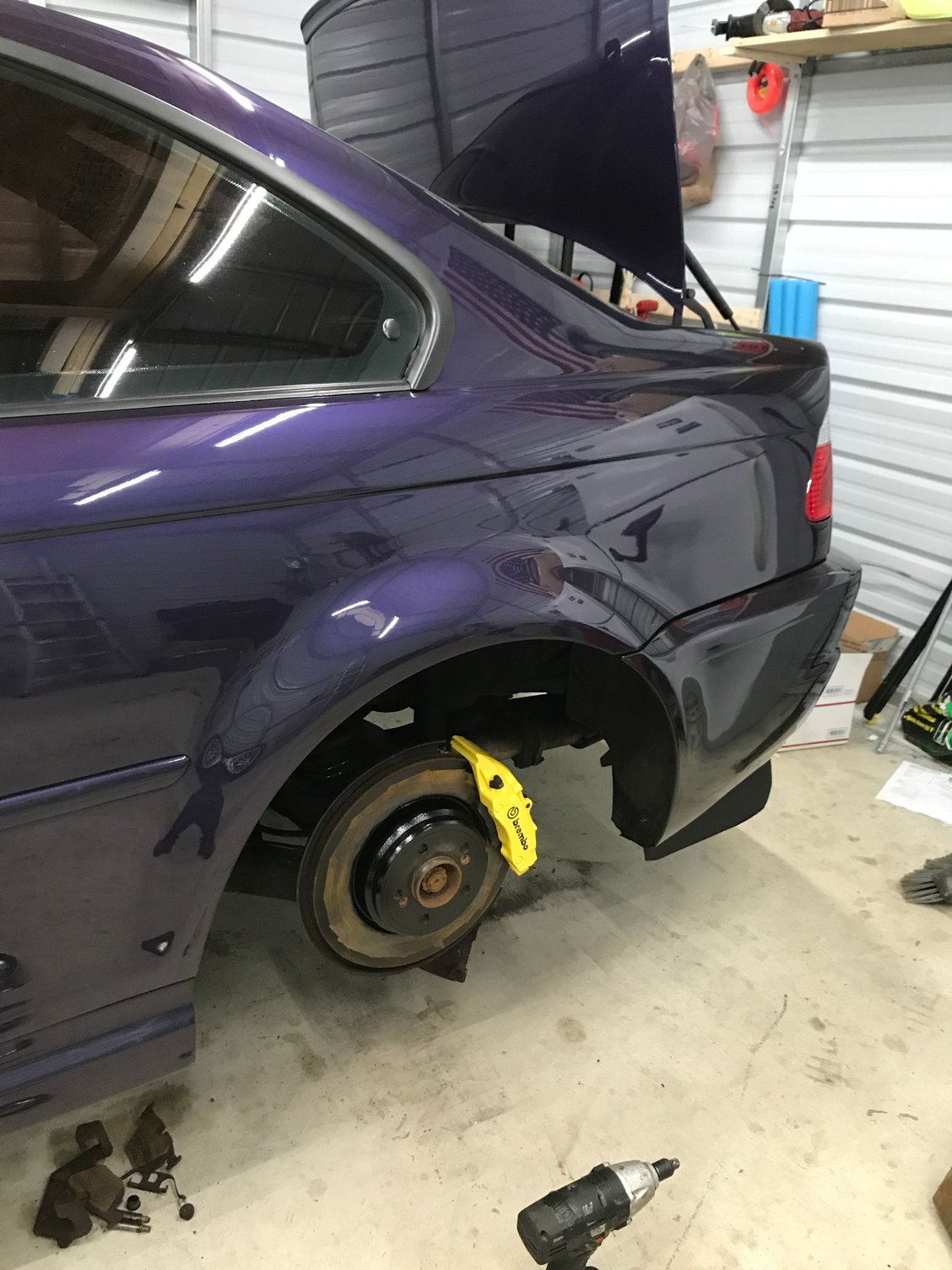

the pictures or from your bmw not the 5gen btw.
That would be pics from a post 3 or 4 down explaining why I put brembos on my 5th gen, if you read the quoted post a few under it . Starts with “mainly because”
Pics go with that

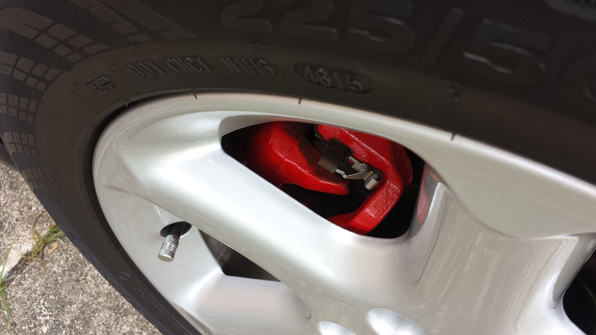

For freezer,
2009 350Z dual pot 12.6" I'm running now.

Nevermind the rust on the rotor edge. I cut those rotors down a few mm to clear the calipers. You won't have to do that and I'm actually going to correct that by removing material from the calipers then replacing these with that new pair of the same, coated Brembo blanks I fitted up with the 6 pot in my thread. Cutting the rotors was dumb and I regret it. The coating on these blanks never rusts and it was all cut off with the machine work. Very little has to be removed from the calipers to clear. This is all plug and play, and cheap, btw. $100 for rotors, $160 for calipers. Pads of course can be whatever you want.

Originally Posted by freezer
Your ugly stockers (same as mine) are hiding the most important part of the calipers
Do they look like this? https://maxima.org/forums/7th-genera...l#&gid=1&pid=1
This better?
