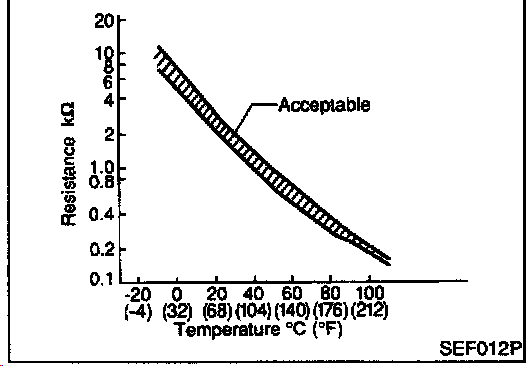

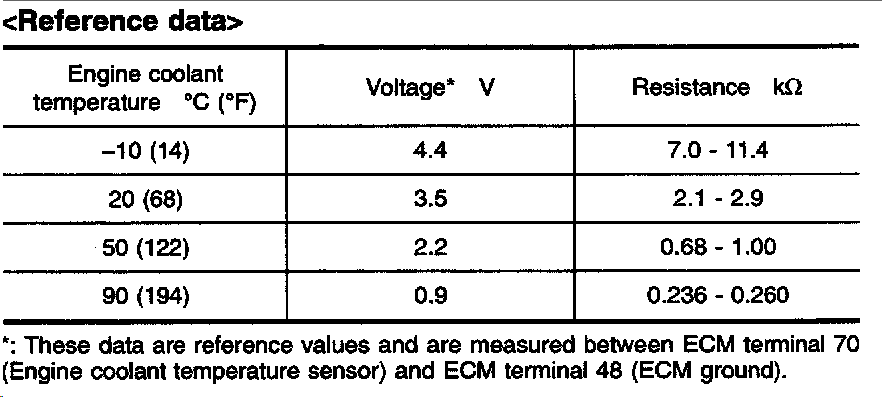

If the temperature stays normal when the a/c is on, meaning the fans are running all the time, this seems like a fan turn on problem. I have to go with Child_uv_KoRn on the coolant temperature sensor (ECTS). You can measure the resistance in the morning before you start the car. Just unplug the wire and meter across the 2 contacts in the sensor. At 68º F, the resistance should be 2.1 to 2.9K ohms. If the temperature is colder, the resistance will be greater. 50º F will be around 3.5K ohm. An easier way is to use an OBD reader. It will report the temperature as the ECU sees it.
