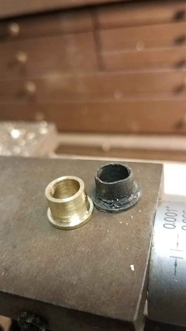

The bushing that sits in the clutch pedal arm that the clutch master cylinder gets hooked on to is half broken. Been trying to source it online but they don't seem to have the drawing for it. Does anyone know if we can even get that bushing anymore?

I don't think they make those parts anymore. I seem to remember discussions on this in the past.
I just made one out of brass using my small metal lathe. It works great.
I still have the specs written down. I can make one for you if you cover a few bucks shipping. It doesn't take that long.

It actually dawned on me to check up on McMaster online so I did order like 2 bushings that I saw there, they're not exactly like the factory one but I'm gonna find out Tuesday when I get it. Otherwise, for sure I will let you know and I'll take care of the shipping and labor, thanks again I'll get back to you man.

Well, the closest bushings that I got were still too big so I drilled out the center and I also had to cut down the OD. Eventually, I got it to fit thanks to my drill press. I do need a lathe to be able to make stuff like this. I did start pricing a few out but other things took over my time and money.
