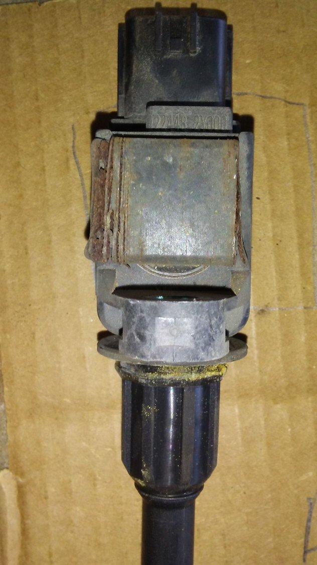

Well...I may have figured it out. I took the plugs put and replaced them..started looking at all my coil packs...2 out of the 6 are rusted pretty bad while another 1 possibly 2 could also be bad from less rust. Ordered a whole set..won't know till Monday. Happy wrenching.

Old Jul 25, 2019 | 10:23 AM
Child_uv_KoRn's Avatar
Bad *** Newb
Posts: 4,975
crank sensor? - you said it just cranked and wouldn't start (although true maf can do that, too lol)
There's two of them and they're infamous for going bad/getting dirty.
Driving symptoms sound like maf...what new maf sensor did you use?
