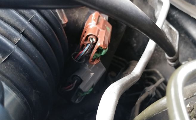

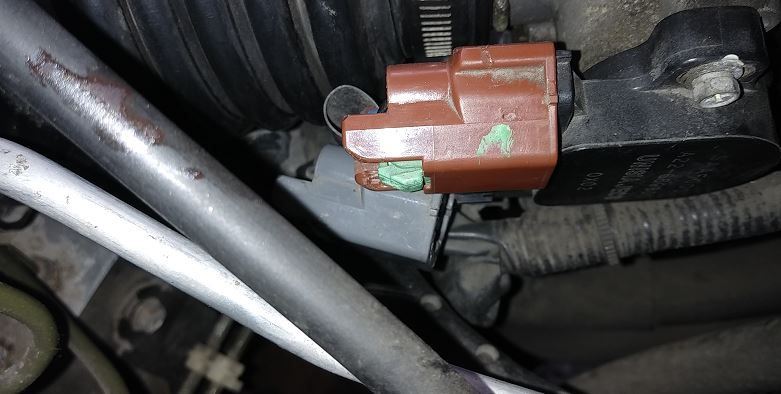

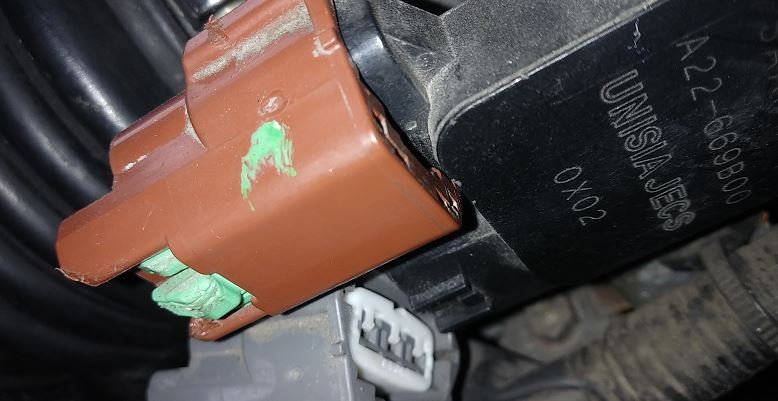

Dec 17, 2022 | 12:39 PM
well... after 6 months of suffering replacing all kinds of parts, i was beginning to lose patience and was about to scrap the car
decided to try one more thing, engine running, warmed up, start unplugging sh*t under the hood ! one by one, every single connector, unclick
sometimes the engine would die ... uhh... better plug that one back in... click so after a few hours at this i located the problem
Thank God
turns out it has something to do with the wiring from the grey connector of the TPS to the ECU, now i previously either disconnected the red one or both and that solved nothing
then somehow i got the idea to unplug only the grey one and problem solved, I could not believe it
I went through 3 TPSs and i checked all the signals from them with a multimeter and everything was in spec
my guess is when i got the P0505 fried IACV and fried ECU issue it must have fried these wires too?
anyway the TPS is sending the signal to the ECU but the signal it receives is bad and then it can't figure out wth is going on and cuts off the fuel
from there is the jerking / bucking / rpm wandering / erratic shifting, you name it, all gone now.
makes sense why i could not find a solution anywhere and no mecanic could figure it out, that's some ghetto "diagnostic" work right there
I suppose a real fix would be to now rip out the entire wiring harness and find the short, then repair it but, oh no, I ain't doing any of that.
car runs perfect now and i'm just going to leave it like that.
