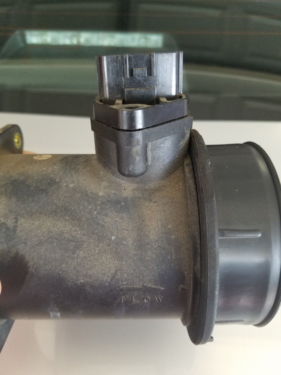

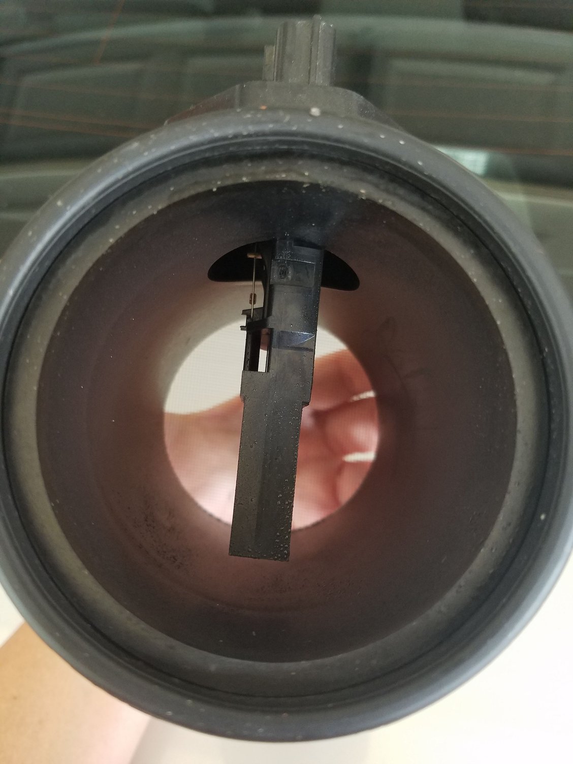

Am I missing something? Does the maf sensor actually come out of the housing?

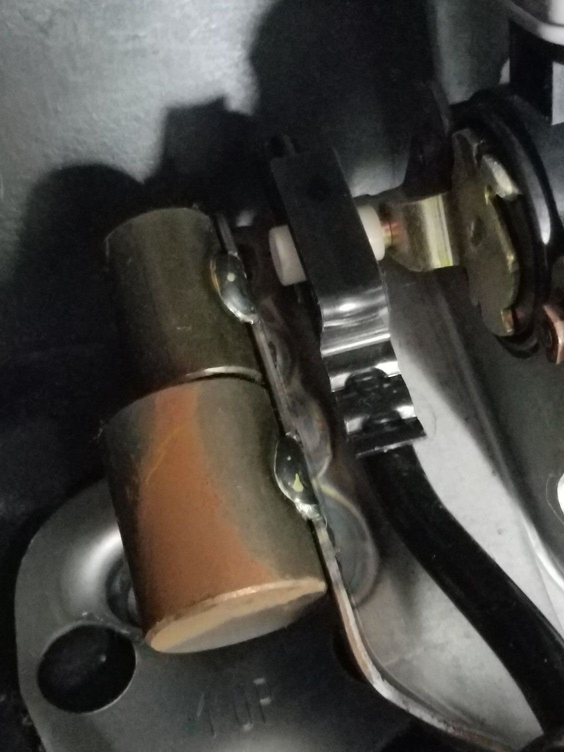

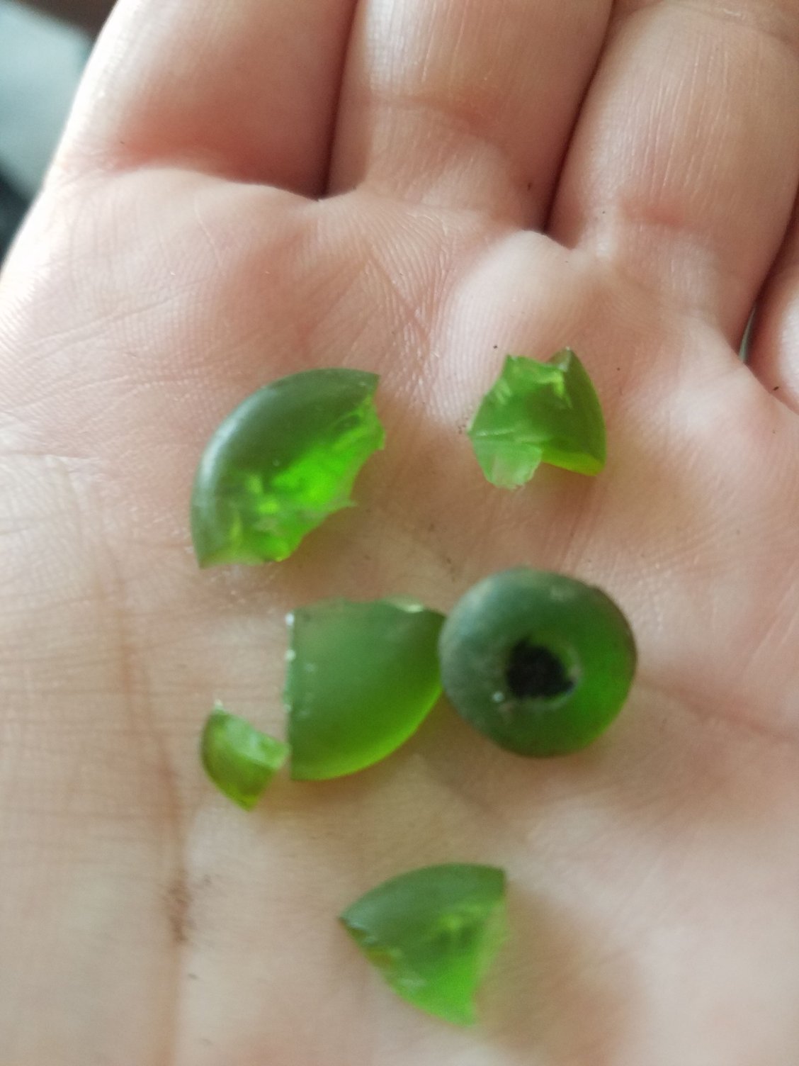

Found these little pieces on the floorboard right around the pedal area. My son couldn't tell me what they were from.

I figured it out lol. It's being cleaned as we speak
Edit- (I THINK I figured it out) Didnt know if I was supposed to pry anything

I used a small flathead and got the sensor out of the housing. I just didn't want to break anything earlier lol. I wiped all of the contacts very carefully and returned it to the housing. The screen and housing got cleaned while I had the sensor out. Once it stops raining it's *** off, I'll continue.
Those green pieces concern me. I found where nissan has "stops" for the brake pedal that look exactly like what I found. I wasn't sure if there would also be a stop like that somewhere on the accelerator.
Or if it did come off of the brake pedal and that affects the accelerator also....?

Fair enough lol, I forgot how tight that sensor can be in there if it has never come out before.
Im not familiar with the accel pedal stoppers but I had that issue with my brake pedal. The stopper broke and fell off, which left a little button not being pressed when the pedal was up - leaving my brake lights on all the time. My solution was gluing a penny where the stopper was and never worrying about it again.
Maybe its similar with the accel pedal, where theres a button on it that gets pushed in when the pedal is fully up? In any case, its there for a reason, although I personally dont know what that function is. Just tape/glue a coin where you need to and you should be good to go, if you get in there with a flashlight and feel around you should probably be able to find a little round button somewhere in there. I wouldnt bet on it but perhaps that would explain your accel pedal codes.

I did snag some pictures of the top of the accelerator assembly earlier. Not sure if that helps with anything, but it does kind of look like something goes in that hole

I pulled my ridiculous post. But I kept the one with tho most awesome Cypress Hill song.
The Kryptonite-looking crap is called a brake stopper. You have two of them. Eat it. I did. $14 each at my dealer but my parts lady loves me so she gave them to me for free.
https://www.nissanpartsdeal.com/part..._pedal,,46512M
That they were green means ****all to me but apparently they've been replaced before.
Clean the MAF, DELETE codes, send your son to engineering school, report back.
MAF has been cleaned. It's back in the car, the battery hasn't been connected yet. I'll do that in the morning after he wakes up. Im involving him in this as much as possible because no one ever taught me **** about this stuff, and I'd like him to at least know more than I do when he's my age.
About the green stopper... I'll look at the brake assembly to see if anything is missing. Maybe I'll get a picture just in case I'm not looking in the right spots.
​​​​​​I've come across a couple of videos stating that there is supposed to be a stop pad in that hole I found at the top of the accelerator....but they weren't for an 02 max. One was a 2003 max and the other was a 350z. In both videos, they installed a bolt to take the place of a stop pad. They say that without the pad, the ecu doesn't register that the pedal is there.
I could be way off track now 🤦‍♀️
I'll see if I can link the videos for you to see what I'm seeing. If I'm off base, let me know lol

Well, if thats what you managed to dig up, Id say that would explain why you are getting codes for the pedal not functioning. 2003 is literally identical in every way to 2002, so all that info still applies to you. Pretty much all car manufacturers try to use the same parts and engineering across their lineup to cut down on costs, so it wouldnt be a stretch to say that even the 350z setup is the same concept.
I think you have it figured out! Start with fixing your pedal using a bolt/coin/etc to take the place of that stopper, and see what happens. Once thats dealt with, go ahead and test your MAF voltages using NDS2.

Just got done putting a bolt in there. We have acceleration! The cel light is off (knock on wood). Will drive it a bit and see if it comes back lol. Thank you ALL for your help!
I'll post an update after a drive to let y'all know if the light comes back. I guess we'll hold off on buying the maf until we see what happens. 🤷‍♀️

Same problem caused by small plastic spacer on pedal
I had the same thing happen to me this morning on my '02 GLE. Backed out of the garage and the SES light came on and had no accelerator. Hooked up an OBDII reader and got a P0227 code that says "Throttle Position Sensor". I did some research online and started to crawl up under the dash to look at the throttle position sensor to check the electrical plug. As I started to get down into the floorboard I noticed several small green pieces of plastic in the floorboard. Turns out these pieces are the stop for the pedal at the top near the throttle position sensor. Unfortunately it doesn't seem that you can replace just this plastic piece, so I have ordered an accelerator pedal assembly that should be here tomorrow. I have included some pics of this $200 piece of plastic, where it was, and the assembly after I removed it. Joy!

You absolutely can replace just that piece. Maybe not with exactly what fell out, but its just a stopper, anything capable of doing the same function like a coin will work. Theres no reason you should be paying $200 for a new pedal when you can repair the one you have for about $0.10.

And I did after reading over some of the other posts. Found bolt with the same depth head as the plastic piece and put in in there. Works just like it should now. Thanks for the updates. :-)

Glad you got it fixed! Also, you can order the stop pad by simply googling "2002 maxima brake stop pad". There are different cars that it shows up for, but they're all the same. I believe Amazon had them for about 9$ shipped. Much easier to go with the bolt though 😊
